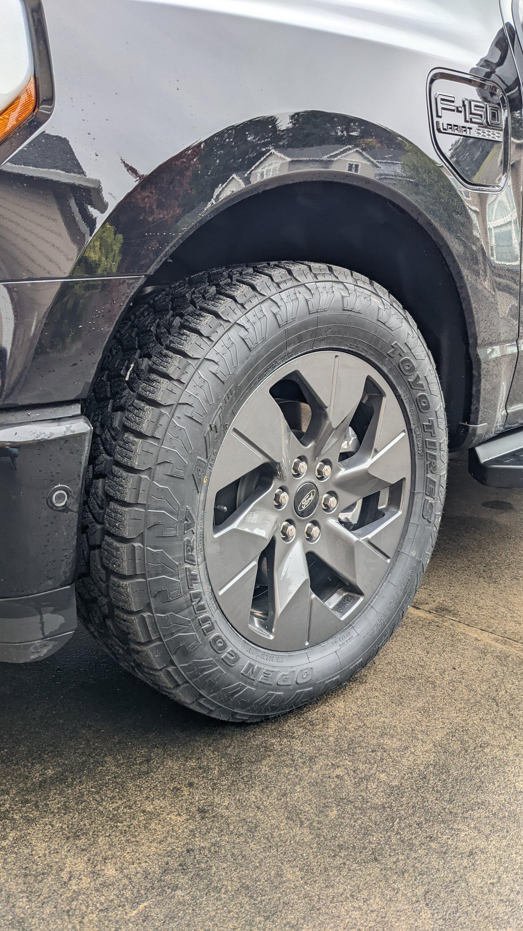

You're good. Recommended tire from Costco.

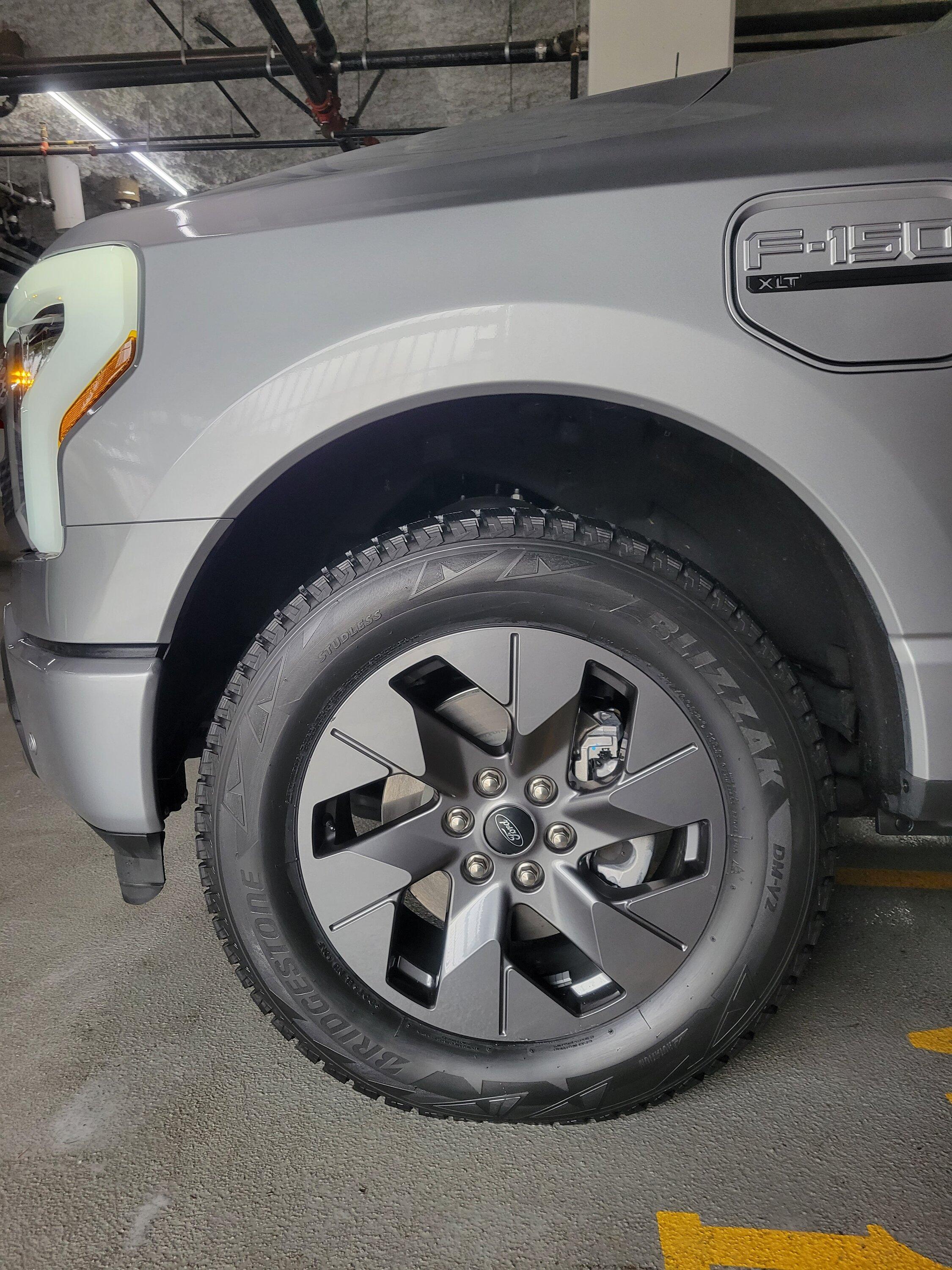

How are these doing? Is there much noticeable range impact? I'm looking to do this exact setup on a SR Lariat.

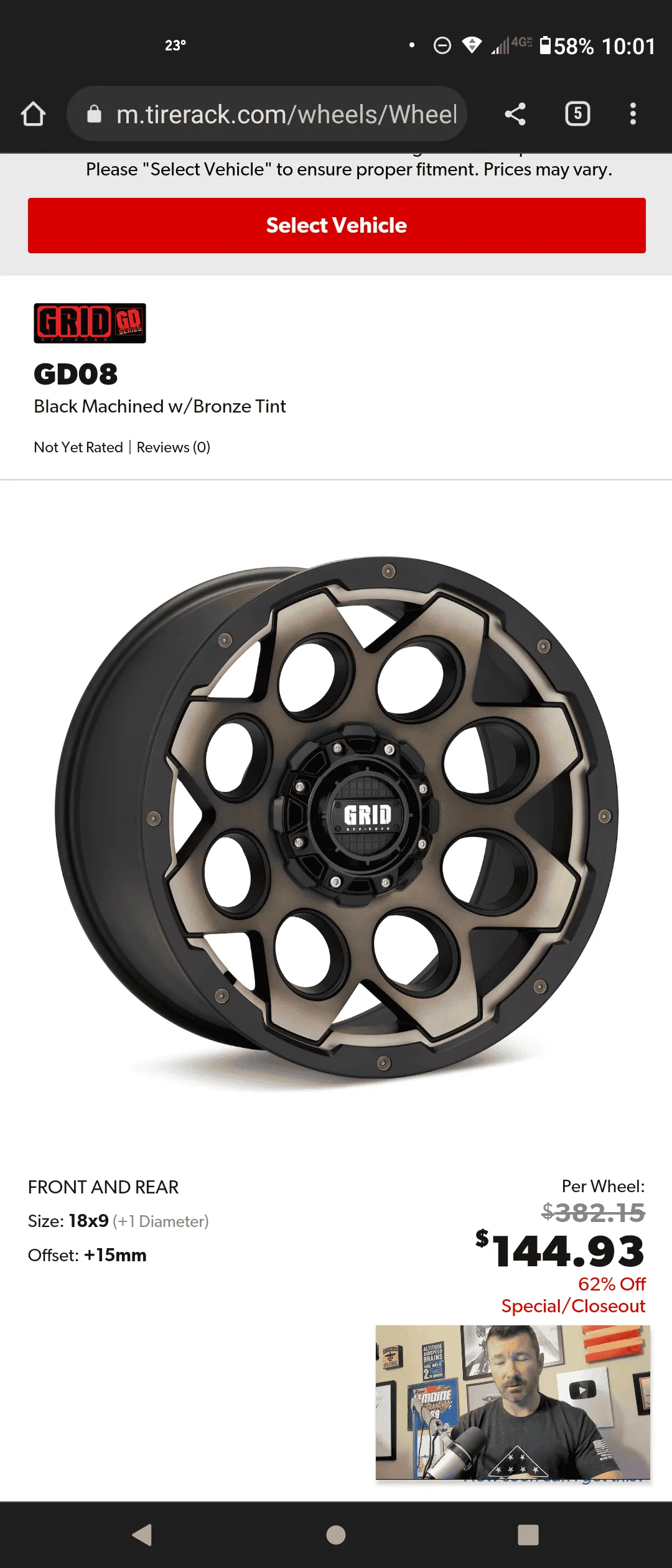

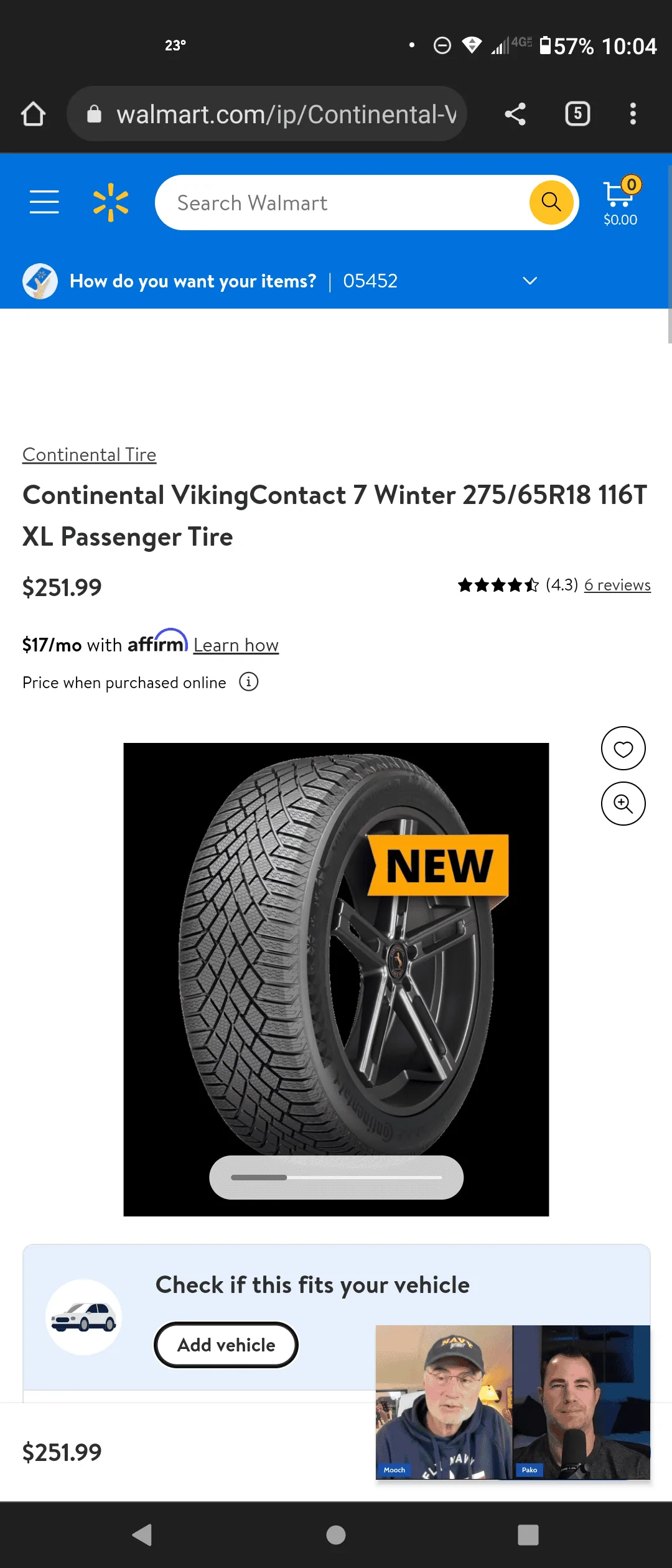

We have the hakka r3 SUV on our Volvo. Love them so far (used winter 2021 and so far 2022). I have continental viking contact 7 on grid gd08. I skipped the tpms sensors, so after about 20 minutes the light comes on. This does not bother me as I have run winter wheels on all of my cars since finishing college (no longer driving beaters). None have had tpms sensors. The tires are not noticeably louder than stock.
Ford F-150 Lightning Snow Tire Help Screenshot_20221209-220408
wheels
Ford F-150 Lightning Snow Tire Help Screenshot_20221209-220155
They have been excellent. Limited snow here but in sub 10C temperatures I haven't had any issues. Road noise is noticeable but any sounds are amplified from a truck this quiet! Seeing approx 20% range loss so far from sub 10C/50F temperatures + Blizzaks.
