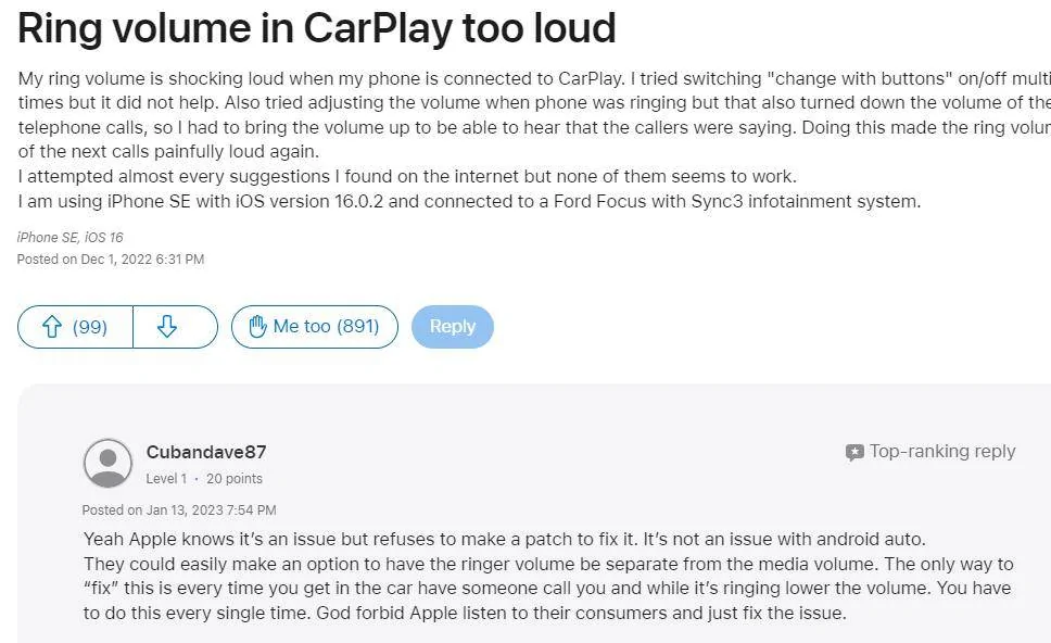

This is in an Apple thread:

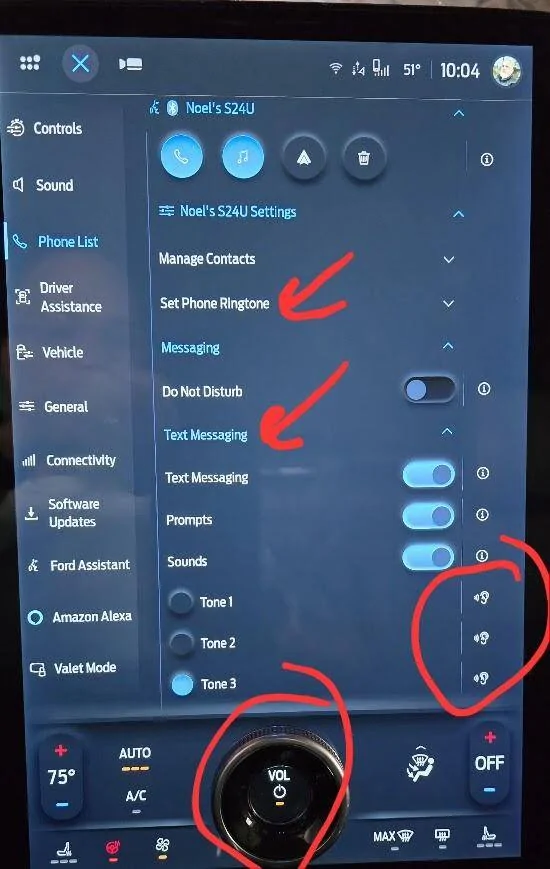

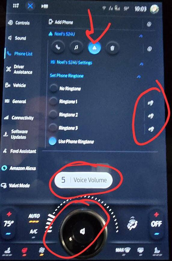

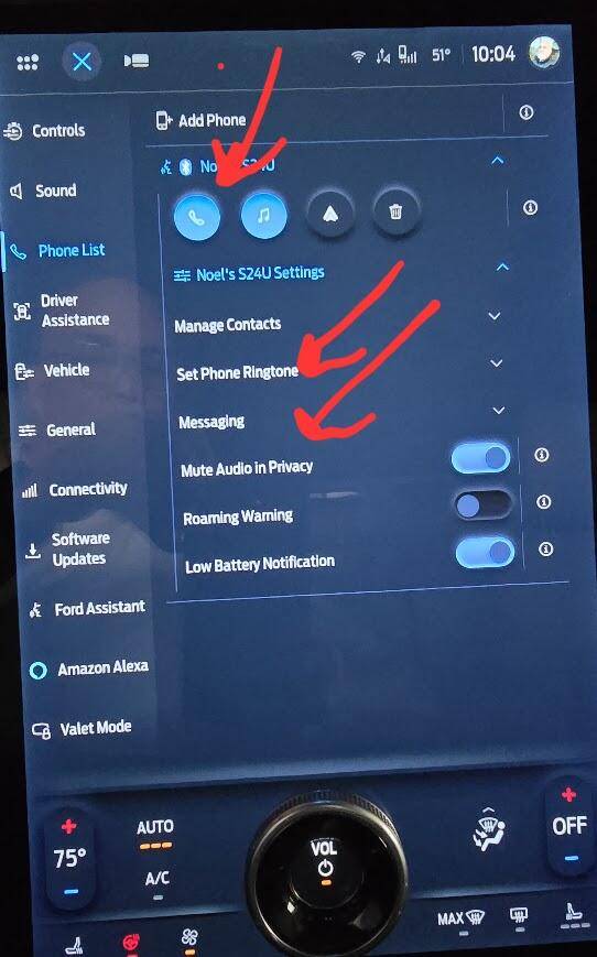

Yesterday afternoon I went back to the Lightning to play with the bluetooth modes, you can adjust the "Voice Level" of the chimes and ring tones, to do so you can demonstrate any of the various choices with the preview icon to the right of a particular selection, twist the volume dial up or down to change the level.
To make these changes:
Settings > Phone List> select your device > by default the wifi connection to carplay or android auto should be selected, choose the drop list Set Phone Ringtone for that mode then look at the list of ringtones, select the first options preview icon, it'll play persitenently for many seconds, then turn the sync volume dial down to lower the output.
Ford F-150 Lightning Speaking of CarPlay 1730038731158-oi
Change the connection method to bluetooth mode:
Select the Set Phone Ringtone, preview the tones, adjust the volume
Select Messaging, preview the tones, adjust the volume, you need to be fast with this as the preview only last a couple seconds
Ford F-150 Lightning Speaking of CarPlay 1730038442934-a5
Ford F-150 Lightning Speaking of CarPlay 1730038541513-f
I don't know if the value changes "stick" past the current drive cycle, I'll look at the changes Monday.

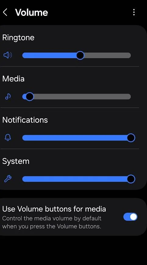

I also looked at my android device, I can go deeper into the audio controls, Ringtone, Media, Notifications & System. Look for this in your iOS device, maybe it will help with carplay sound carried to the truck?
