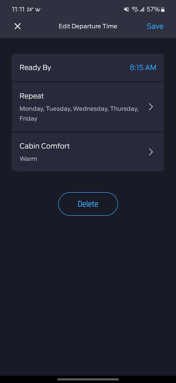

1. If unplugged, there is no difference between a departure time and manually hitting climate in the app. Both activate cabin climate.
If the truck is unplugged and a departure time is set nothing will happen unless "Prepare Cabin Off Plug" is selected in the Departure Times menu. If it's selected, the HVAC will condition the cabin based on the outside temperature.
2. If plugged in, a departure time prepares the battery using shore power, which improves range, while hitting climate in the app does not impact battery.
This is more questions than you realize. I'll try to break it down.
Ford F-150 Lightning starting remotely vs. preparing the cabin temp remotely 1000015913
My Departure Times are set up as illustrated in the screenshot above. Additionally, "Prepare Cabin Off Plug" is selected off.
At 8:15 on weekdays if my truck is plugged in the battery is conditioned (warmed) and the cabin is warm. If it's not plugged in, nothing happens.
At any time if I select Climate On in the app the HVAC will adjust cabin temperature to the desired settings. Selecting Climate On doesn't do anything for battery conditioning.
