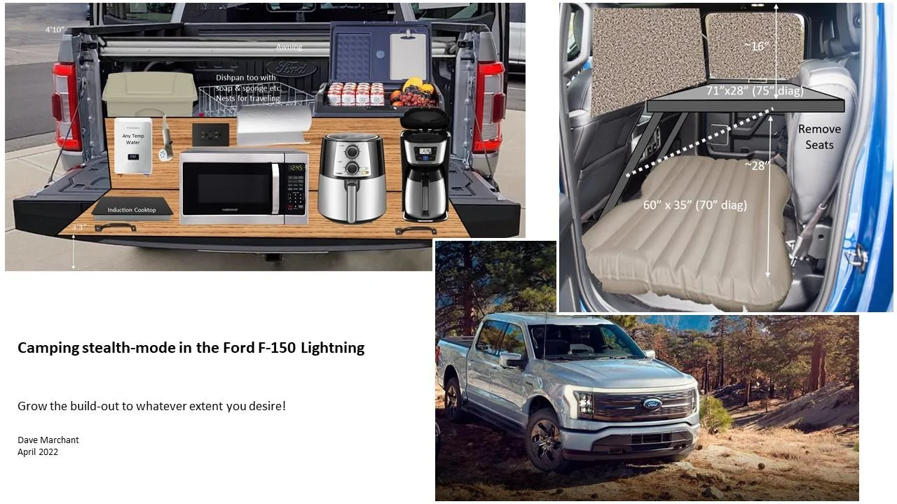

It started with an easy and obvious idea: take advantage of Camp Mode and sleep on the floor - in airconditioned comfort. Sleeping in the car has always been so uncomfortable!
As you'll see from the attached, that idea grew with all the electrification available. All items shown are linked to their Amazon page. Truck dimensions are guestimates since I don't have a F-150 SuperCrew, and did not feel like finding one to measure. I think this will work for anyone under 6'....your mileage may vary!
Any additional ideas to improve (or gotchas I have overlooked), are certainly welcome! It will be awhile until I get my Lightning...but I'm excited! Full build-out as shown is about $5,000.

How far back do the non-flat seats go? I wonder if a cover or platform of some type could be fashioned to level them out so they could be used as beds. This would let you sleep two and eliminate the need to remove the rear seats. The Model S hatch is not flat, but I built a platform out of insulation and hardboard that makes it flat. I can then put a foam air mattress on top (or just a few sleeping bags). I agree that it's a shame the lie-flat seats weren't available as a line item option or I would have sprung for them on my Lariat build.
A tent for the back with a window that seals to the truck's rear window could make for some semi-conditioned space, perhaps with a fan to force conditioned air into the tent from the cabin.
Great idea! I'd like to be able to pitch a tent on top of a properly strengthened tonneau cover with a tent design that attaches to the bed rails in some form.

I really like that idea of a mattress that has a section to fill the footwells. I guess there's a lot of people who camp in the back seat of trucks and SUVs
Better yet, F150 has a flat floor in the back seat area (at least in the current ICE version), so all you need is a sorta short and narrow mattress or air mattress or foam pad. I’m definitely going to do that.
