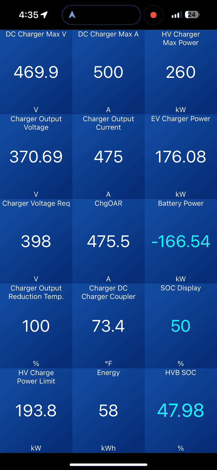

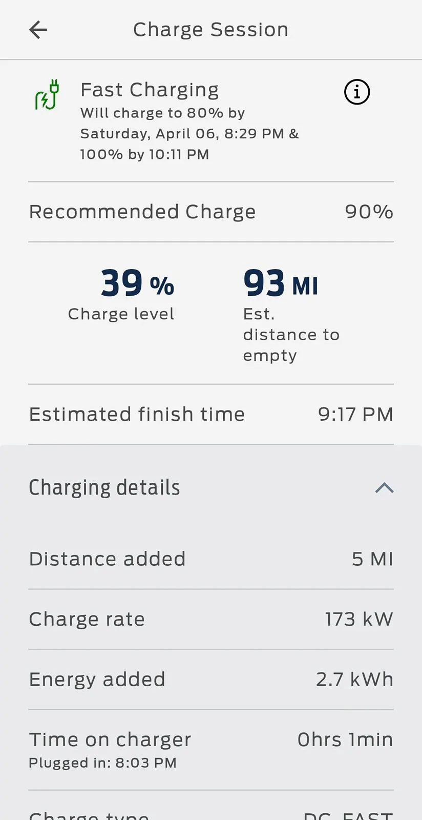

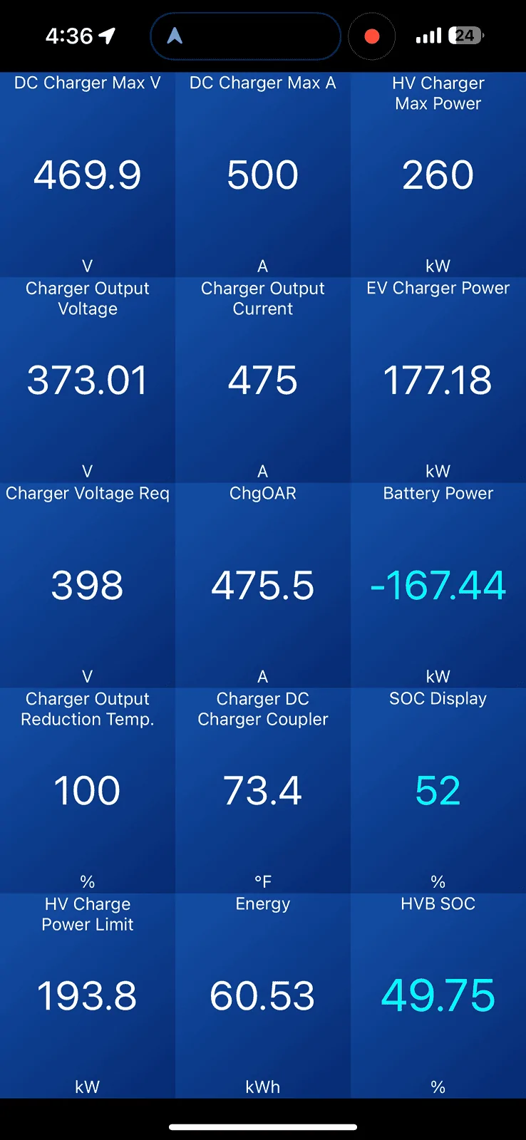

Seems like Kyle from Out of Spec addressed this and then went quiet. Do the Supercharger limit Ford to 450 amps. Why is peak kW on 161 or so and almost 180 on EA. EA must give the full 500 amps.
