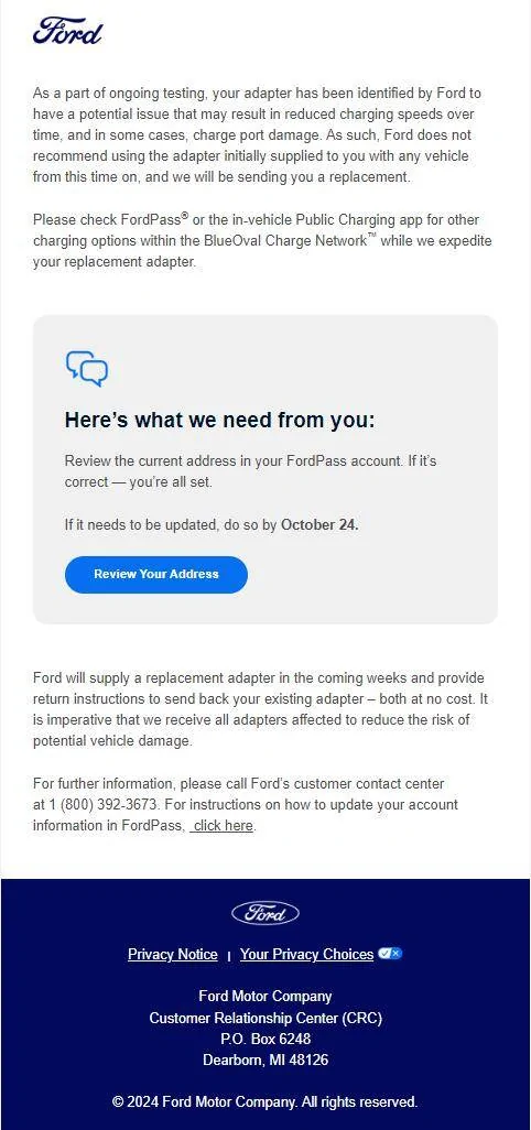

Today I received the following email:
Ford F-150 Lightning Tesla NACS Adapter Recall / Replacement Notice (10/24/24) Captur
I went back and checked my past emails, and this one matched format close enough (although the phone number "for further information" was different) that I clicked the embedded links within the email. It took me to a website that auto populated with my ford credentials, and had my address, so I am guessing this is legit.
So my Tesla fast charge adapter shouldn't be used, and might have damaged my vehicle. ? Just for the record, the ship date of my Fast Charging Adapter was June 13 of 2024.
Just want others to know if they received something similar.

So the #1 question now is, at what point did they start sending good adapters OR have any of them sent to this point been good. It's possible they've all been bad and they are just slow to send out the notifications.

From Mach-E VLOG on the Mach-E forum:
"I just got verification from Ford that it was one batch of adapters that were affected not all of them. If you got the email, make sure you update your address as it says in the email. If your address is the same, you don't need to do anything. The replacement adapters should start shipping by the end of the month."

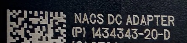

My adapter has the following part number and serial number.
(P) 1434343-00-D
(S) GF22408100000TX
No recall email here.
The adapter I received last week (10/11/2024) has the following Part# printed on it
(P) 1434343-20-D
