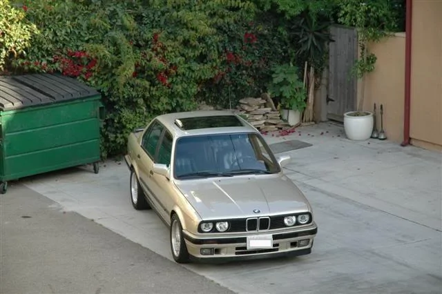

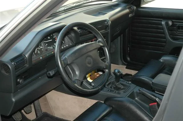

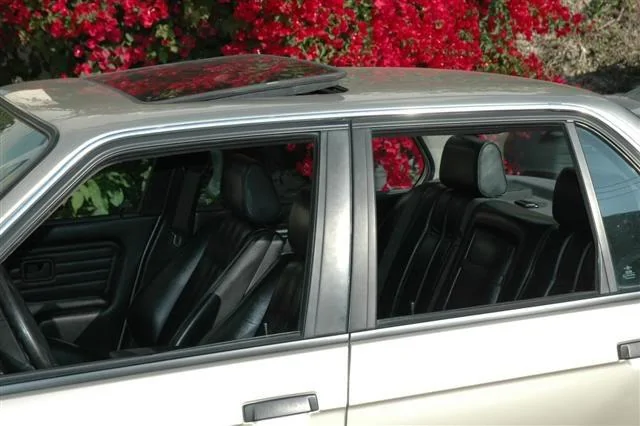

It's not a new thing--those BMW seats are so stiff mainly because of the urethane coating they use for UV protection. I used to restore E30s and when we redid seats we'd have to sand that coating off first. The issue was they do (or did, rather) use top grain leather and it would shrink over the decades but couldn't be rejuvenated due to the coating. So we'd either have to try and soak the oils through the lacing, do weird things like cover them with garbage bags in the sun, or sanding. But if you took the time to do it right...

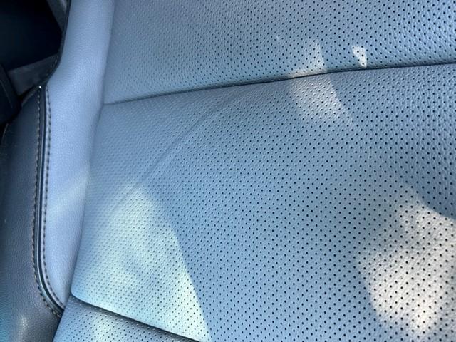

In any case, those pictures of loosening leather panels is unacceptable. They will get worse and eventually tear/crease and become unrepairable. Personally I would already consider them unrepairable. I did not have high hopes these seats would be any great quality (and also preferred the cloth for that reason--but now I have my doubts the cloth would wear much better) and intended to reupholster them professionally with the best leather available.
I strongly suggest those of who experiencing seat panel puffing, pinching, twisting, etc. file warranty claims ASAP. What you don't want to do is wait 10K+ miles and have them deem it "wear and tear."

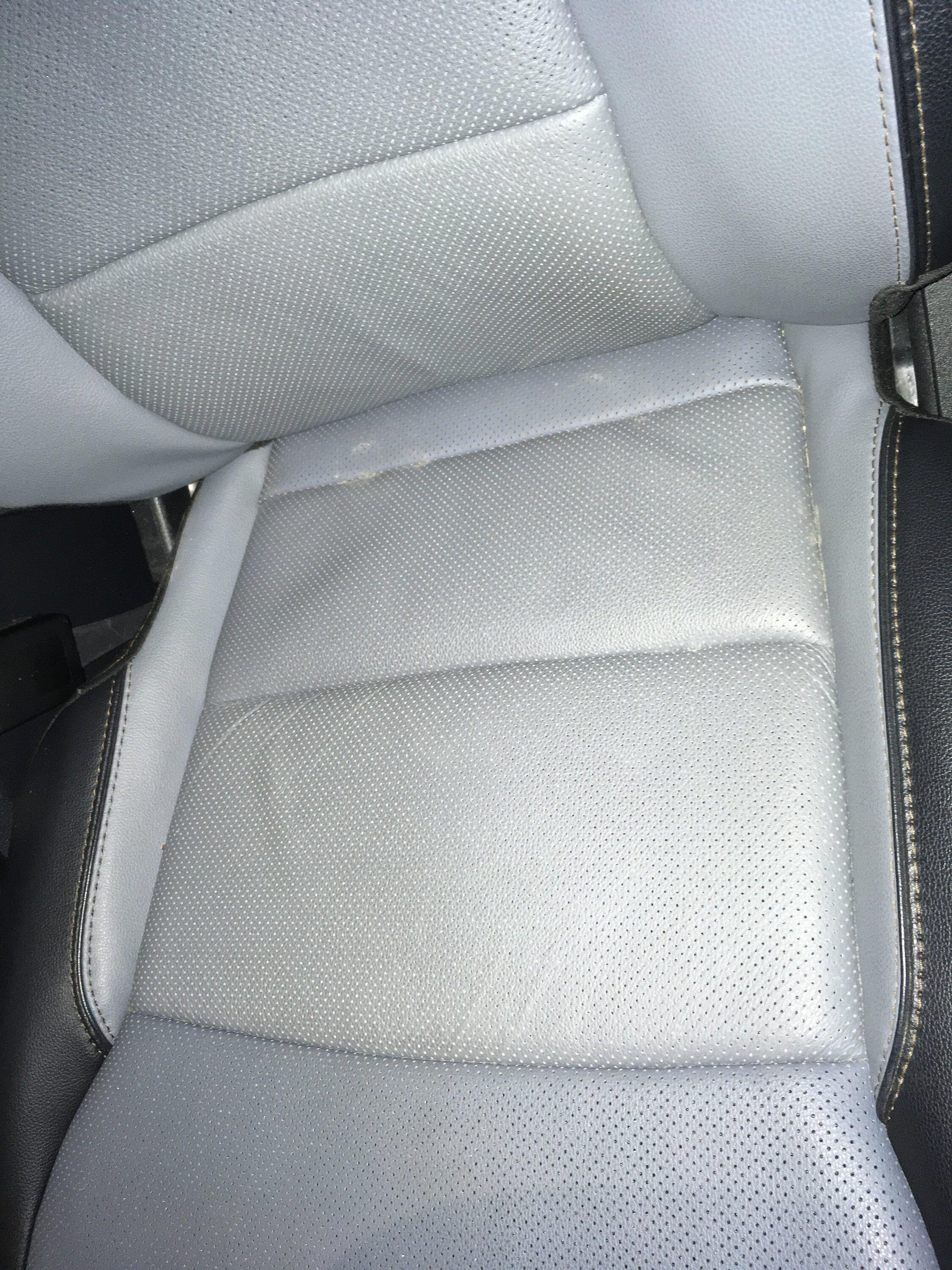

Making me a little nervous...hadn't thought to take a look until this thread...sure enough, it is creasing up on me, only 1k miles

Less than 2000 miles and here is mine. I noticed this in the first week. There is also a bit of fraying/wear around some of the holes in the middle of the seat that doesn’t show well on the photo.
