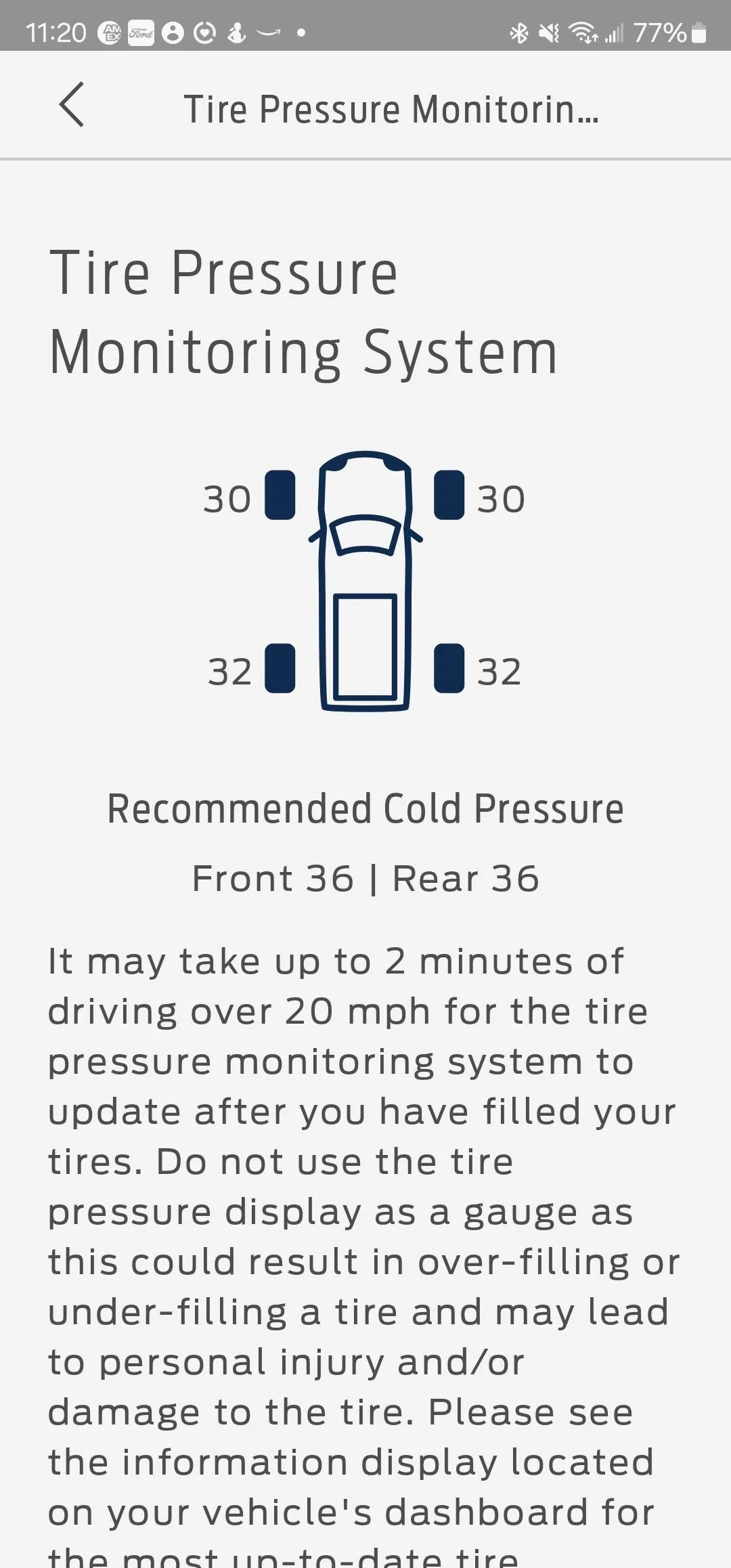

I checked my Fordpass app and it says that my tires are 6 lbs low. It is 24 degrees F right now. Should I air them up to 36, even though it's below freezing temperature? I have the factory installed Hancook AT tires on there and I don't want to over or under inflate them. Thanks in advance.
I see no harm, though when the temp's normalize for your area the cold pressure may go above spec, but not anything to worry about, my AS tires are low right now too, s/b 46 but showing 39

I aired them up to 36. She even seems to ride a little smoother. I may even try the Chalk Test above when it warms up here next week.
