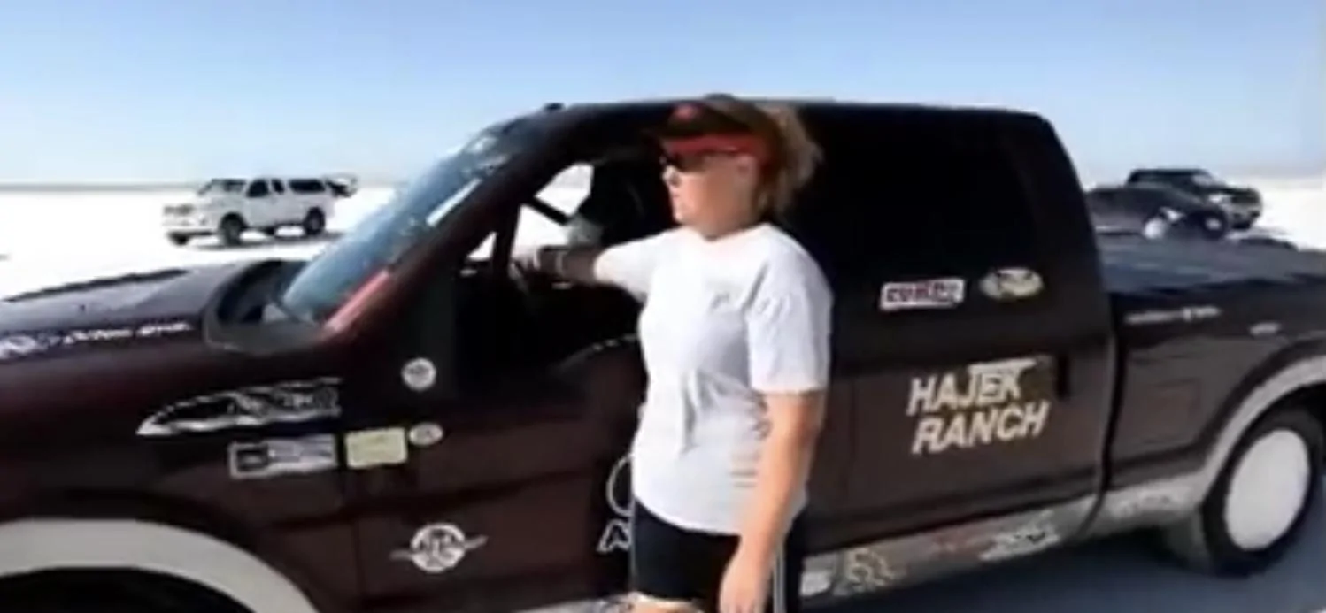

I went and google-searched pickup truck class entries in the various Bonneville Salt Flats classes for land speed competition - and while my search wasn’t exhaustive, I didn’t find a single example without a tonneau (and they aren’t adding that weight for storage)
that research includes finding the F-250 Super Duty that in 2011 broke both the top speed record for a B Production Diesel Truck as well as for a B20 bio-diesel truck too…… over 171mph btw
that’s a hard tonneau back there
I would think these salt flat racers have thought through this and have some data to support their aero-choices
would be cool for an experienced salt flat truck class racer to come through and provide insight

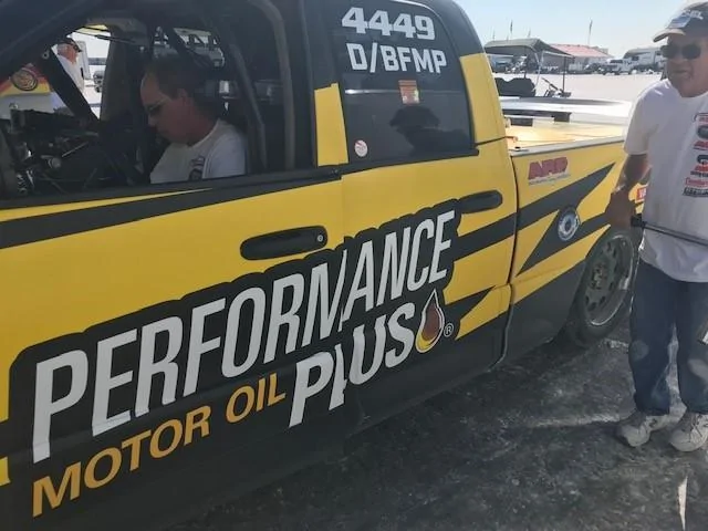

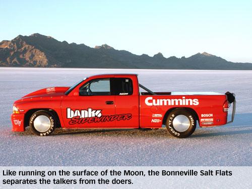

But as an aside since there seemed some miscommunication, this consistency includes trucks from the last few years (and for modified stock class, even our favorite 1/2 ton body styles). And, I’d think the issue of “weight” is more likely to be accomplished instead with further aero dealing instead with downforce generation. Both of which (modern 1/2 tons with downforce aero) exemplified below in “the world’s fastest pickup” (hit 254mph in 2021 season)

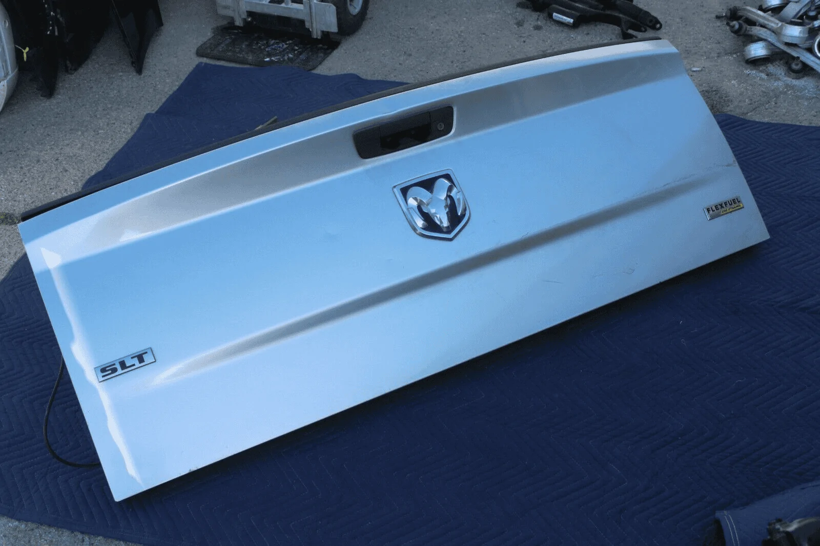

The Jesel Team claimed that victory in a ~16 year old body design ('05 RAM).
Ford F-150 Lightning Tonneau Efficiency Data Collection 1661806467839

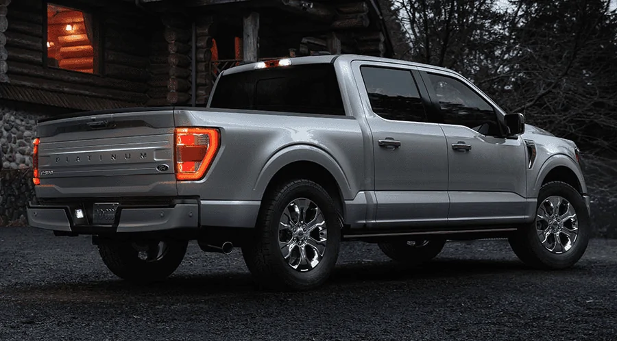

One difference between those older designs and a more modern one is that our tailgates were straight whereas the newer ones are shaped to behave more like a spoiler:
Ford F-150 Lightning Tonneau Efficiency Data Collection 1661808430875
The ICE F150 (and Lightning) also follow this design consideration:
Ford F-150 Lightning Tonneau Efficiency Data Collection 1661806640852
Also note the lack of any gap between the body and bed compared to the Dodge.
A tonneau cover may be superfluous or even detrimental on a modern design.

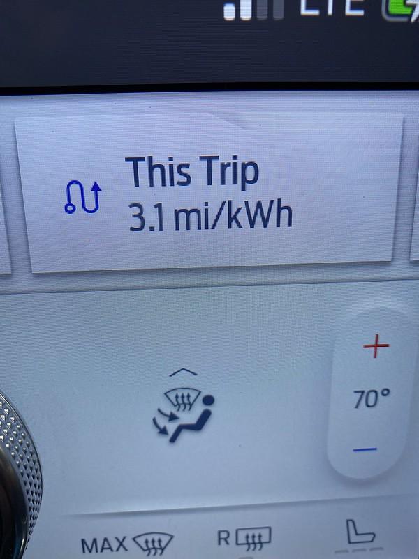

My truck got 3.1 mi/kwh on the way back from the dealer after getting my tonneau! It wasn't installed, of course. The mere *presence* of the tonneau improved its efficiency! :LOL:
Ford F-150 Lightning Tonneau Efficiency Data Collection 52323643924_0fa378ea09_c
Ford F-150 Lightning Tonneau Efficiency Data Collection 52323643584_3503e49840_c
