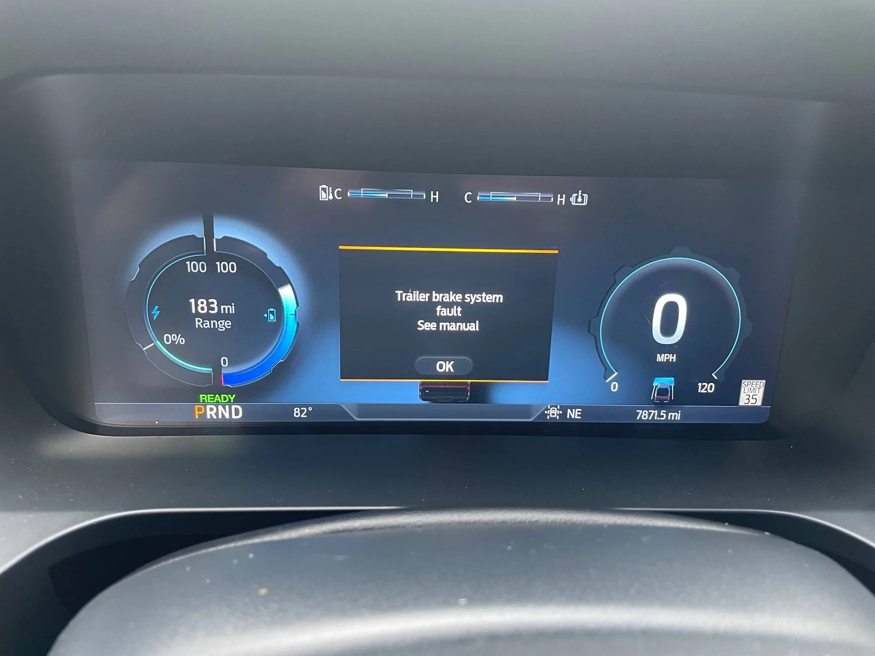

Mobile repair folks came by to do some sort of module update per some recall. I had to leave while they finished. When I got back I started the truck up and now have this same fault. As well my left front TPMS is “—-“ while all the other work. Maybe should have declined the service update. Because now I have this issue when before I had none. And of course it is a Friday at 5pm.
Ford F-150 Lightning Trailer Brake System Fault IMG_9795
12,050
12,638
Drive it around the block, that should get all the TPMS sensors read in.
Hopefully the trailer error is also an artifact of the update, see what happens in a day.
