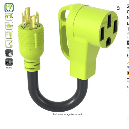

I have not done anything yet, but after listening and consuming the Information from other regarding Ground Pin removal to use a whole panel interlock and generator inlet...
For my scenario with an existing 50A inlet and interlock, I was thinking if I did need to do this (for whatever reason could not or did not want to use my 12,000 watt portable generator) was to not to modify my 50amp generator inlet, nor my expensive 30' 50amp generator cord, but to simply remove the ground from the inexpensive 50amp to 30amp adapter I have. This adapter could easily then be labeled with a "warning" sticker. GROUND PIN REMOVED - ONLY FOR USE WITH FORD PRO POWER OUTLET.
Very little work involved, very little cost to replace or throw away if no longer needed.
EDIT - Posted pic of wrong adapter originally
