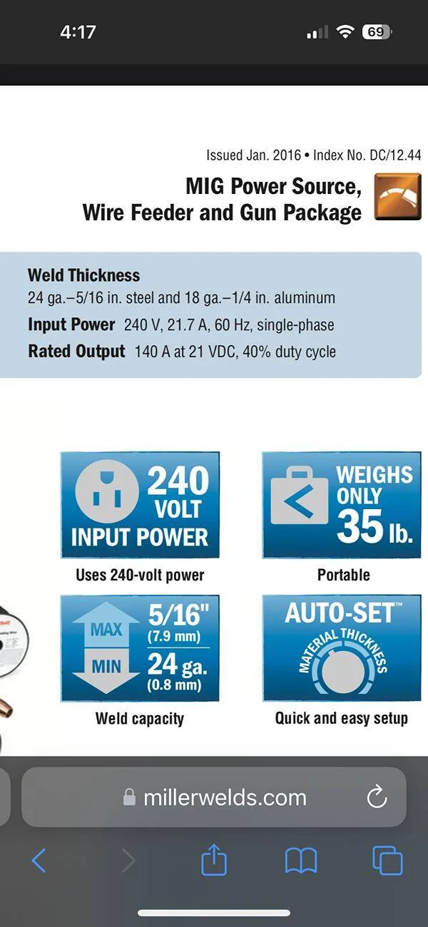

Did this welder work without tripping the propower?
I’ve had my truck a week, but I haven’t had the need to test it with the Miller 190.
Pcontrer1
Paul
Jun 10, 2023
Pleasanton, CA
2023 Ford Lighting Pro
General Contractor
Thanks for the feedback. The only reason I ask is I’m looking to purchase a MillerMatic 211 to use off my Lightnings 30 amp plug. I’ve been using an inexpensive stick welder but it keeps tripping the pro power, was hoping you had better results since your welder has similar specs to the one I’m looking to purchase.
