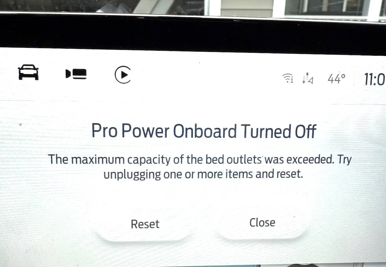

I tried my small log splitter again in both the frunk and the bed. The attached picture shows the result. This does not look like a GFCI issue does it? I was thinking of trying the 240 volt outlet with an adapter, but I have read in other threads that the 120v outlets can actually provide up to 30 amps, so I am not sure this would make a difference.
I am very disappointed that the Pro Power on board cannot run this simple device. It runs fine on a home 15 amp outlet.

I think it's hard to understand and figure out these issues, but it's also fair to assume that the ProPower is very sensitive to over-amperage, since it is electronically driven, and not 'heat' sensitive, like your home's regular outlet. Your home outlet some built-in leeway to not trip immediately because of a spike in amperage, etc., but only due to CONSISTENT over-amperage.
Try some other smaller devices or appliances from your ProPower outlet. You may find that they work just fine.

You are spiking above 30 amps on start-up, the truck has a software side breaker where a conventional manual breaker allows for this surge before tripping- the truck does not.
Turn on your Pro Power screen and watch the power spike while your buddy runs the welder. You should see it ramp up and trip on the screen.

Omg some of y'all are making this way to complicated. The screen literally says it tripped off due to overload. The GFCI has nothing to do with that. If it tripped due to ground fault, it would say that.
This is very simple. The locked rotor inrush current of the log splitter's electric hydraulic pump motor is overloading the circuit exceeding 30 amps. The end. Same thing happens when trying to start an air conditioning compressor with a heavy inrush current.
There is no easy or inexpensive way to mitigate this effect. A soft start unit used mainly for air conditioning compressors might work on it, but they're not really designed for that purpose so YMMV. Also, that would cost more than the log splitter didn't begin with. Using an adapter to split the 240v outlet will not help either. It's the same circuit as the 120v outlets.
The reason it works fine on house outlets is because the circuit breakers in your panel are far less sensitive and far more forgiving. They don't usually trip on inrush current, and require a more sustained overload condition to trip. The electronic overload protection on the F150 Pro Power is instant and unforgiving.
Bottom line, your electric log splitter is not going to work on the lightning's pro power as designed. Probably should have gotten a gas splitter.
