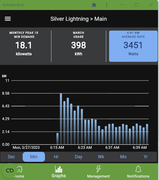

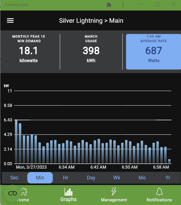

This morning, departure start up, with 15 minute buffer to test that it's working and if the heated steering wheel is resolved, (NOT) as I pulled the plug on the truck at [07:00] 15 minutes after the "Your truck is preconditioned" notification arrived a 0645 request time.
Truck battery well conditioned and cabin warm, wheel cold but the indicator light was on. 29 degrees this morning so battery conditioning started at 0615 with energy to warm battery and cabin at 2.85 kWh

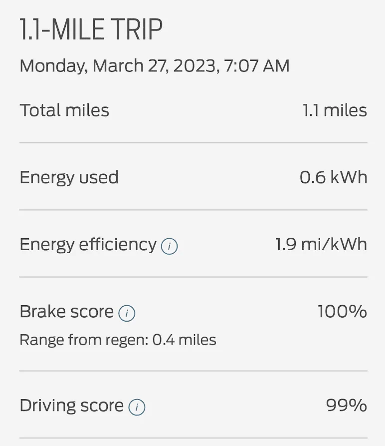

Started the truck, and trip log cleared, I also cleared Log-1 to record the days totals
Drove to the grocery store, 1.1 miles shut down the truck with foot on brake, this trip log generated a report.
