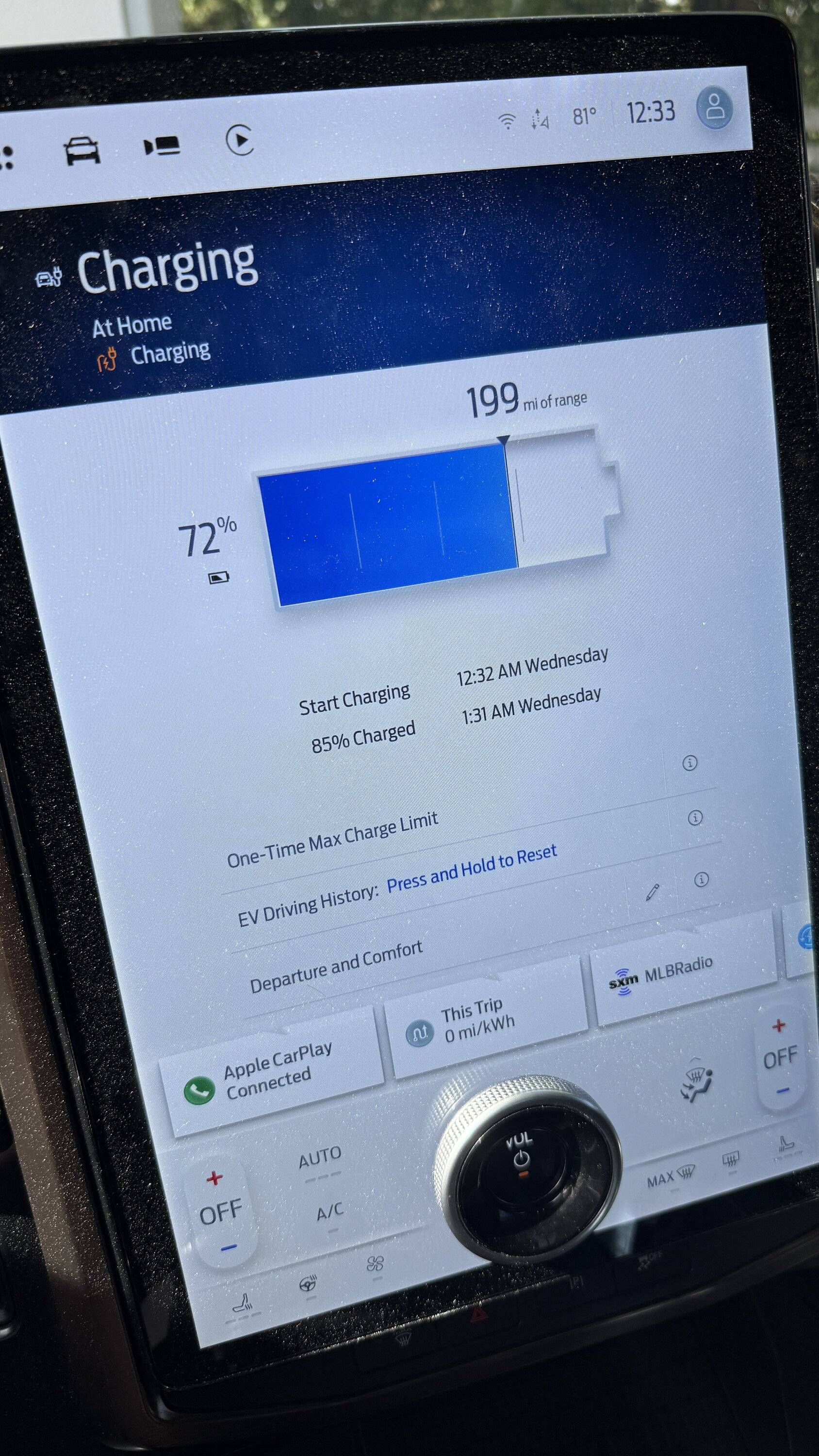

truck starts charging even when time set.

And I can’t set a new location because I only charge at one. Should I delete and restart the process?

Otherwise, the GPS location of truck and your default / home / named location charging scheme aren't matching.
Delete & recreate it is a common solution, do it in the sync screen while unplugged.
You may need to drive around the block to orientate the GPS.
Plug in create fresh scheme.
During the new scheme creation accept the suggested GPS coordinates if that is what is identified.
While creating new scheme include time frames if that's your intention., also include a weekend time frame.
EDIT:
On second thought, I see your 85% limiter, so location is recognized, but you do not have a properly specified time constraint.

Honestly I think my phone has a mind of its own. Or I’m going crazy.
Why does it say you're charging at 12:30 AM but it looks like it's sunny out? Is your clock wrong?
Actually I was hoping you just traded up to a new MY2025 Lightning, but seems you still drive a 2023
Hahhhh, I bet AM/PM flipped, a great reason to stay on military time, if it would stay set.......

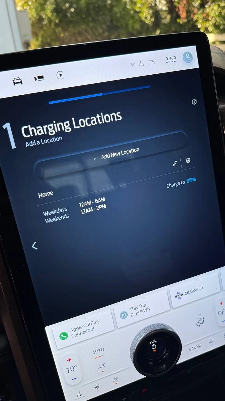

Settings are good but it still charges when plugged in.

Is the trucks actual clock time set in error as @Pioneer74 suggested, AM set instead of PM?
4,176
5,538
I’ve heard of folks having issues when setting to exactly 12:00. You might try changing the start time to just after 12.
I’ll double check the clock this morning.
The truck didn’t charge overnight. And I have zero control over it with the app. Can’t charge, turn on or even unlock

Perhaps the one-time charge option somehow is turned on?

Y’all were right. Clock was flipped.
I still can't initiate the charge or adjust percentage in the app. i'm in beta though
