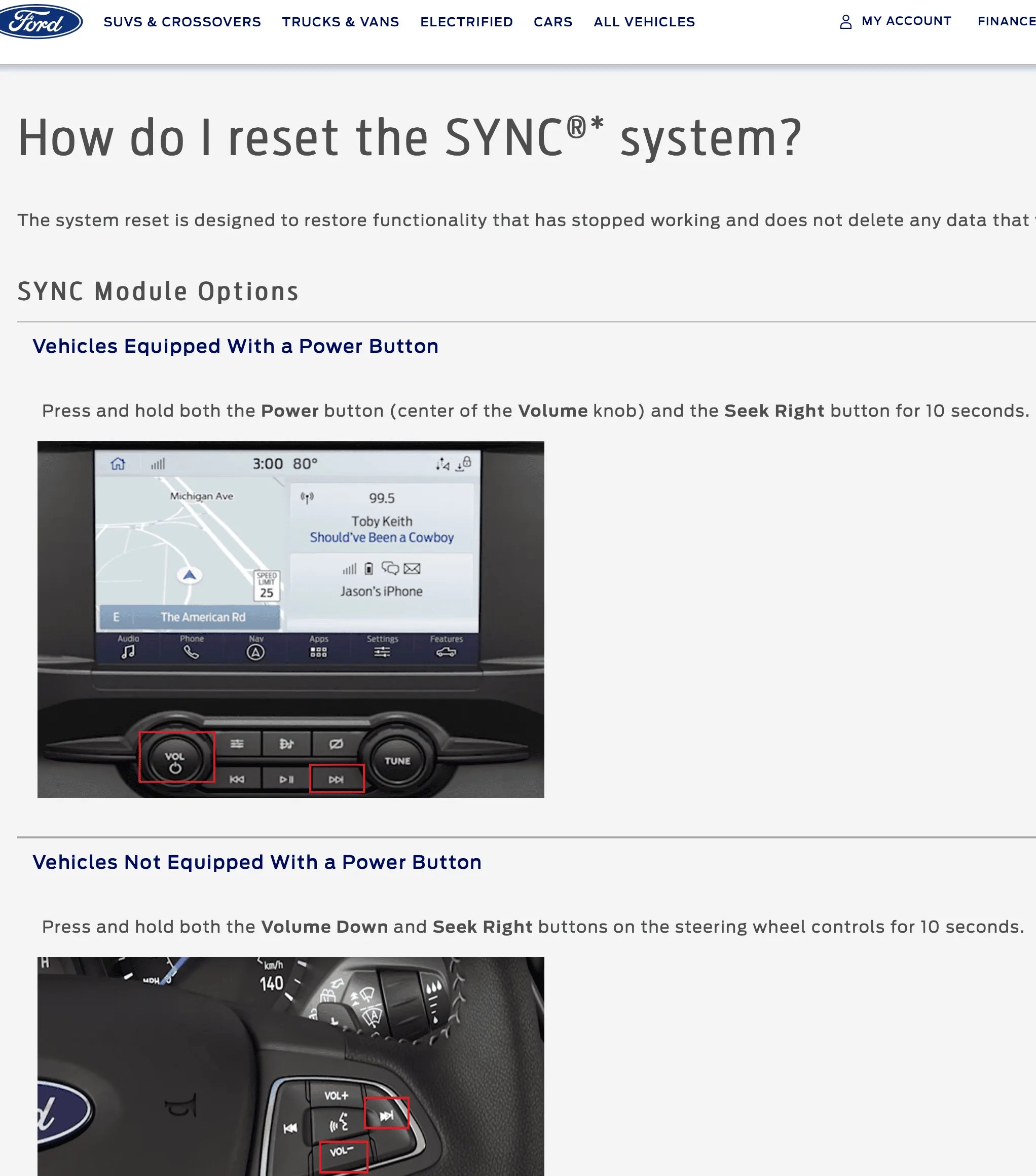

I held down the power button (the volume dial) on the dashboard, and held down the Skip Right on the dashboard (not the steering wheel) and after about 10 seconds it rebooted. First it went blank and then the logo started animating, and now FordPass is working again.
For the record, mine is the 12 inch screen.

page 516 for 12" screen:
REBOOTING THE CENTER DISPLAY You can reboot the center display using the controls on the steering wheel. 1. Simultaneously press and hold the seek forward and audio system power button for 10 seconds
Funny, manual says use steering wheel control buttons, yet IOTD.com found the center panel audio system buttons worked.
Did anyone with a 12" center screen use the steering far left "Volume down" and the far right "Seek Forward", like the 15" center screen instructions, and get a reset?

You also have a 2022 right? I thought these connectivity problems were only with the 2023?
Definitely a 22, and I definitely lost connection to FordPass until I did the reset.
Meanwhile... the next morning I got the "We need your help installing an update" in the App, which I haven't seen in weeks, which is probably when FordPass stopped working.
