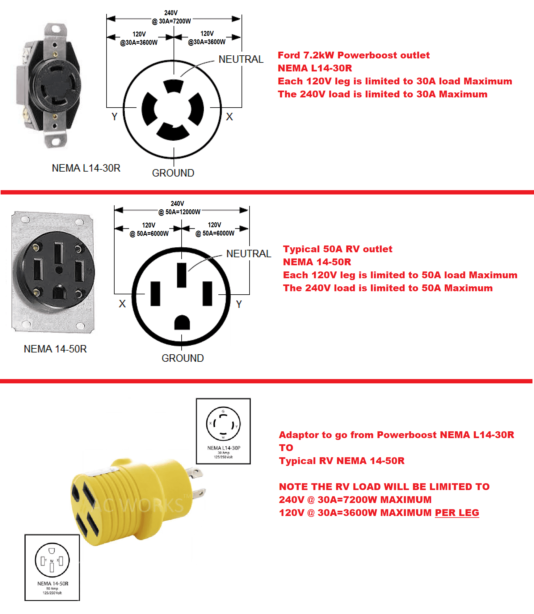

If you have an RV with the typical 50A RV shore-power cord/plug, you can connect that to your 7.2kW Powerboost using this single simple adaptor.
BUT there's nothing you can do to increase the total load capacity of the 7.2kW Powerboost. Therefore, when using such an adaptor, you will be limited to 30A load (3600W) on each 120V leg of the electrical system in the RV (and/or 30A load (7200W) on the 240v circuit IF your RV actually has any 240V appliances).
IF you exceed an actual load of 30A on either 120V leg in your RV, or a total of 7200W between all 120V legs and any 240V circuit, the protective devices on the Powerboost should 'trip' to protect the vehicle systems.
The distribution of loads in your RV between the 120V legs is determined by the wiring system in each RV and may vary. It may be possible that one could 'trip' one leg of 120V power but not the other if only one leg is overloaded (exceeds the 30A/3600W Maximum).
You can butcher your Powerboost to try and replace your OE NEMA L14-30R outlet with a NEMA 15-50R outlet; you can try all sorts of shenanigans with 'wye' cords plugged into multiples of the Powerboost outlets; but nothing will allow it to deliver more than it's rated 30A/7.2kW Maximum load (120V plus 240V aggregate); no matter what, you will have to manage your actual RV load demands to stay within those limits.

OP's request might be confusing .
TLDR - Math: 7200Watts equals 240Volts x 30Amps OR 2 legs of 120Volt x 30Amp
1. Most RV's are 30A/120V
2. Some RVs (usually those with dual A/C) are still 120V, but have two Circuits (legs) in the Trailer wiring. If you look at the breakers on those legs, it will still usually be 30A rating on each leg. But could be 50A.
3. Some large motorhomes (those with Washer/Dryer connections) do support 240V
4. PB output is total of 7.2KW which is EITHER 30A/240V or 2 times 30A/120V (i.e. 2 legs).
5. If you are driving a 120V load you can ONLY get 30A (but you can drive 2 different 120V loads, each at 30A).
6. You can get a cord/dog bone that will split the 4 pins of the PB connector into TWO 3 pin 120V connectors, and then drive 2 separate 120V loads up to 30A each (like in the video)
7. Or you can get a cord/dog bone that will take the 4 pins of the PB and deliver it to a "50A" dual circuit RV, still 120V (and give you up to 30A on each circuit).
8. You can NOT get 60A/120V delivered to 1 circuit directly from the PB.

In the specific case of the 7.2kW Powerboost system, connecting two 120v 30A AC circuits in series, in an attempt to yield one 120V@60A AC circuit, is fraught with great risk, IMO.
Not only phase issues but many inverters (the Powerboost uses an inverter to yield AC from its DC battery bank) are decidedly not designed to accommodate such an arrangement.
IF inclined to boldly experiment in such directions, I suggest great care be taken lest one 'release the magic smoke' in their Powerboost, which could happen in an instant, very likely be a shockingly expensive outcome, and certainly would not covered by any warranty.
Ask yourself: "Are you really qualified to understand the systems involved and are you feeling really lucky?"
In my previous post I provided a link for a single adaptor to plug an RV 50A shore-power cord into the Powerboost outlet (but limited to 30A/7200W load); if you have a typical 30A RV shore-power cord, here's the adaptor you need, and this will safely provide the full 30A load capacity your RV demands from the 7.2kW Powerbost.
