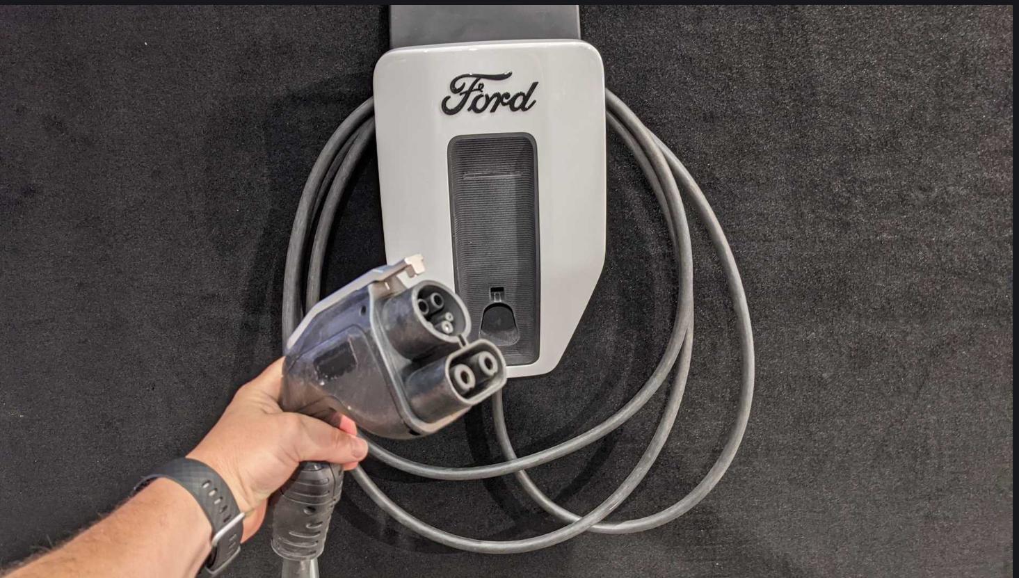

My Ford Charge Station Pro is showing up next week and I'm trying to find out if I can use it with other EVs. I have a Wrangler 4xe that takes a J1772 plug, but it doesn't have the CCS connector at the bottom. Is there any way to use the FCSP to charge it, or other EVs?

Only EVs with CCS (CCS1) ports. No Leaf, no Wrangler 4xe it sounds like.
Most PHEVs do not have the CCS ports so that means the Ford unit is a no go with these.

The car will only ask for as much power as it can use. Our xc90t8 pulls 15 or 16 amp from a 30 amp EVSE (when it is warm. If the outside temp is in the 20s or colder and the battery is also cold it will often only pull 6 or 7 amp.) A short extension should work if you notch the female end to mate with the male end of the fcsp. The DC pins will never be energized when plugged into the extension.
