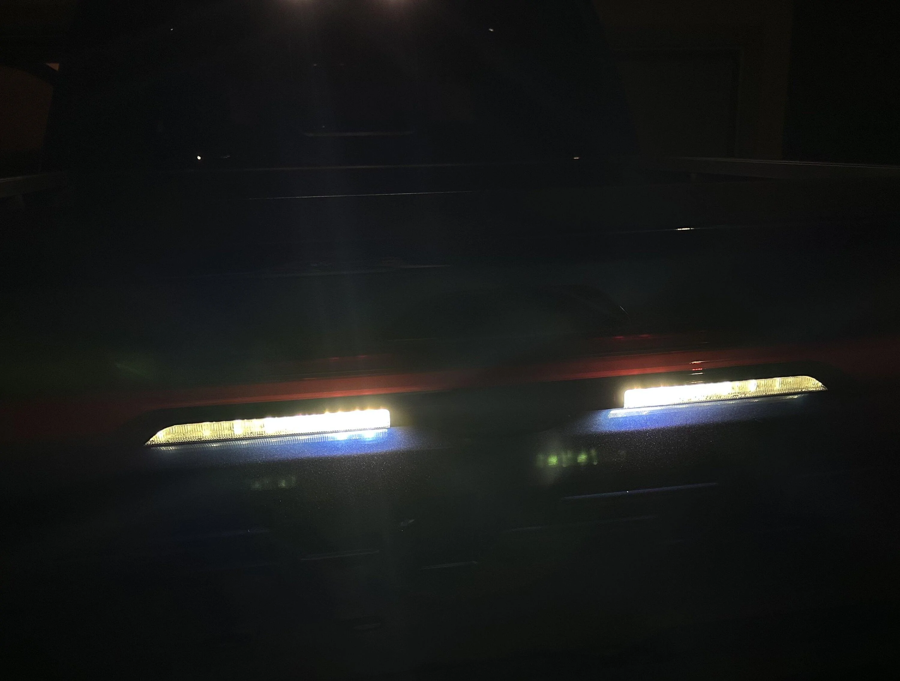

Got water in mine too. Tailgate and reverse camera working as per usual. The white leds on the side donā€™t turn on unless I use the zone control to turn on all the lights in the truck. Can someone confirm this is normal behavior of symptom of water damage. Thanks.
Edit: dealer ordered replacement parts.
