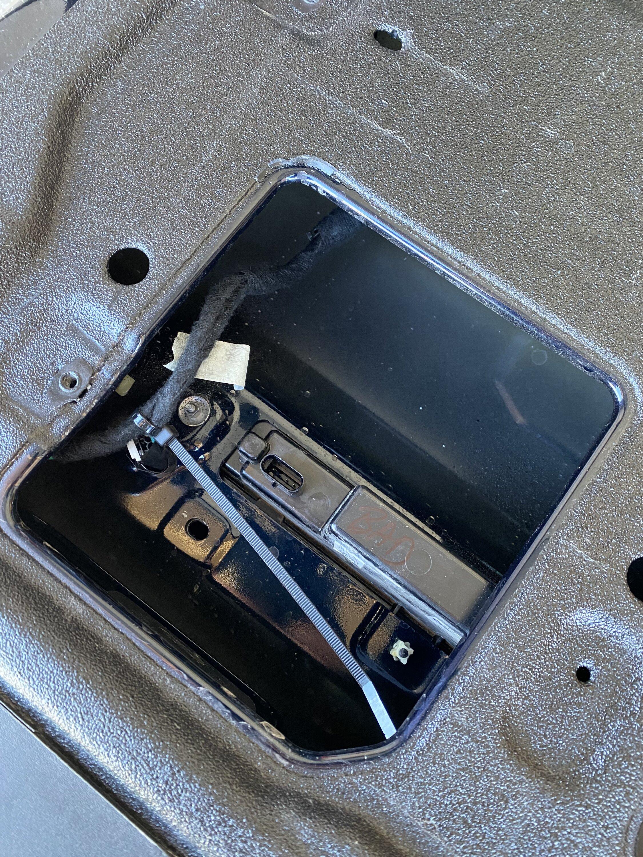

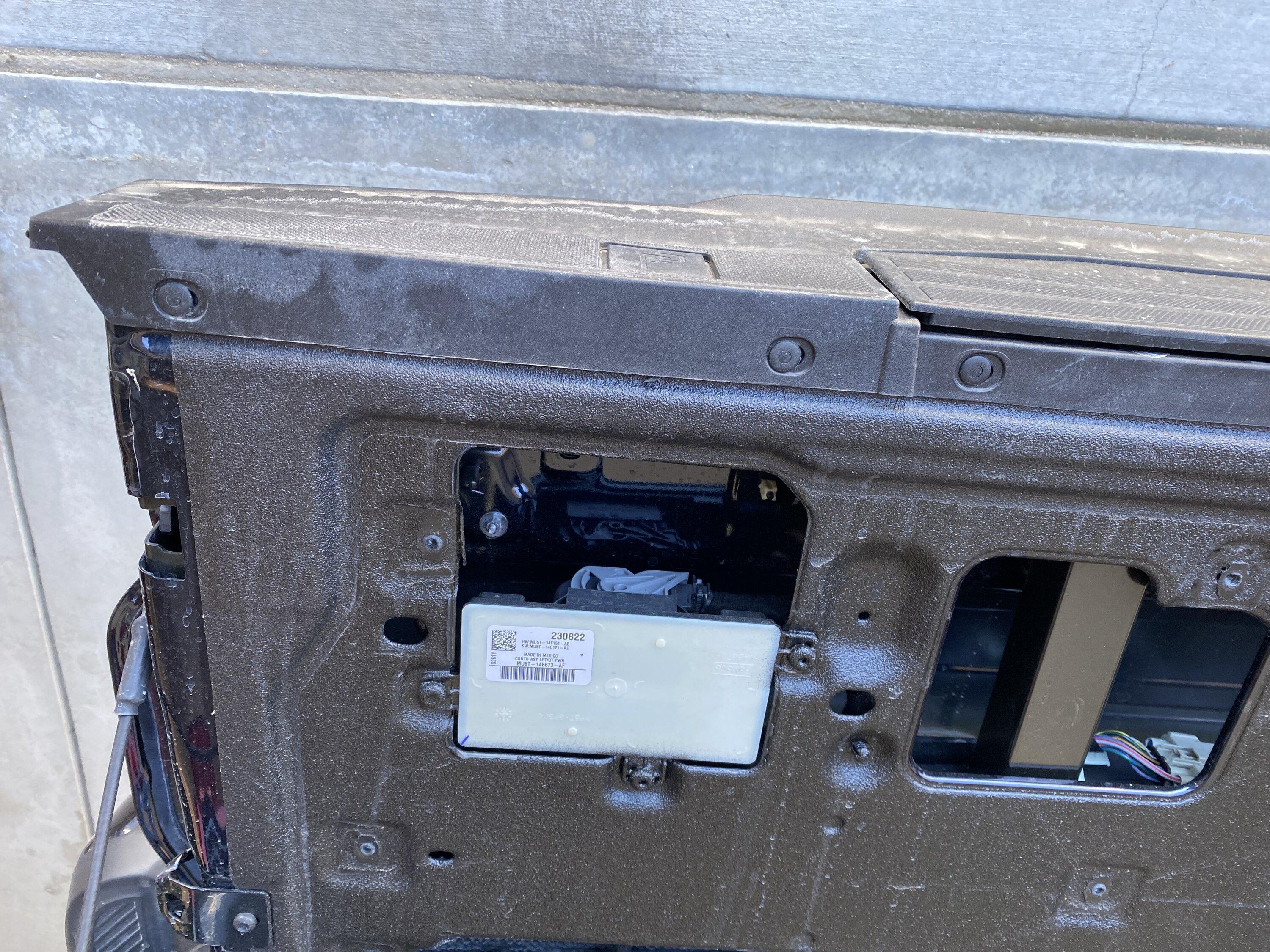

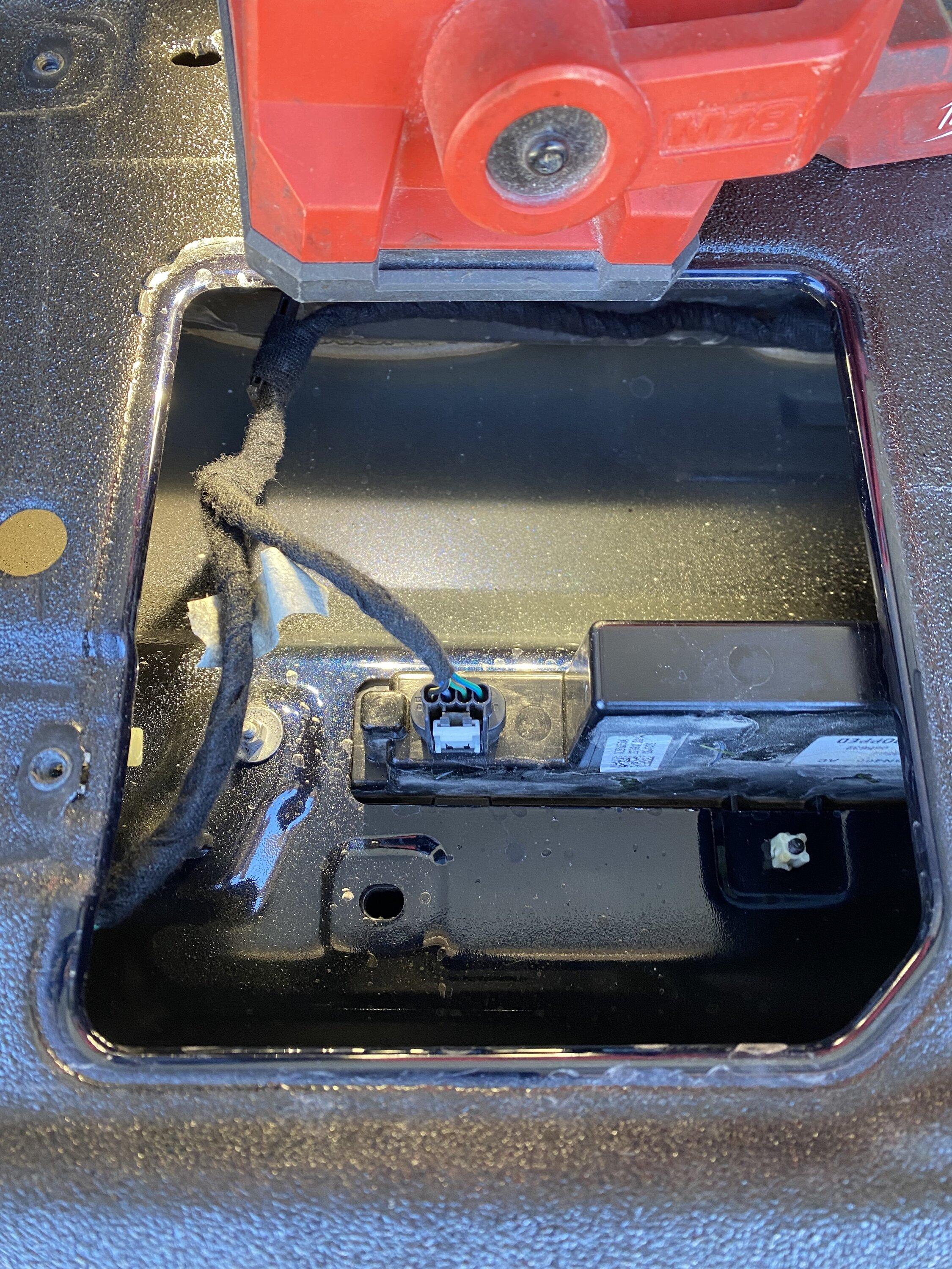

Dug into the tailgate and pulled the wire for the light bar to stop the white lights flickering and the potential for the red lights to go crazy while driving. I didn't see any water intrusion inside the tailgate (tracking in the dust). I think it is just coming in via the seal on the plastic bar. Definitely will have to pop off the tailgate cap and the painted part above the light bar - see photos. Should be able to just replace the push pins after removing.
Edit: Looks like there are blue "vents" along the length of the light bar inside the tailgate. One of several was blocked via the bed coating process...but still doesn't seem to be the source of the leak.

Pull this plug (pull out white tab and then squeeze top to release)
Ford F-150 Lightning Water in rear light bar IMG_2523
Taped up to prevent shorts.
Ford F-150 Lightning Water in rear light bar IMG_2527
Top cap and painted part likely need to be removed.
Ford F-150 Lightning Water in rear light bar IMG_2524

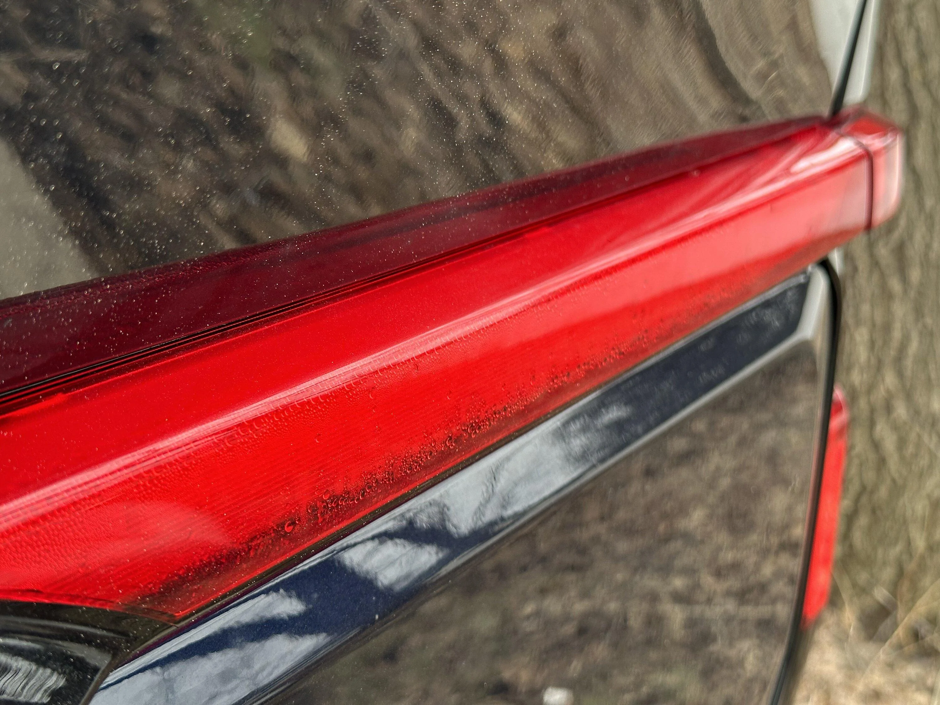

A few days ago, I noticed a buildup of water, and today, the white LED section stopped functioning while the entire red section flashes sporadically. The dealership has requested to see the truck before they can order the part.
My story is basically the same as what others have shared here, but I just wanted to add my experience so that someone from Ford may be made aware of the number of issues with the lightbar.

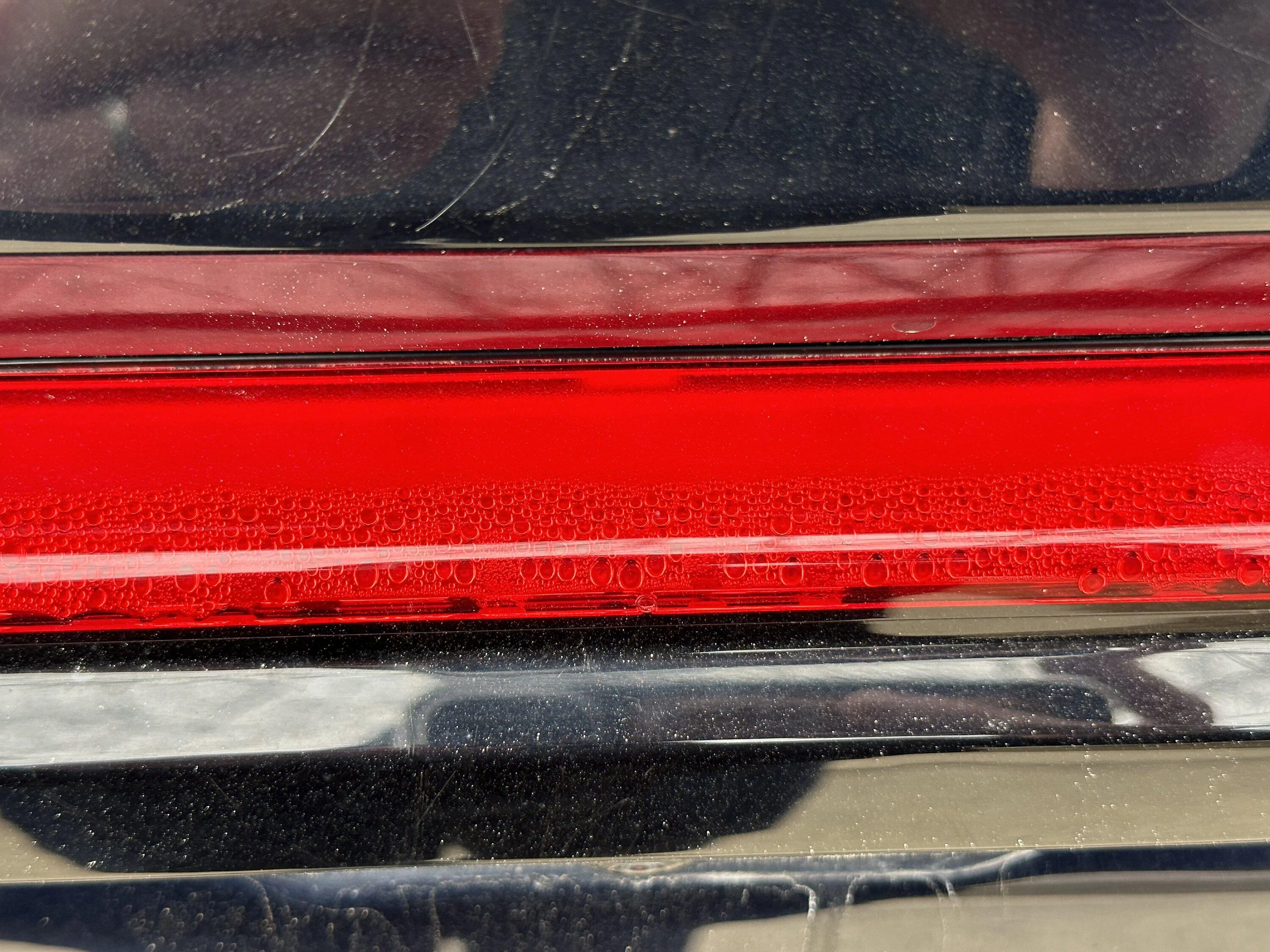

Has this caused anyone else to have issues with their cameras working properly? I've had intermittent issues a few times with them and I thought a software update had fixed them for good, but no dice. The camera either stops working all together or is extremely fuzzy. It started again last week after it snowed out, fixed itself for a few days and then happened again after I took it to the car wash this past Saturday. I remembered this thread and sure enough, noticed what looked like condensation inside the light that goes across the tailgate. However, I haven't noticed any of my rear lights flickering. Thoughts?

Safe bet to assume that if you’re getting moisture, it’s likely affecting the camera. I’d take it in and have the bar replaced for the moisture alone.
