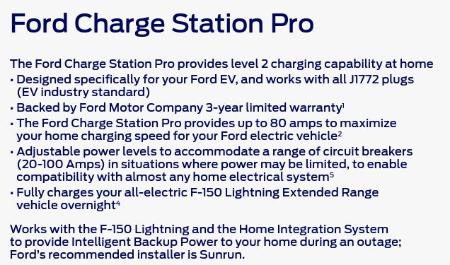

hmmm no thanks! you should REALLY check with your insurance company...Ford requirements for installation of the 80A charger are clear and that's what insurance companies / local by laws will likely require.
For sure you can derate it, but I would not put my money on doing that without the proper set up, clearance from insurance company, local bylaw, etc...- if a fire were to happen, your insurance company will be looking at your house with a microscope and they could easily deny payment sole on the basis that you installed a 80A charger on a 200A when that specific charger had a clear outlined requirement for 400A....too much risk to lose my $1.1M house to something as small as that LOL...

Why would my insurance company need to know about an EV charger ?
Doesn't it just need a licensed & bonded electrician who pulls a permit from the city /county ?
My 200A service is more than enough according to my electrician for adding an extra 100A breaker.
My current PHEV L2 charger has a 30A breaker and my electrician can install another 100A breaker in the same garage.
He said due to many gas appliances, the house does not come close to using up all the wattage from the panel. Since we charge overnight, the load on the panel will be negligible.
Likely a non- issue
all these people are tripping. You can install it on any breaker you need, they are adjustable chargers. Ford has realized they are selling to people with old houses that have old panels and don't want them to spend the tons extra money on upgrading their electrical just for the truck.
saying that, it would be a waste putting in an 80 amp charger on a 20amp breaker.
Per ford latest spec, you would need a 100amp breaker to fulfill the 80 amp charging.
