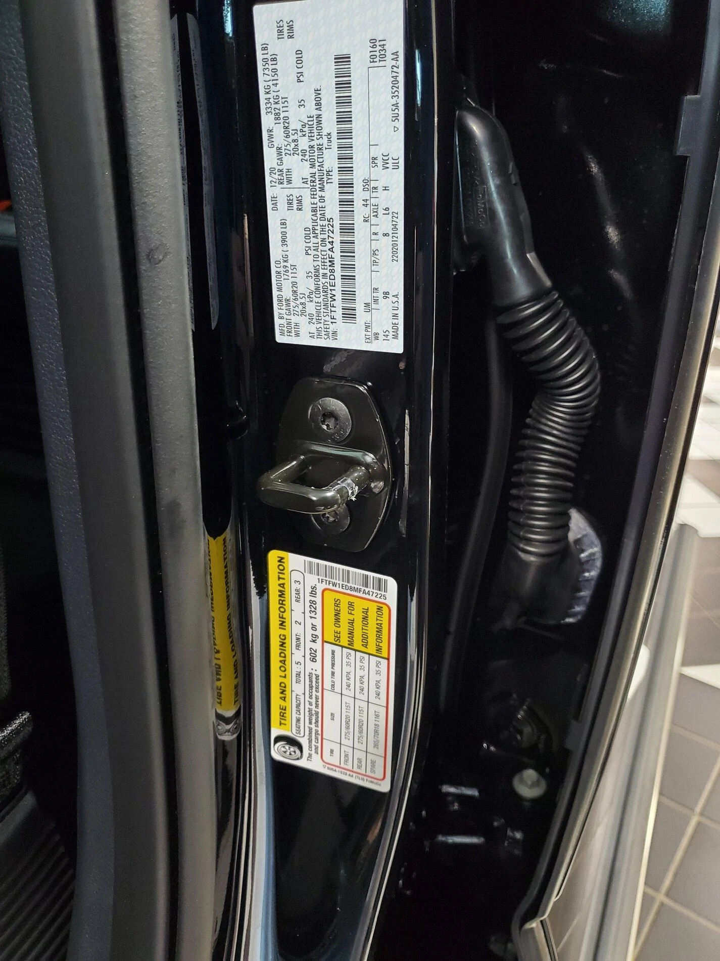

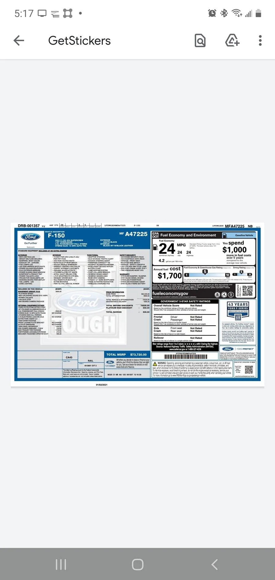

Here is a Plat at my dealer. I am avoiding towing packages and will upgrade sway bar if I want to tow anything heavier than 7k as that is the only improvement for $1k.
Ordering a 701A 4x4 PB shortbed myself.

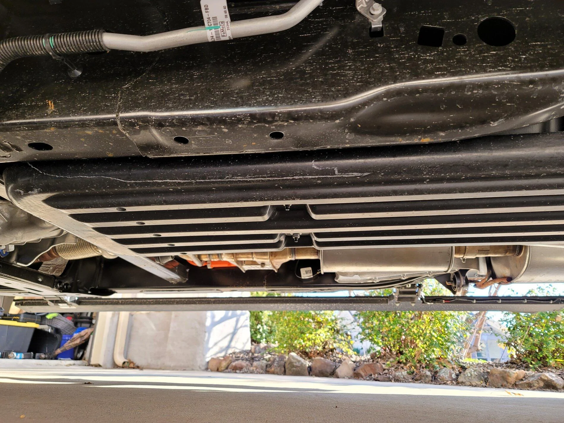

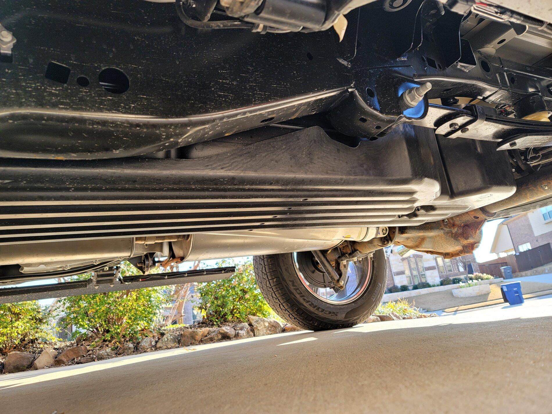

My non Fx4 has skid plates on the gas tank. 28bs for the FX4 seems like a lot for 2 Aluminium skid plates.
