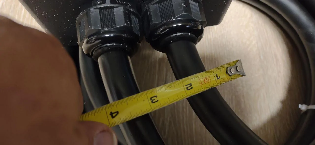

I bought the GRIZZL-E 40A Level 2 EVSE, because it cost $459, the Ford 48A EVSE is $799. I may wind up eventually getting the 48A EVSE to use at home, and use the GRIZZL-E at somewhere like my parents house. (The included EVSE would be used while on vacation). The circuit this will be on will be on a 60A breaker, in case I do eventually buy the Ford 48A EVSE. Although... Ford's 48A has a much thinner charge cable compared to the GRIZZL-E.
The GRIZZL-E has jumpers where you can set it to 16A, 24A, 32A and the full 40A

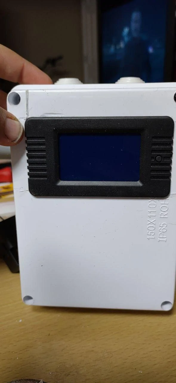

I'll be using this to monitor power usage from the EVSE so I can get an accurate cost of charging the Lightning (which would include any losses in the system from charging)
