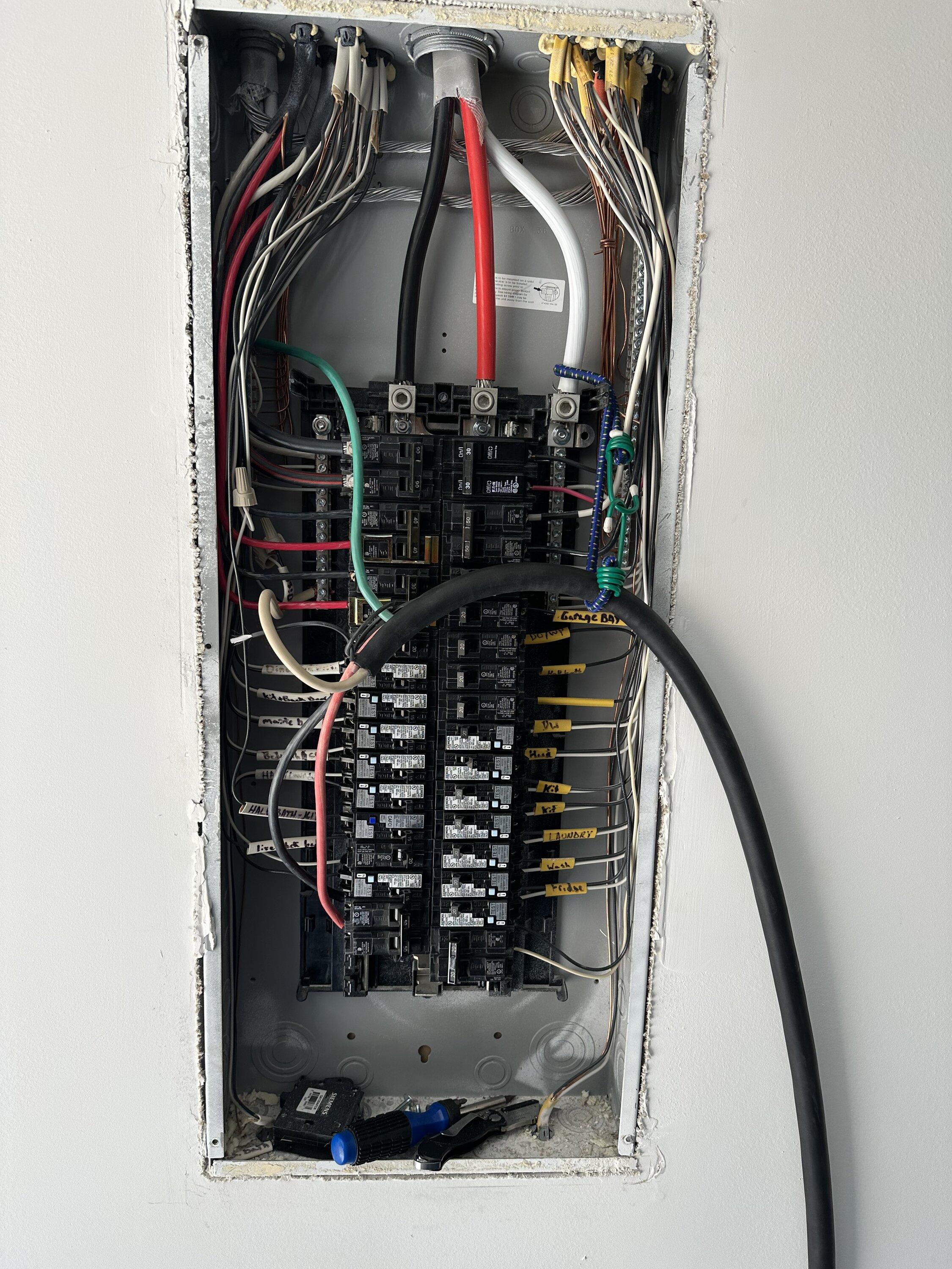

Sweet. Got it added. And we have juice. 240v vs trickle 120v. This will hold me over until HIS and L2 charger is installed. Products in garage…awaiting competent electrician.
400A to house, 300a full load. Got 50a breaker, 6/4 6AWG SOOW 20’, 14-50 NEMA outlet.
Breaker, NEMA plug: Lowe’s or your fav.

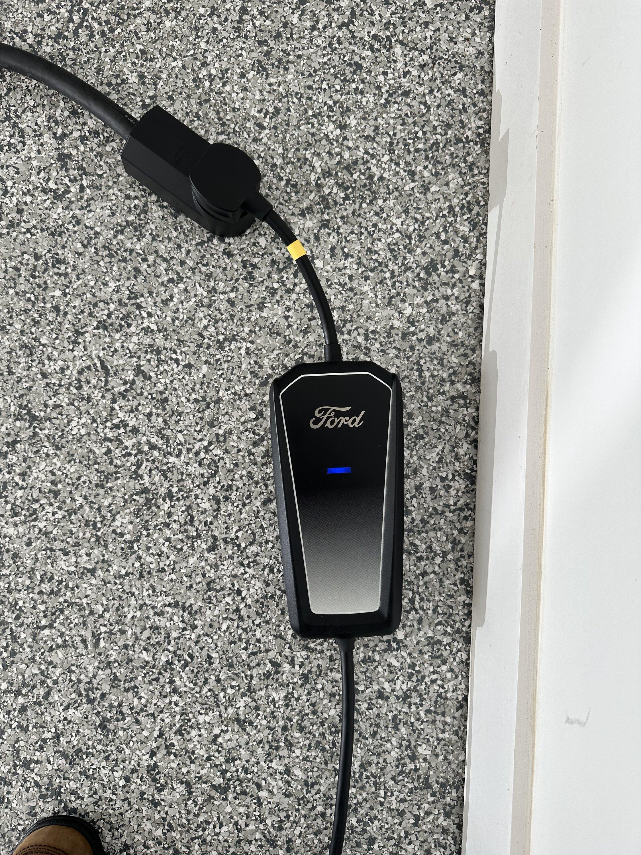

Using the 240v mobile power cord is providing 6kW/hr. Which is 25amps (Added 31kW in 5 hours, carry the the one). Much better than the 110 household outlet. I can technically charge for energy used daily. But this is just a temp solution until I can get the L2 with HIS installed for intelligent power.

The bungee cord is a nice touch!
