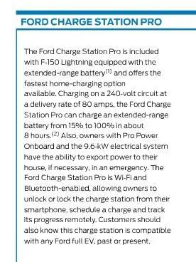

There is no evidence pro power onboard upgrade is required to utilize the V2H. There IS evidence that the V2H solution could get very expensive, and a bigger add for SR vehicles that require an additional activation fee and Charge Station Pro hardware purchase among all the other purchases as ER owner would also have to make. So point is that the pro power onboard upgrade is probably well worth the money to make work as the home back-up over the actually home back-up system Ford is marketing so heavily and then outsourcing and staying silent on details.
Nothing except this from Ford:
Ford F-150 Lightning Will Max Tow Package on Lightning reduce range when NOT towing? 9.6 required for emergency power
