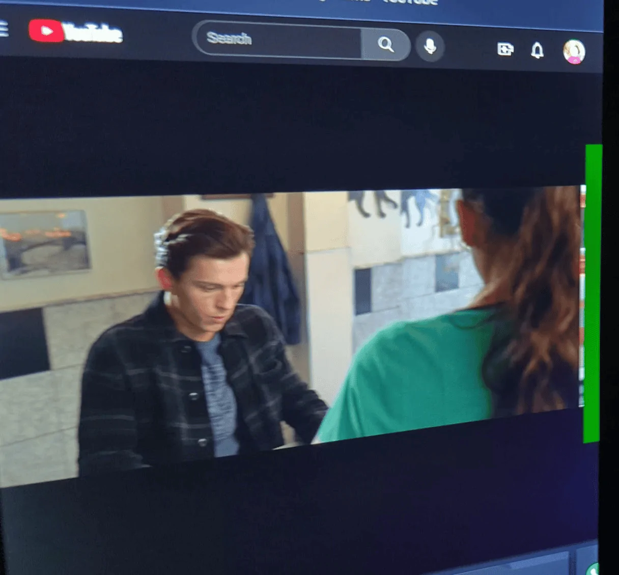

Curious if others have seen this issue. If yes, then it's likely systemic or a software issue. If no, then I guess I should schedule a date with my local dealership.
My streaming free-pass is about to expire, and I believe I lose the ability to stream even over my own WiFi when that happens, but even so, I'd like to know the hardware isn't faulty.
See the green lines on the right side of the screen when displaying the video? These sort of jump around during playback. Doesn't much matter what video I choose to watch. Have other experienced this?

Yes I have seen that before on many devices, its usually from low streaming speeds and the software is adjusting to a lower bit rate. I bought a iPhone for my wife and it came with a free iPad with $10 a month data service from Verizon. I keep it in the truck to use as a hot spot and it works great,

I appreciate the response, but I disagree. If that were the case, I'd see resolution issues and color-banding across the entire screen. I'm not seeing that, this is only on the right side and it's always green, no matter how good the connection is. From the responses, it sounds like others do not have this issue, and I likely have a faulty part.
In to see the service folks, I shall go.

Yes if it's in the same spot then it's a screen issue.
