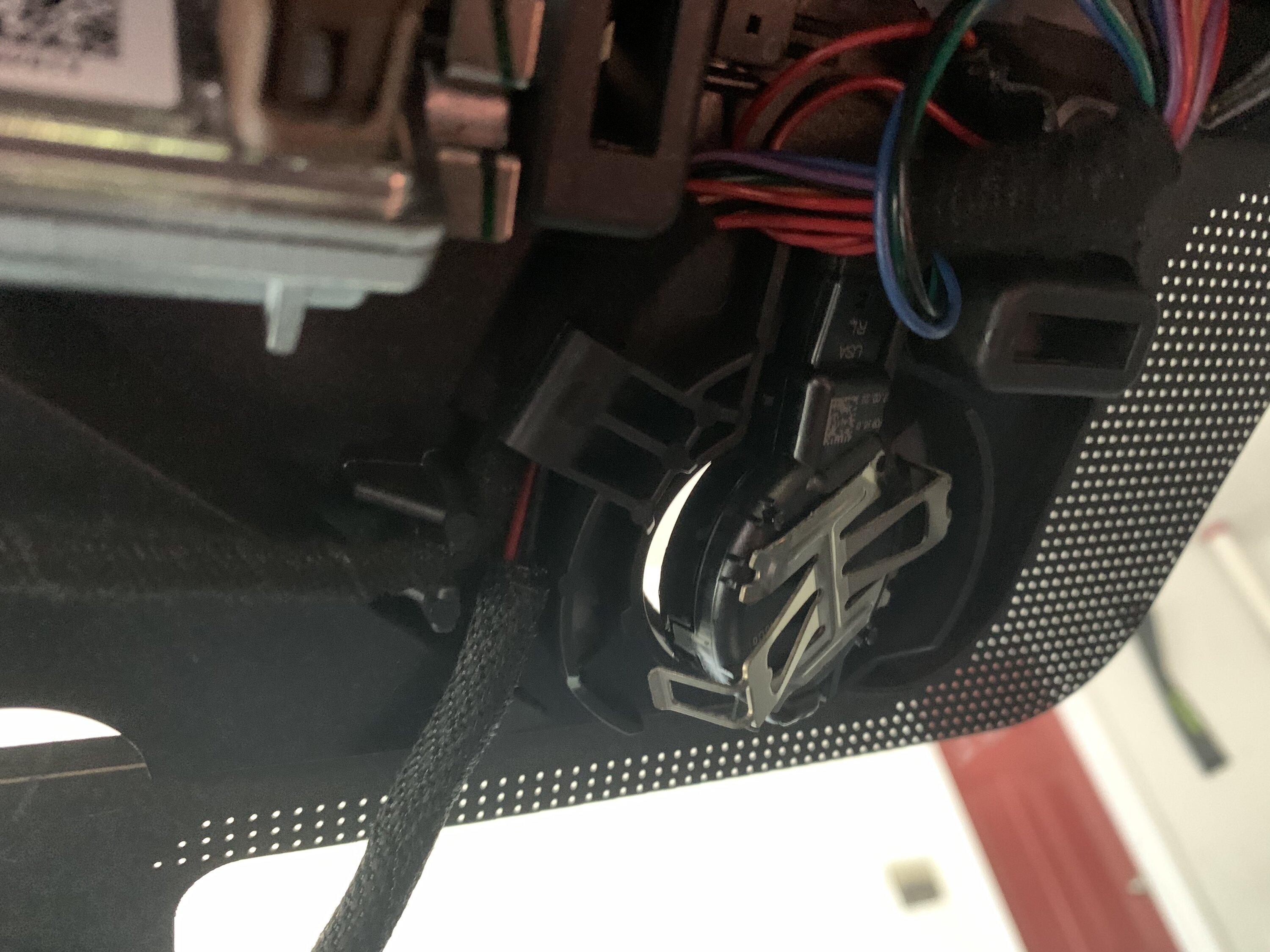

Well I went ahead and took off the plastic covering to take care of this issue, sure enough the sensor was almost completely off.
Before:
Ford F-150 Lightning “Rain Sensing” Wipers Don’t work 2FBE4D7A-E377-4DF8-A07A-A63C7A4864F2
After:
Ford F-150 Lightning “Rain Sensing” Wipers Don’t work 872DB44E-F5F8-49EE-9748-CFE0FA7EA383
For anyone not willing to do this themselves and have issues with the rain sensing wipers make sure you let the dealer know about this specific fix or else you might get the “we have to order parts”
Hopefully this fix works for me, we’ll see tomorrow as more rain is expected.
