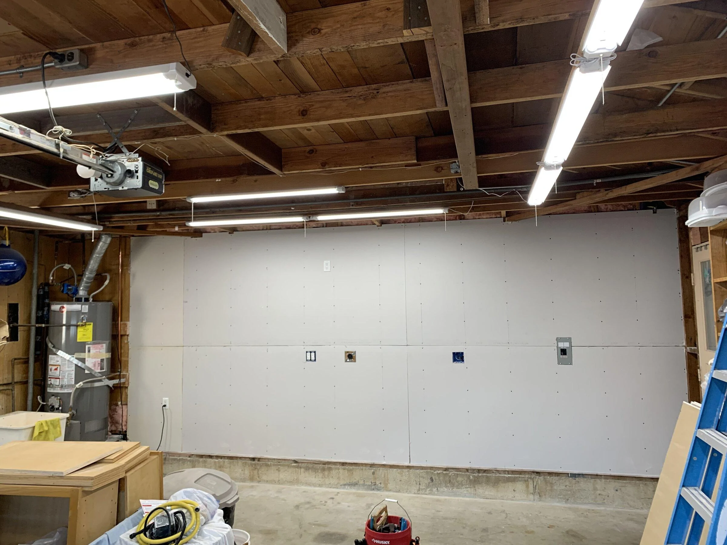

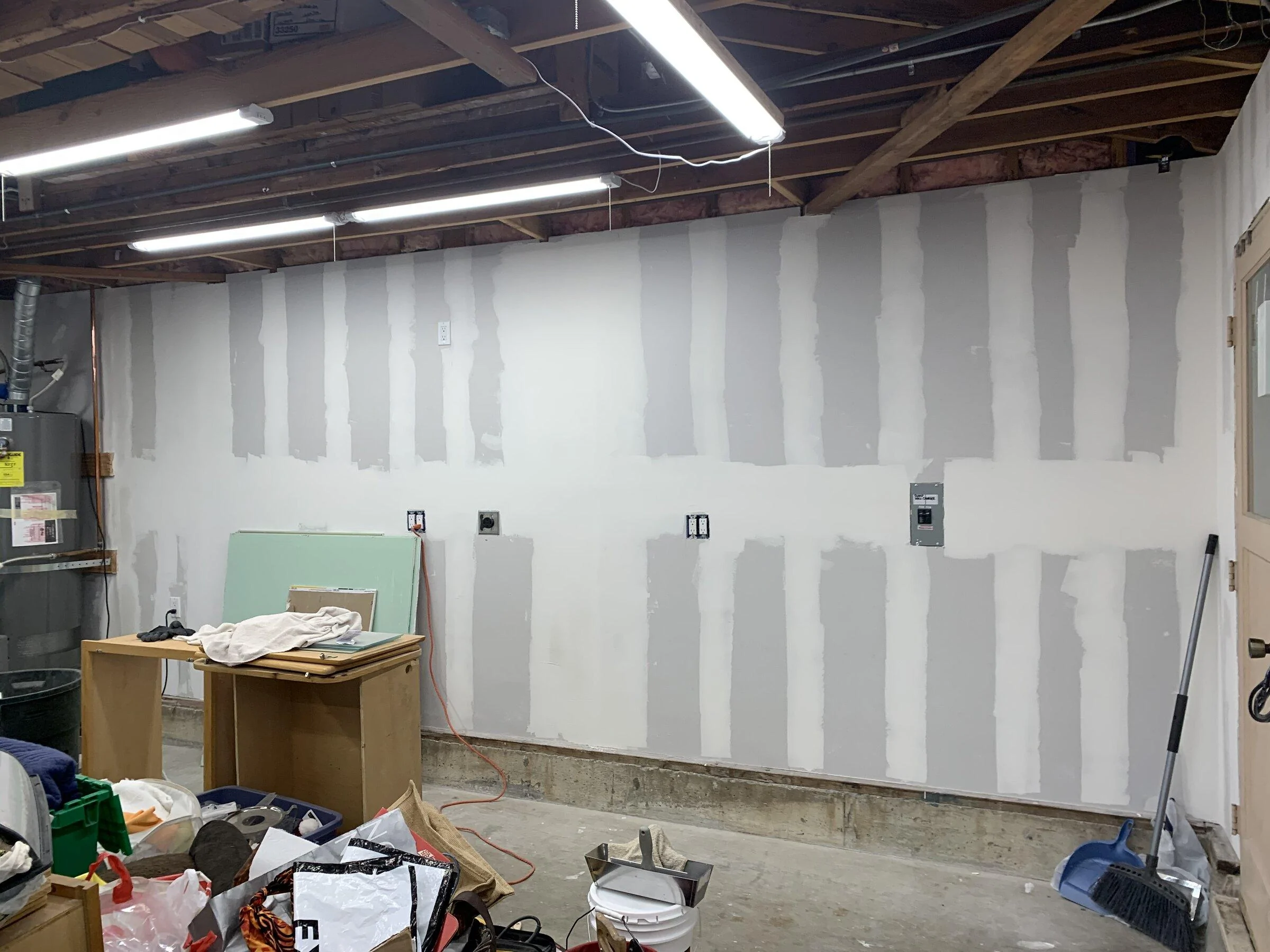

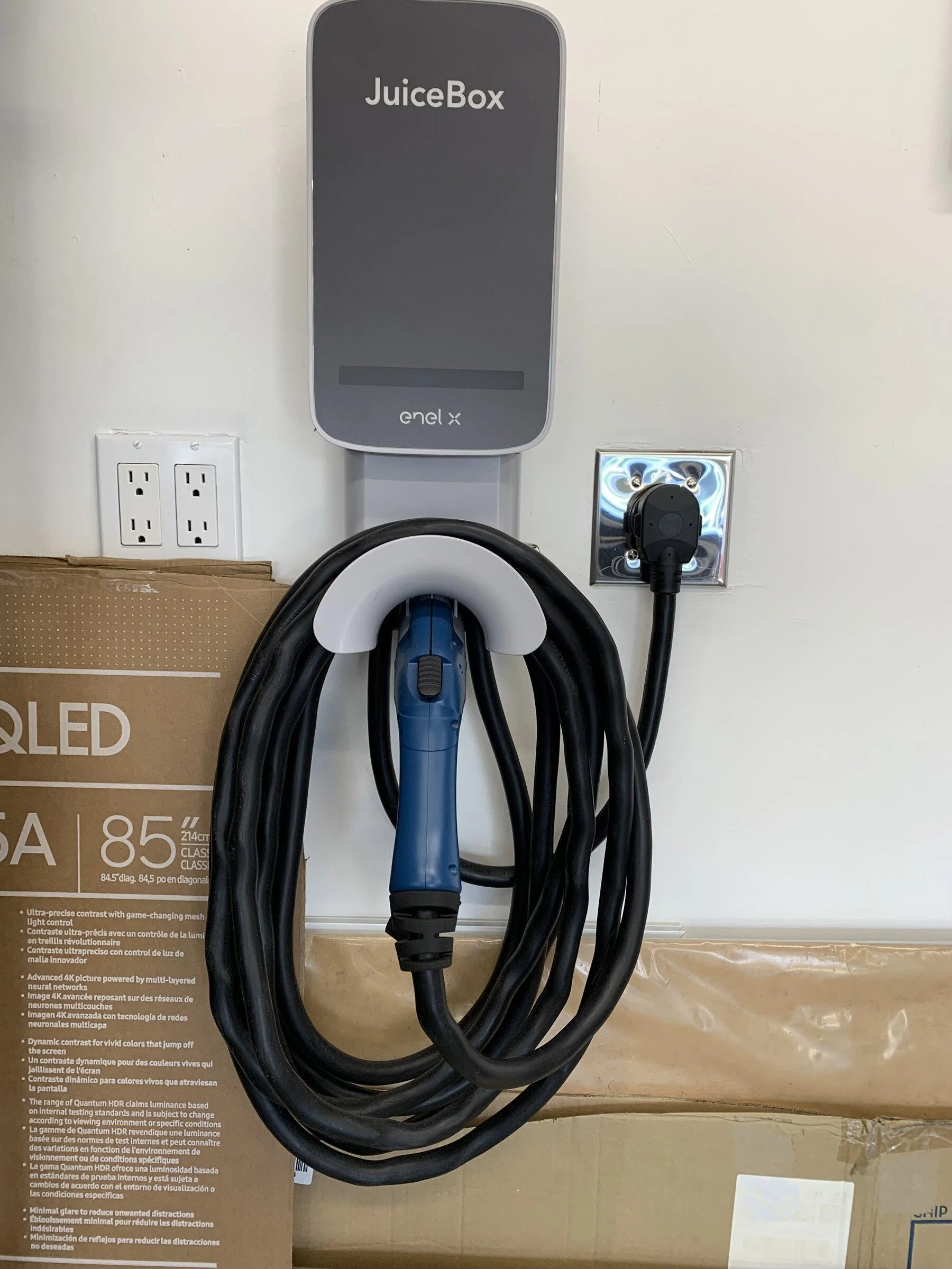

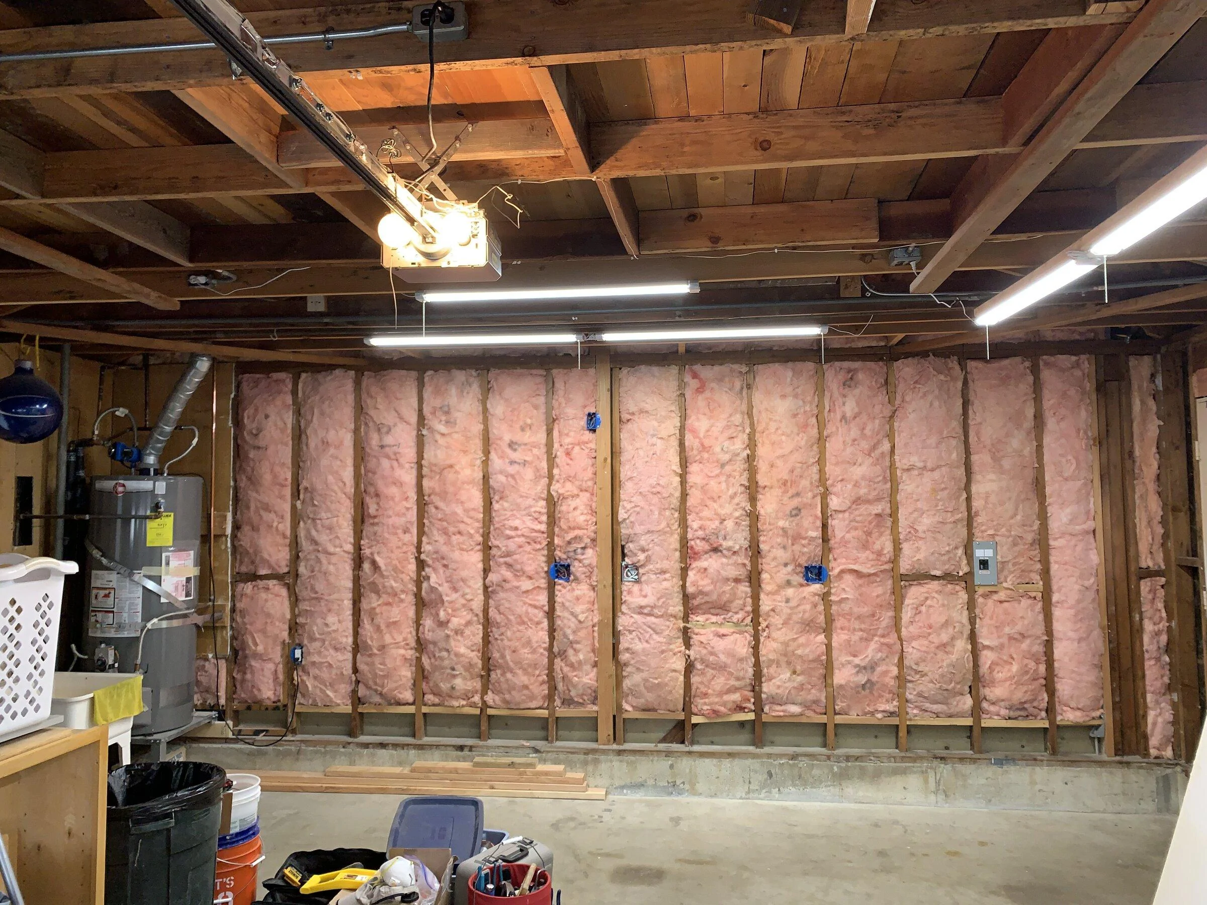

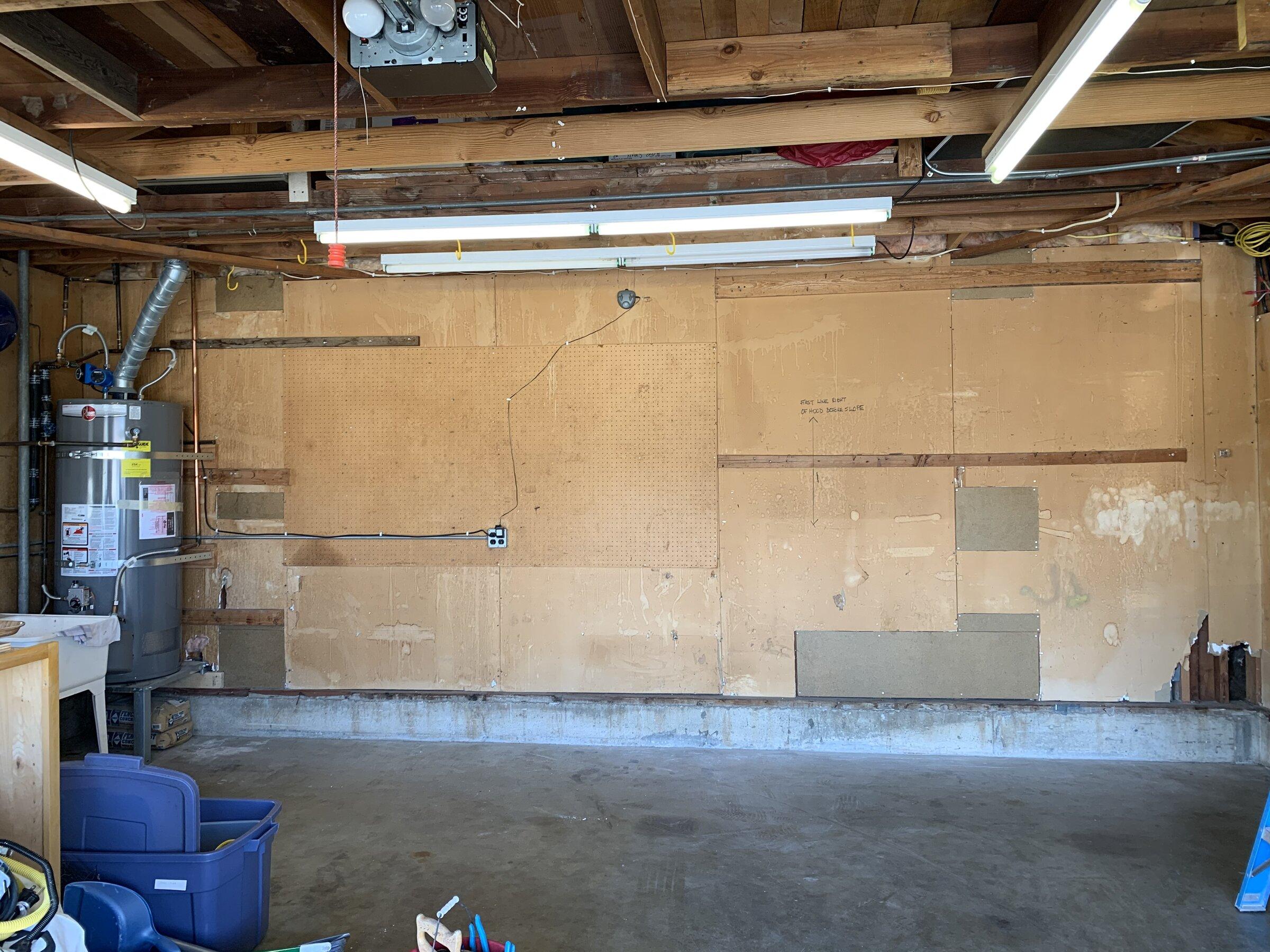

Installed wiring for ev charger while remodeling my garage
Looks great! I just ordered a 40A JuiceBox myself and have to get it installed. I've got to get up into the hot attic to wire it in the garage and not looking forward to that part.
I love the humble flex of the 85" Samsung TV, too!

The 85” tv box makes great floor covering during remodeling, tv is good too. LoL..
