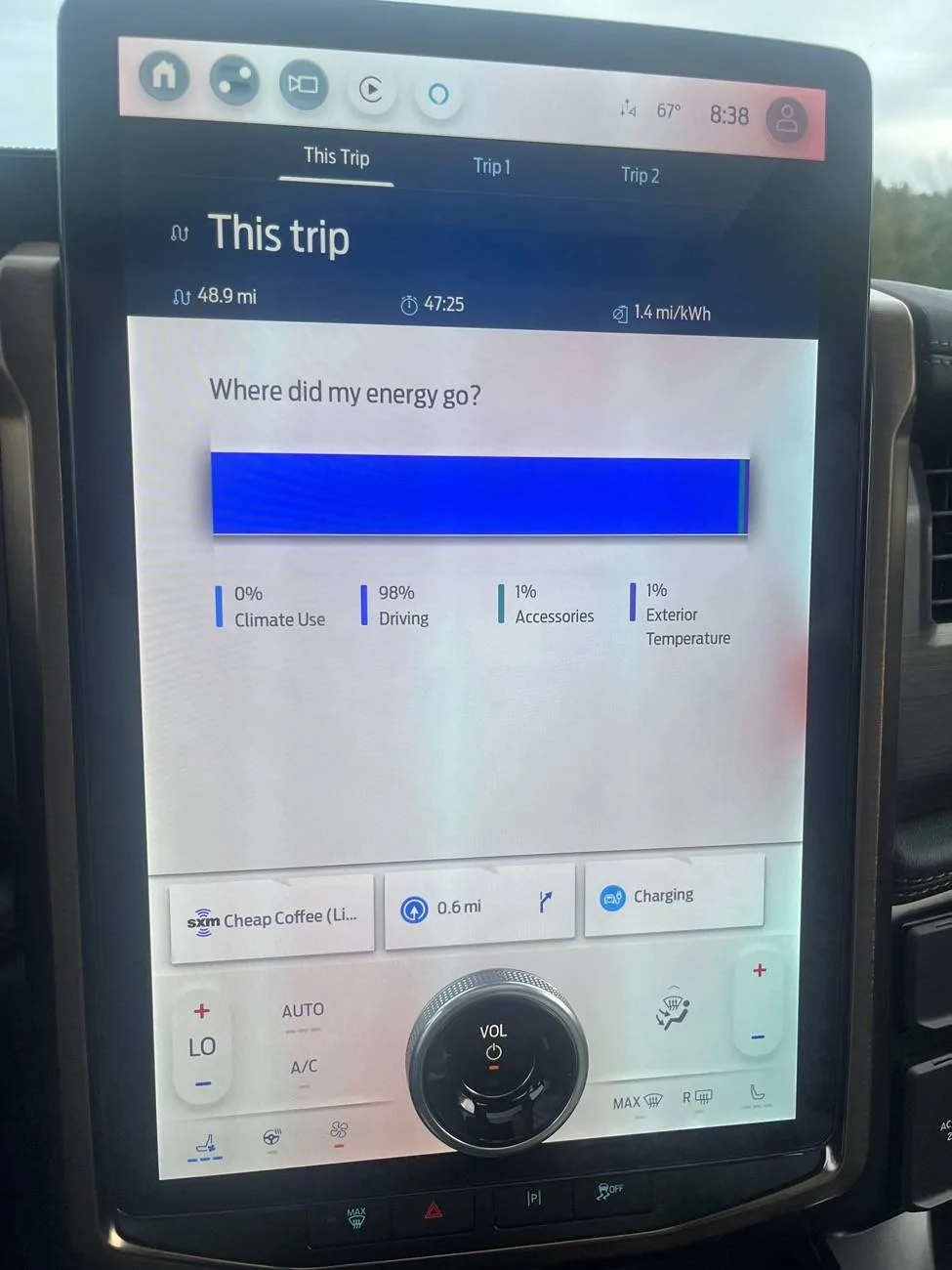

Had my lightning for just about 10 days and while I love it so far, I was pretty disappointed with this efficiency. Of those 49 miles, 36 or so were on the interstate, setting cruise to 79 mph. All flat on I-95 in Coastal Georgia. The first 13 or so miles were from my house to interstate, and up to that point it had gotten about 2 to 2.1 on those 13 miles (cityish driving). Outside temp hovered between 65-70 as sun was coming up.
Is this what I should expect for interstate driving at that speed? It was close to 30% of the battery. Will it take a while to “break in”? I’ve got about 750 miles on the truck. At this point I might just as well put 37” mud tires on it ?

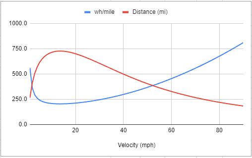

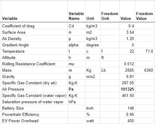

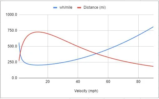

Dogpiling, but here we go.
I made a little spreadsheet model of rolling and air resistance using the F150 Lightning's parameters, and this graph hopefully helps:
Ford F-150 Lightning 1.4 kwh/mi on interstate…disappointed. 1729009778065-s1
Ignoring the absolute precision of the numbers, what it's saying, like others, is that you can get double the range going 25mph as going 60mph. At speed, around 55 to 85 mph, each 5 mph gives or takes 10% +- 1% of your range. There are lots of variables that can affect this, though. Here are some of them:

So, if you have 200 miles of range left (calculated based on wh/mile at current speed, not on the GOM) and need to go 220 miles, go 5mph slower.
