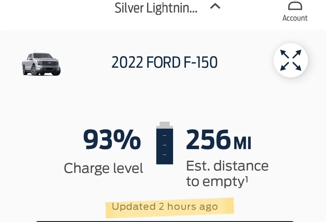

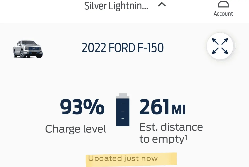

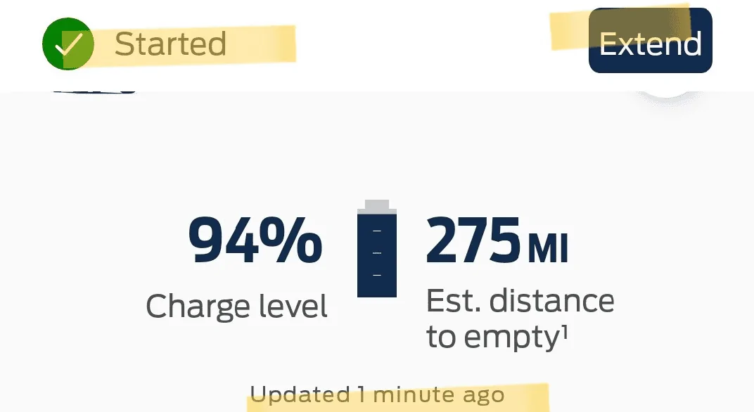

Another thing to watch is stale data on the app, it's not constantly refreshing, you need to trigger a comm event to get it updated, lock or unlock, interestingly my truck since parking in our driveway not plugged in for over two hours with the temperature rising 10 degrees from ~24 to 34°, caused the DTE to rise 5 miles and the SOC is steady.
Warming cabin 10 minutes before leaving breakfast place, half hour earlier we left home with 95%
Ford F-150 Lightning 10% Charge Loss Overnight--portable 120V charging 1672073033438
Arrived home about 9:20 am @24°, screen shot taken a few minutes ago.
Ford F-150 Lightning 10% Charge Loss Overnight--portable 120V charging 1672073110680
After tickling comm's to the TRUCK, @ 34°
Ford F-150 Lightning 10% Charge Loss Overnight--portable 120V charging 1672073169681
