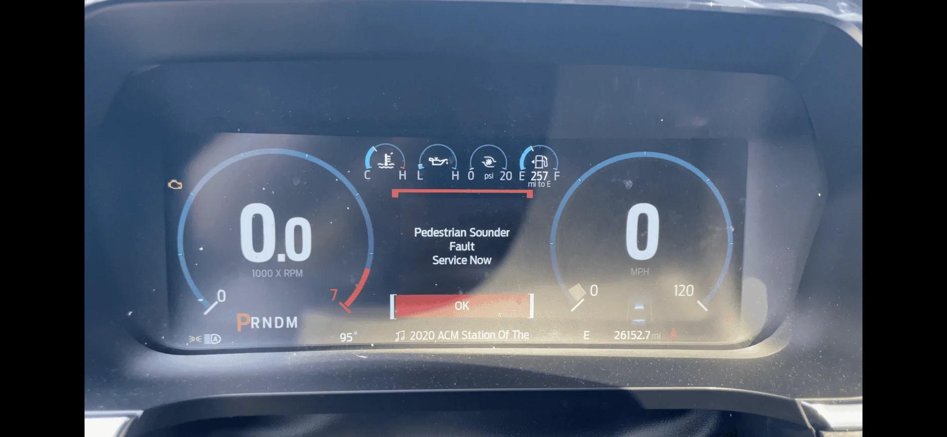

I'm not sure then because I don't see any value to disable any warning message. Maybe figure out the ohm resistance of the speaker and short the connector with a matched value resistor to trick it? Not sure if this is a good idea so maybe someone here with better electronic knowledge than me could chime in if it's worth trying or not. I don't even hear it if I have the stereo volume up so it doesn't bother me enough to try.
I just went outside and caused my first plastic connector marring getting that stupid thing off. Wasn’t pulling the front portion off the truck, so I used a pair of pliers thin like the size of the tab to depress it, and then a long handled scraper to pry/remove the connector.
Placement of that plug only confirms that Ford Engineers laugh when they put things in certain places on engines/drivetrains.
I will Ohm the speaker to see if that is an option. It is only a 2 wire connector, unless they are using chassis ground and smart AI looking at the sign waves. I know how to do the resistor part, but with FORScan it seems like I should be able to do it in the computer somewhere.
Even with the AC on MAX, I can tell the truck is overall quieter. Even with the engine running and all of the above, I can tell it’s quieter. I like it.
Here is the fault warning message if that helps finding it in the code.
