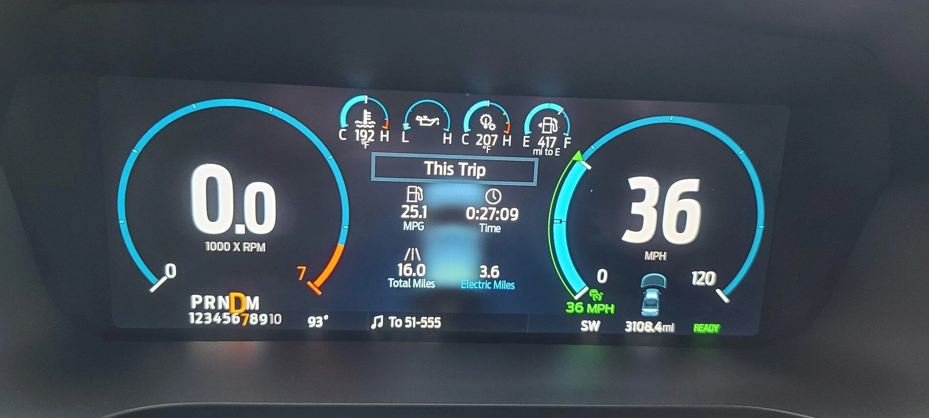

Used the same method as the last Gen and got the dpf sceen to show. Mine is 21 Platinum 3.0. No error codes yet.Message me your VIN so I can pull your asbuilt values and I'll give you some stuff to try

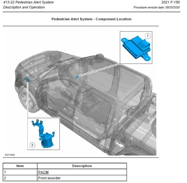

Sorry for changing topics, but That was my first post on this forum, and I am just now getting used to everyone’s names here, and realized I missed this response from you. Thank you for answering me BTW.I researched disabling the Pedestrian Alert and looks like the only way to do that is pulling the wire on the speaker. Also, nothing for disabling the "keep hands on wheel" message.

I'm unsure if you'd have any on-screen warning after unplugging the speaker.Sorry for changing topics, but That was my first post on this forum, and I am just now getting used to everyone’s names here, and realized I missed this response from you. Thank you for answering me BTW.
Ok, if I pull the wire on the speaker, there will be a warning message on the cluster screen.

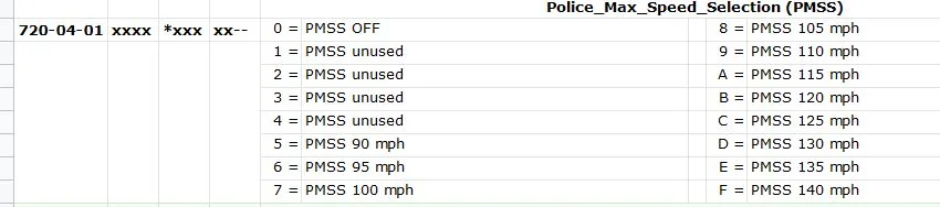

You could try it but I'm sure the police clusters have different firmware that actually allow the change.I have a quick question in the IPC section the police package information is that based off of the cluster installed or this a way to raise the speed limiter bascially like when we run tunes and disable it with a tune? I am just curious if selecting one of these would change the speed limiter range or if this is more cluster calibration focused or if this is based off of more then just code.
According to this thread there is a displayed warning message:I'm unsure if you'd have any on-screen warning after unplugging the speaker.
