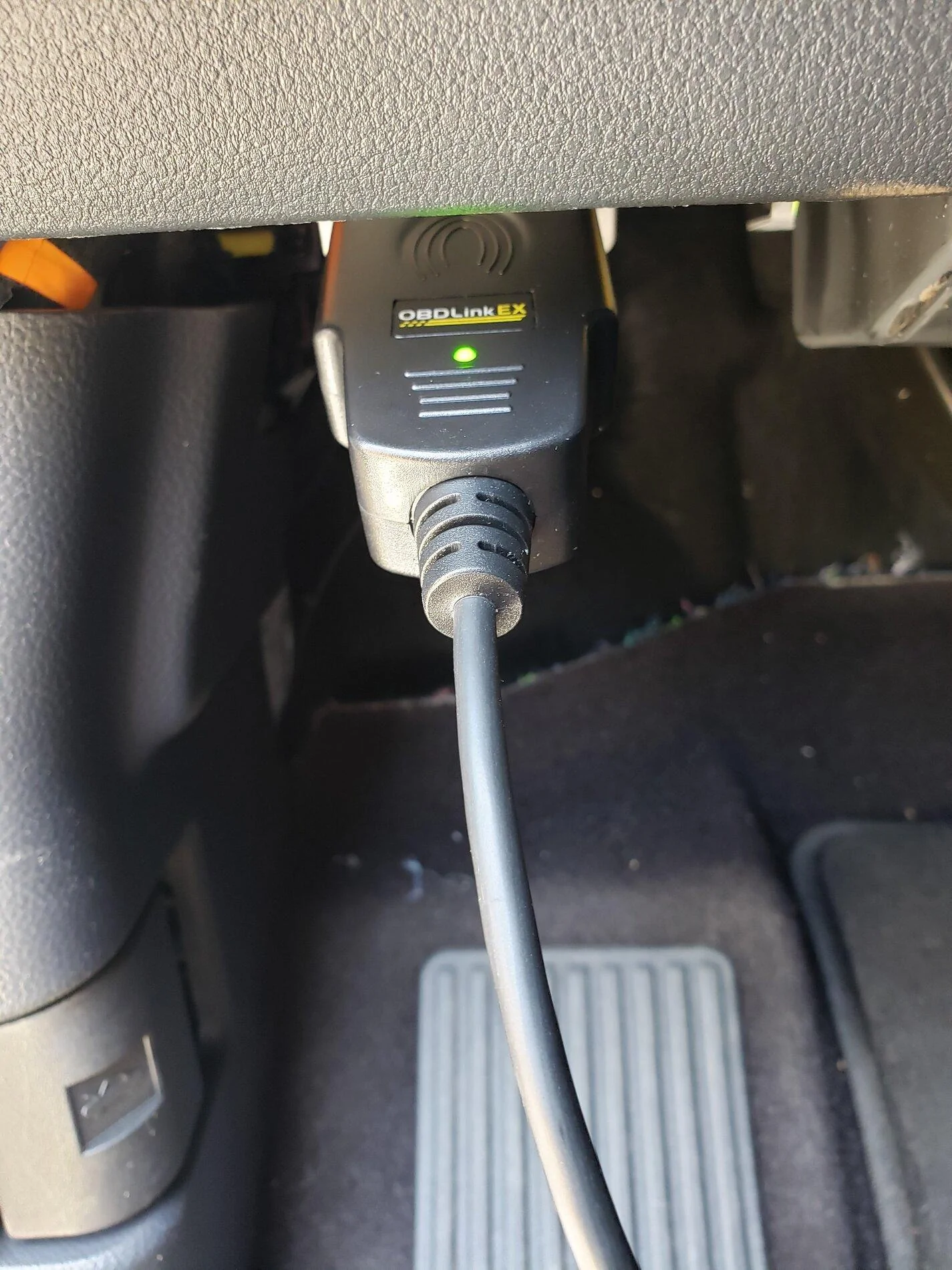

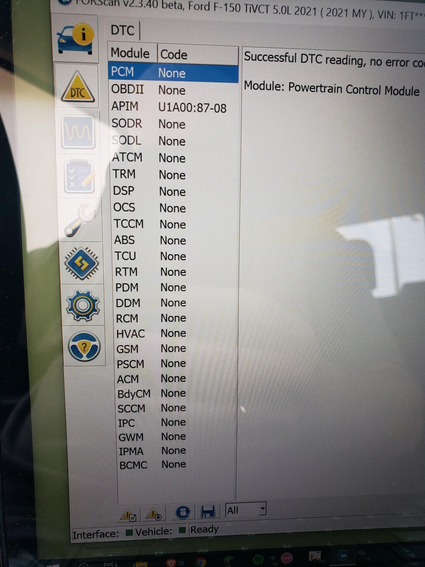

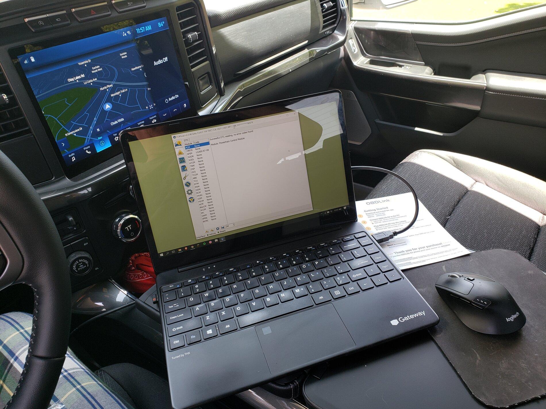

FYI: Got my OBD Link EX and it works so far. Some pics of what it looks like. Ran Forscan app.
Just reading codes to see if there's any errors. No errors. Thanks for help.
Great use for interior work surface.

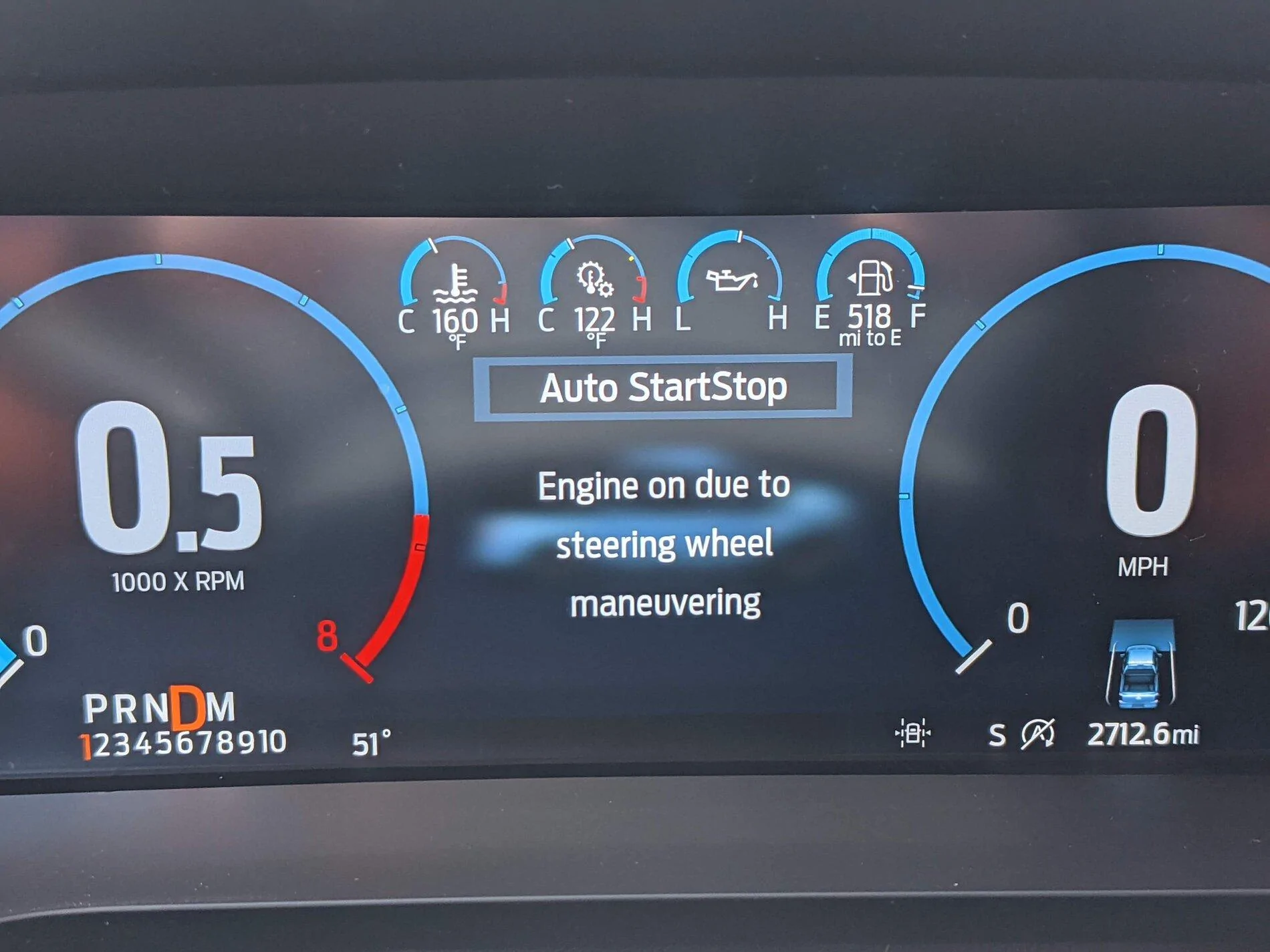

The following has been reported to disable Auto Start/Stop:
PSCM 730-03-01 xxxx xxxx 00--
If you keep the Stop Start status monitor open in the IPC (found in the Trip Fuel menu) you can monitor that every time auto stop start should kick in it will not due to a 'steering maneuver in progress', which is a auto stop start interrupt generated by setting this.

This is actually the 2nd mod I've seen that disables the Auto Start/Stop and I never mentioned the first one because it came with trade-offs. The person that first tested this newer mod (Airborne_Ape) said "In my tests this generates no errors, no DTC's, no prompts, no chimes and keeps the battery monitor system active. The Auto Start Stop algorithm is just always interrupted by the PCSM and will never work."
I then waited for another person to confirm this working before posting & adding it to my spreadsheets.

I just tried it as well and get the exact same thing after a dozen or so stops. No other messages than this one, and no other side effects that I've noticed so far.
Ford F-150 Lightning 2021+ F-150 FORScan List / Database / Spreadsheet ? PXL_20210526_182613087
From what I can tell, by changing that "1" to a "0" you're basically just tricking the Power Steering Control Module into thinking that the steering wheel is currently in motion, and therefore A.S.S. is not activated.
Since this is a normal action that it looks for each time you stop it wouldn't generate any kind of error, therefore, no error or warning messages. It's basically the VW EPA scandal in reverse.
