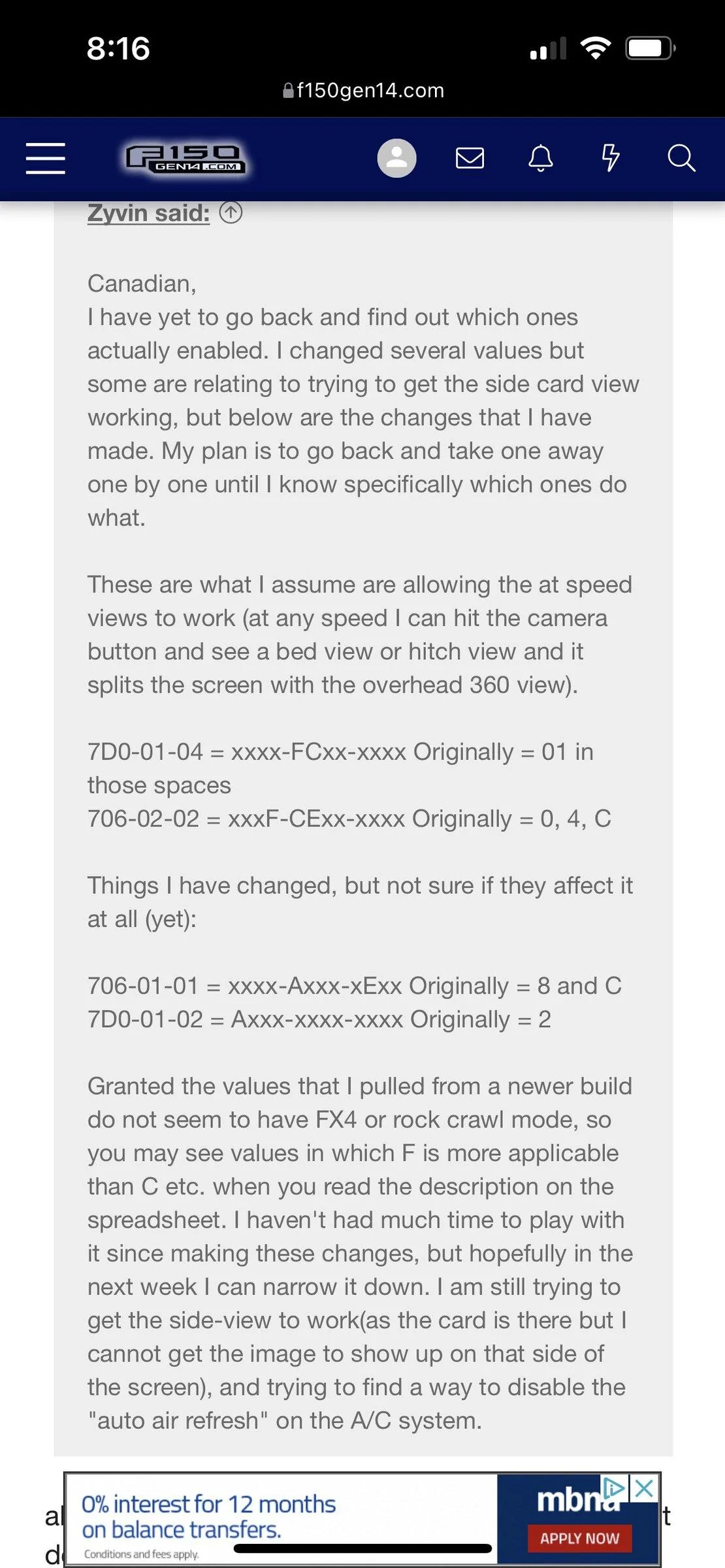

I have yet to go back and find out which ones actually enabled. I changed several values but some are relating to trying to get the side card view working, but below are the changes that I have made. My plan is to go back and take one away one by one until I know specifically which ones do what.
These are what I assume are allowing the at speed views to work (at any speed I can hit the camera button and see a bed view or hitch view and it splits the screen with the overhead 360 view).
7D0-01-04 = xxxx-FCxx-xxxx Originally = 01 in those spaces
706-02-02 = xxxF-CExx-xxxx Originally = 0, 4, C
Things I have changed, but not sure if they affect it at all (yet):
706-01-01 = xxxx-Axxx-xExx Originally = 8 and C
7D0-01-02 = Axxx-xxxx-xxxx Originally = 2
Granted the values that I pulled from a newer build do not seem to have FX4 or rock crawl mode, so you may see values in which F is more applicable than C etc. when you read the description on the spreadsheet. I haven't had much time to play with it since making these changes, but hopefully in the next week I can narrow it down. I am still trying to get the side-view to work(as the card is there but I cannot get the image to show up on that side of the screen), and trying to find a way to disable the "auto air refresh" on the A/C system.
alright I’ll do some digging hopefully u can arrow it down that would be great. I was able to add the bed camera to the side menu but it doesn’t work.

Did you get it to work on the main display (I.e. get up to speed and then push the camera button)? Mine works, just takes up the whole screen. This is at 19 mph. The second picture shows my sync version too. It updated to this version before my cam would work at speed. It went to this version with an over the air update.

Today I learned! Thanks for the clarification. So to achieve the cameras past parking lot speeds, do you remember which values you changed? Also do you mind sharing your f150 specs? Mine is XLT 302A, crew cab, fx4, 3.5 eco.

Check out this post. I haven’t had a chance to really narrow it down as I was working on a few different things at once. Maybe this weekend I’ll get time. Also, I have a lariat 3.5 eco, fx4, crew.
I just did more digging into this and just curious what model of a f-150 do u have I have a lariat and mines is different compare to your original number. I want to get a chance to change mines but it’s the colder weather now and I like to keep a battery trickle charger on while I run the truck in accessories mode while making changes

We are both on the same sync version. So Im like 90 percent sure the changes you made I can do the same and it would work

Great, hopefully it will work. I have a lariat, crew cab, fx4, 502A package. I leave my truck running and make changes, never had an issue. I just cycle off and back on when it says.
***notes that may help: When I make APIM changes, when it says to cycle the ignition; I always hit the button then open the door and let the center screen power all the way down, then turn back on.
