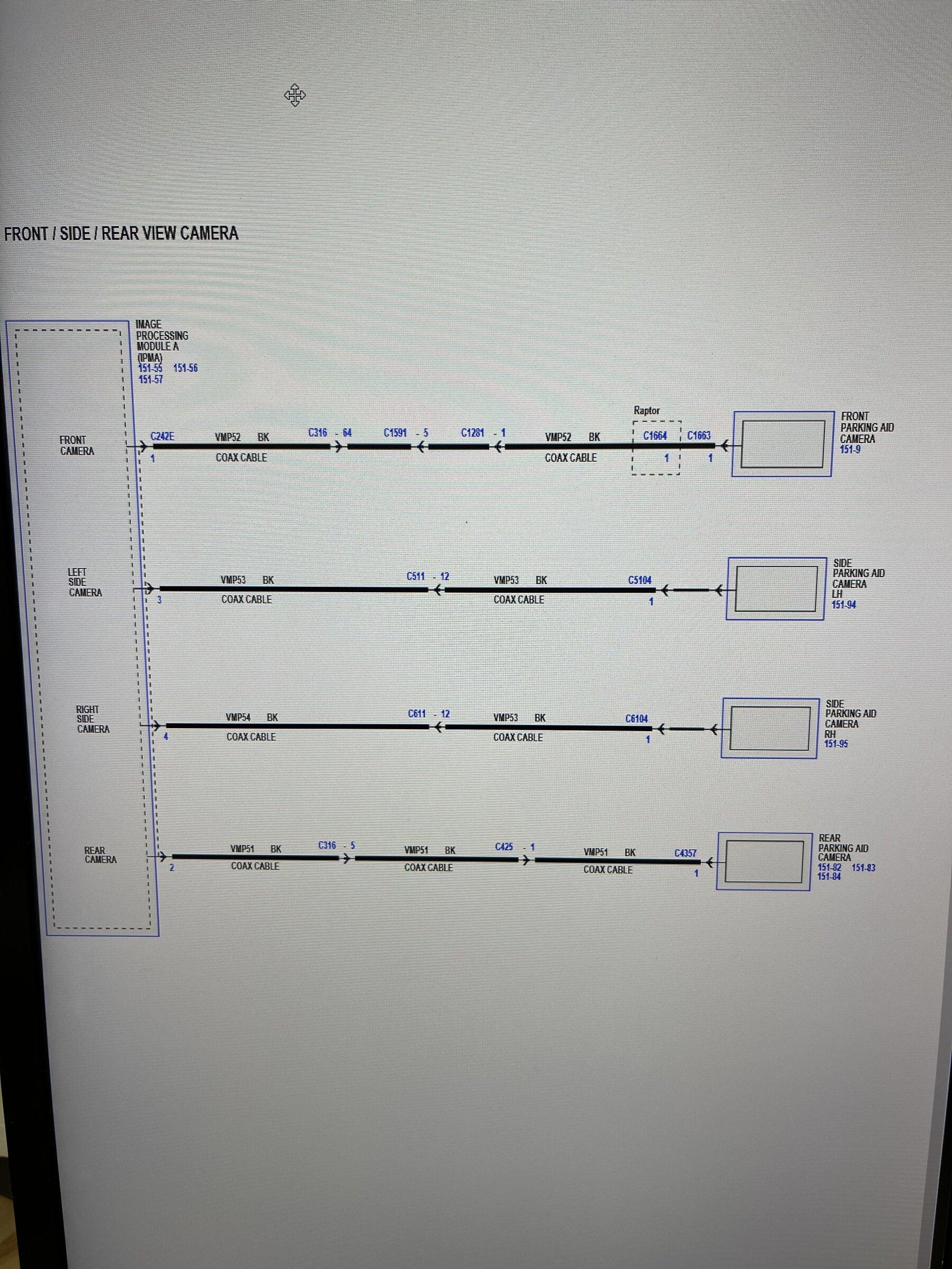

I don’t know if I can even do this. Here you go. This is direct from ford wiring. The ipma handles all cameras all sensors all radar all cruise.

From what I read the B handles analog cameras. As far as I know the only camera that is analog in 21 is cargo cam and still it goes to the ipma. I’ll try and see if I can get specifics on it but I haven’t encountered it. If someone else knows maybe they can chime in. I don’t know 100%. Even the STx like mine had a digital rear view camera. It was analog from the ipma but I was able to convert it to digital. The ipma is the same for rear view cam only trucks

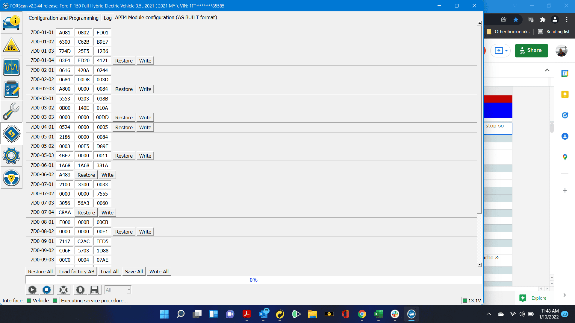

Here's some things to try:
IPMA 706-02-02 xxxB CExx xx--
APIM 7D0-01-01 xxxx xxxx Fx--
APIM 7D0-01-02 6xxx xxxx xx--
APIM 7D0-01-04 xxxx EDxx xx--
Do an APIM reset under the wrench icon after the APIM changes.
I did this and got hitch cam at speed but lost bed cam not selectable any more
any help would be great

I have mine all working. The only problem is you only get the hitch cam and the cargo cam in motion. The others are not selectable. You can also only switch through the cameras in motion with the camera hard button. If you initiate the cam in motion.. come to a stop and then use the soft button to select the front camera I believe then it will stay on.
I used the 21.5 trucks as a guide for the cam in motion. My entire set up is after the fact anyway.. I didn’t have 360 or 12” from the factory I added it all. Along with the cargo cam.
