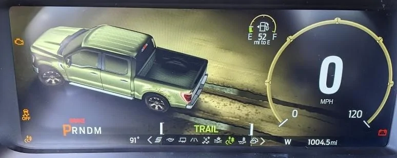

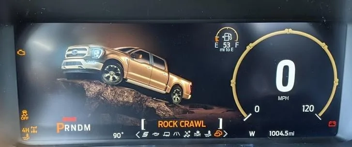

I installed a HDC (hill descent control) button into my non-FX4 4WD and have been chasing the values to get it fully functional but I did discover a few things this morning that are of interest...
ABS 760-04-01 xxxx xx8x xx-- adds Rock Crawl to Drive Modes
Ford F-150 Lightning 2021+ F-150 FORScan List / Database / Spreadsheet ? rock crawl
ABS 760-04-01 xxxx xxx8 xx-- Adds Trail to Drive Modes
Ford F-150 Lightning 2021+ F-150 FORScan List / Database / Spreadsheet ? Trail
Note: I briefly played around with the SDM_Generic_Modexx entries on the ABS spreadsheet to try and produce different modes using "F" as a quick way to enable multiple ones at same time but didn't see any additional drive modes appear on the cluster. Also, I didn't test Rock Crawl or Trail modes while driving so if anyone is inclined then do so at your own risk. I realize Rock Crawl is standard on FX4 trucks but I haven't tested that yet until I get my HDC button functional.
