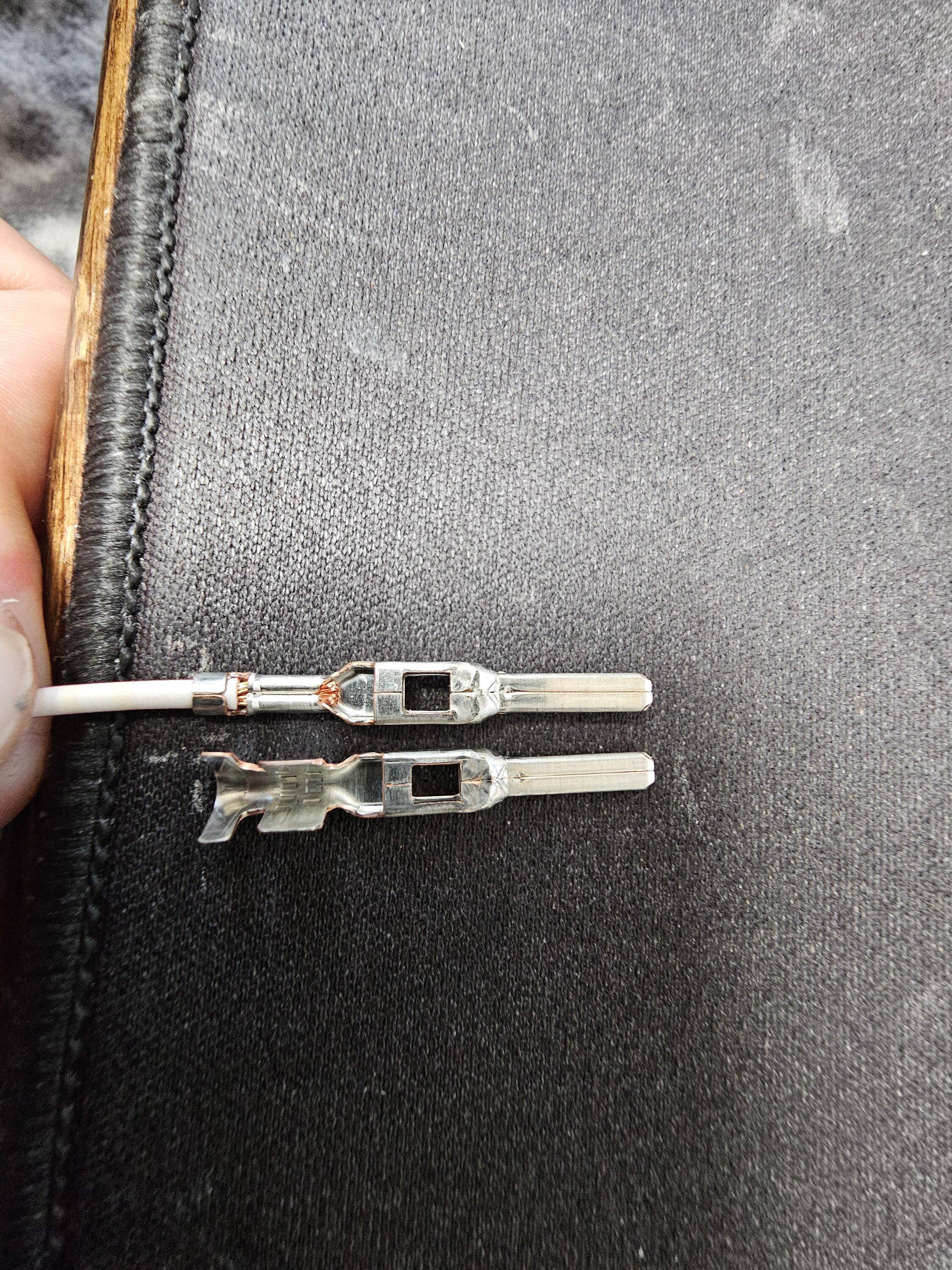

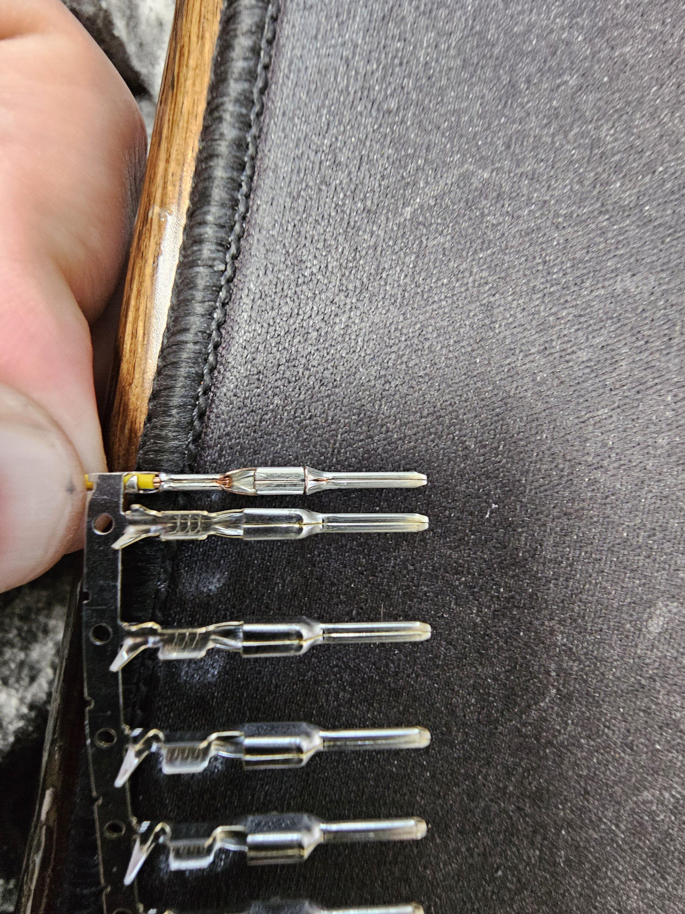

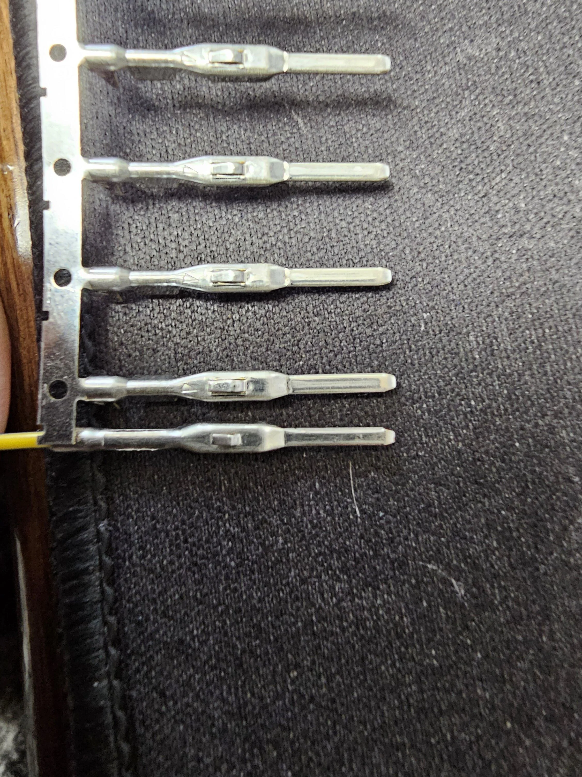

Small update got my parts from mouser in today,
Partum's for C311/C312 pins fort he center row the ones 2.8mm wide seem like a exact match same size and even same numbering stamped on left and right sides of the pins.

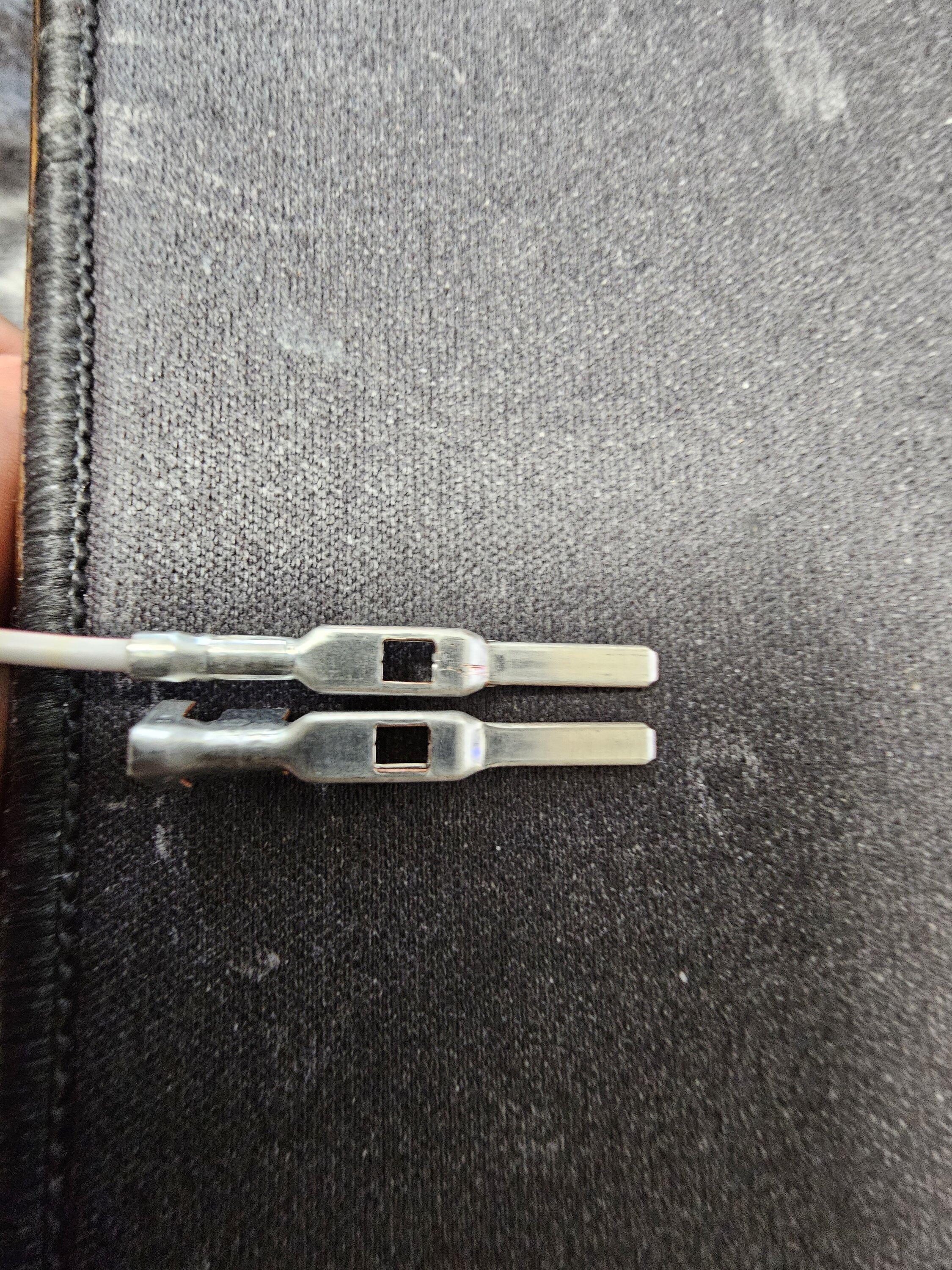

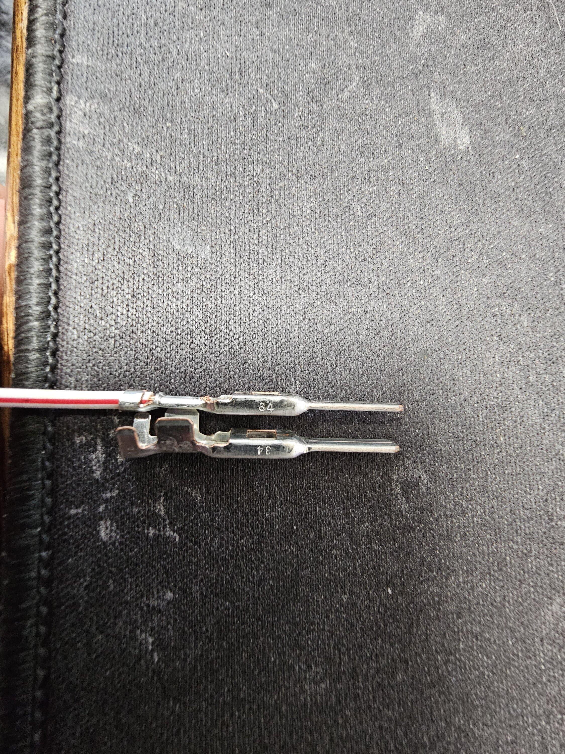

The partum's for the 1.5mm pins from C311/C312 I listed in the spreadsheet these don't quite seem a exact match, but think they are a case of different mfg but made to the same spec dimensionally the locking points seem the same. the blade is ever so slightly wider ill test it on the female side of the plug later but suspect these will work without issue and are quite economically priced.

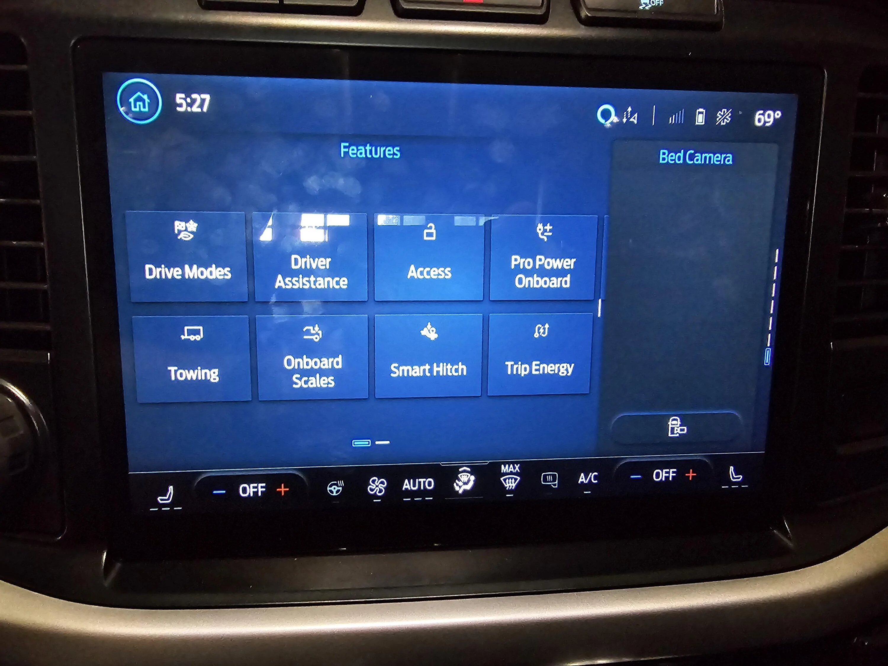

did some more work tonight and i have HSW working WWOOHOO
Ford F-150 Lightning 2022 Lightning Pro Seat Swap/Upgrade to Heated/Cooled 1694652941551
also what on screen controls look like with below settings changes how the main menu navigation works too no longer the bar on the bottom
So bear in mind this is still with the the pictured ICE HVAC unit (which cannot actually do heating or cooling) But i configured HVAC with stock PRO config via forscan, still need to ultimately try swapping back to stock hvac unit (or force re-flashing it) but keeping the ICE unit in there till i finish HC seat install.
then in APIM
7D0-02-01 xxxx 5xxx xx-- This relates to HSW
CFZ Dual Zone • SA Enabled • RC Not Available • HSW Available
7D0-02-02 xExx xxxx xx-- *optional for climate auto settings may want to check yours/lookup and choose what applies*
IODEVT Enabled • CAHSW Enabled • MD On • FDZDLB Dual Button
7D0-02-01 xxxx xAxx xx-- *you may not need this one think yours would be 2? unless you have HS*
HSHMI Heated and Cooled • MM Enabled • CCT Automatic
7D0-02-02 xxx6 xxxx xx-- *this is what reveals the climate bar*
PT MHT • CB Enabled
7D0-02-03 xxxx xxx1 xx-- *unreal sync theme this should be enabled by default on lighting*
DMD Auto • SST Smart Surface Truck
IPC
720-05-02 5xxx xx-- *this is for me going for HC seats for no heated sets but HSW its 1 but lookup/check based on your build
SCCM
724-01-01 xxxx 8xxx -- *enables HSW in the SCCM*
Enable
724-06-01 Bxxx xxx -- * HSW temp setting B is 35deg c if you want others look it up)
HSWLTSP 35°C
724-06-01 x4xx xxxx -- *OPTIONAL HSW timeout time for auto shut off 4 is 30 mins, i put it there default is 0 which is no auto shutoff can have up to a hour *
HVAC
Also for folks trying to enable HSW onscreen on lightning with stock HVAC modules you may need to
733-01-04xxxxxxxx*x--
change 4 to 6 in that cell
4 =CHW Continuous Heated Wiper is NOT permitted • HWMM Load Cycling is AVAILABLE for Maintenance • HSW Vehicle does NOT have a HSW
6 =CHW Continuous Heated Wiper is NOT permitted • HWMM Load Cycling is AVAILABLE for Maintenance • HSW Vehicle DOES have a HSW
Don't forget to go in and reset modules individually via wrench to be sure
