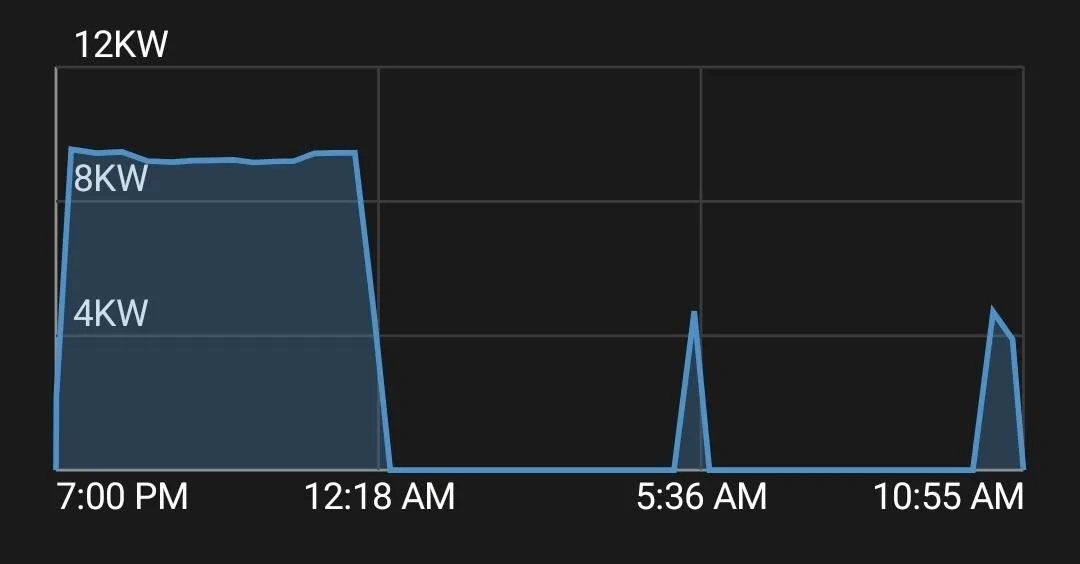

Here's what mine did Monday when it got down to 2F overnight.
The peaks at 5.30 and 11am is the truck warming up the battery.
Note that it doesn't warm it to 60F like it would if you "condition it" just enough to keep it above whatever threshold there is.

There is no charging going on here. Just conditioning and as you can see it is using 6.24 KW to heat up the battery.

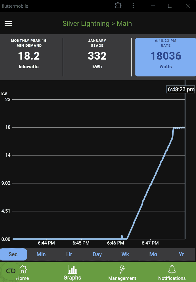

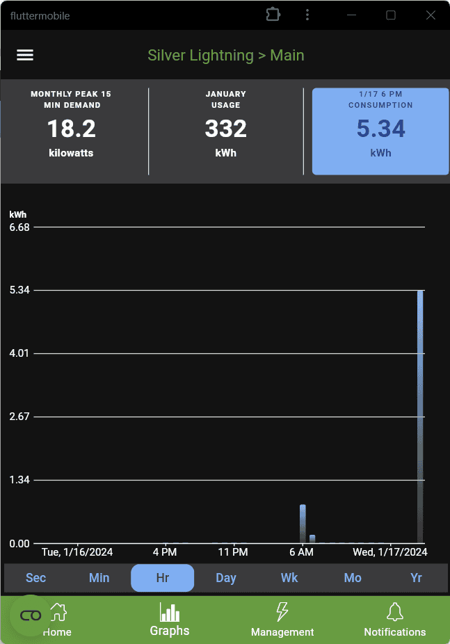

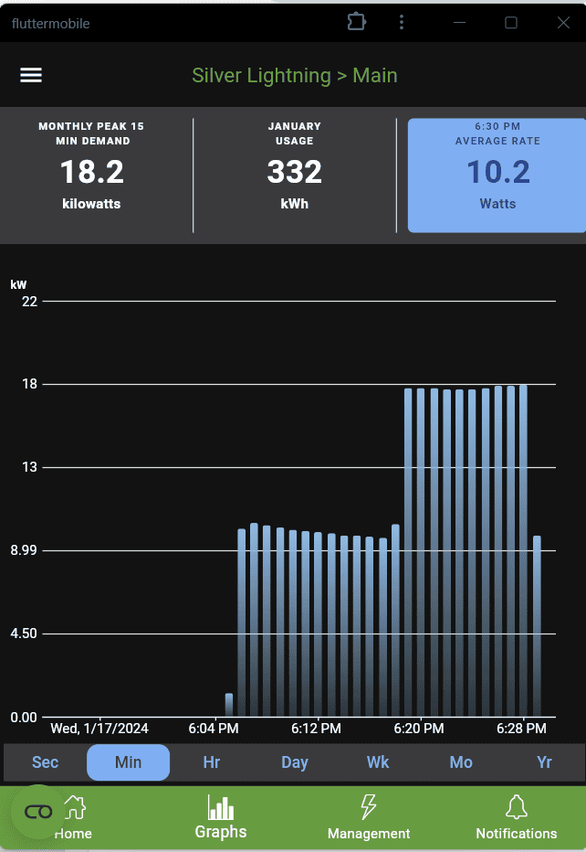

I'm doing a departure time event for leave at 1900 hrs, the truck decided it should begin the battery warming process autonomously (FP is down right now) I had programed this on the Sync 4a screen earlier this afternoon just prior to FP going down.
Chart on the right shows the energy flow by the minute, for 24 minutes the battery warming effort ran initially started around 9 KW, then bumped itself up to 18 KW, chart on the right shows a total of 5.34 KWH consumed over that 24 minutes. I had the cabin warming function OFF in the configuration so that we see exactly what went into battery warming, truck has been in mid 20's weather all day.

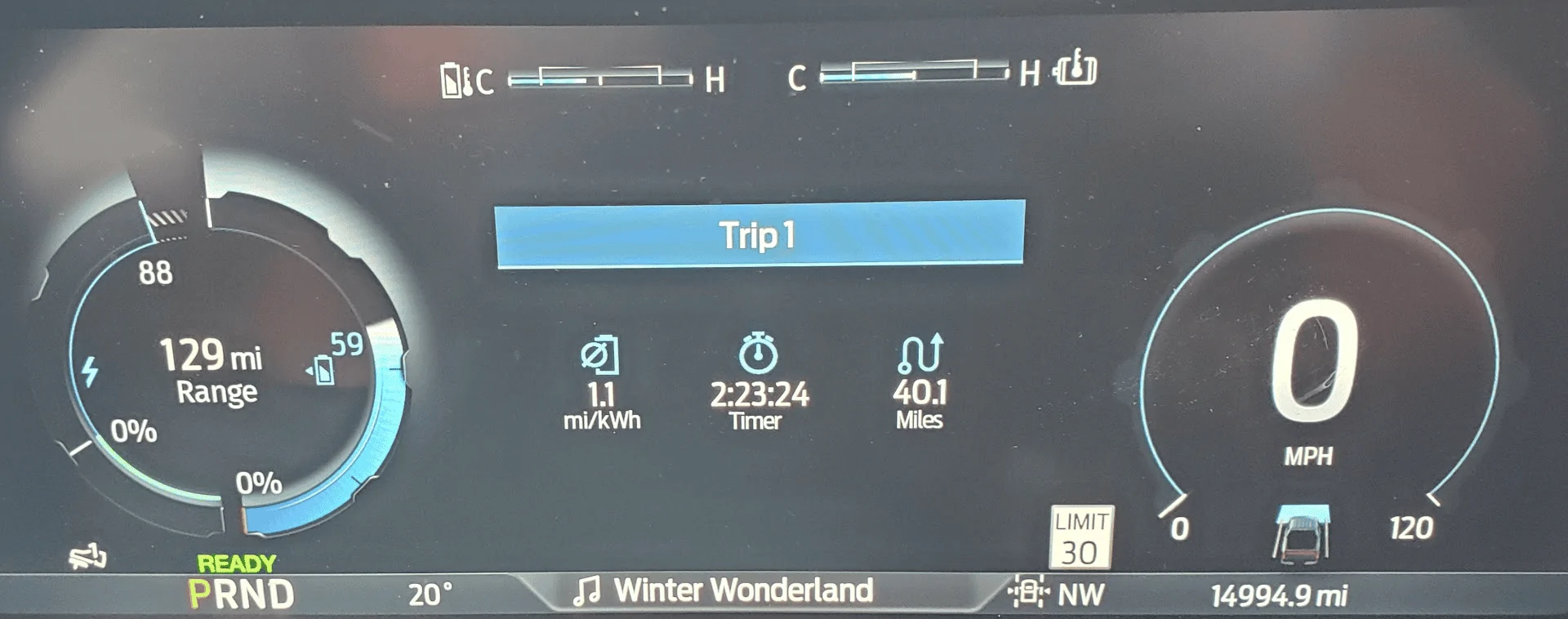

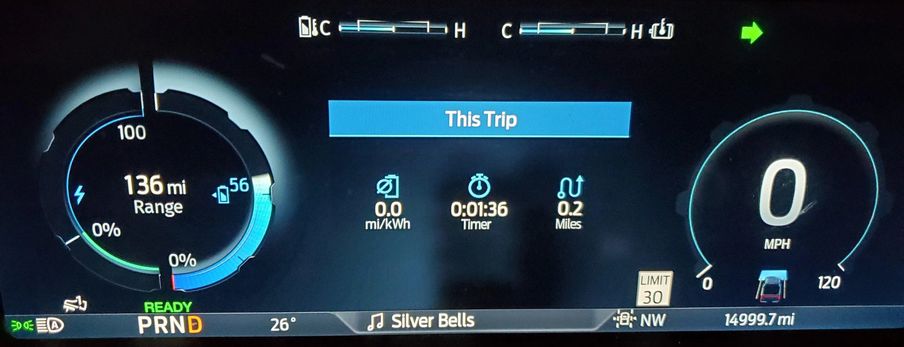

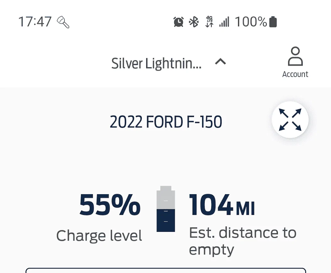

FOrdpass just came back online.
This is the before & after impact of 24 minutes of battery warming.
An extra 28 miles for 5.34 KWH

Wow, that is significant. How fast will that boost disappear as you drive?

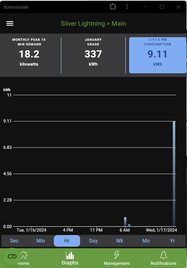

I deleted the preconditioning record. and now warming up the cabin with remote start @1846, started ramping up to 18 KW, then let it run for 15 minute cycle for a grand total of 9.11 KWH, 3.77 for the cabin heating.

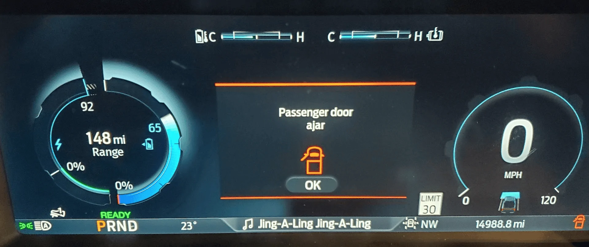

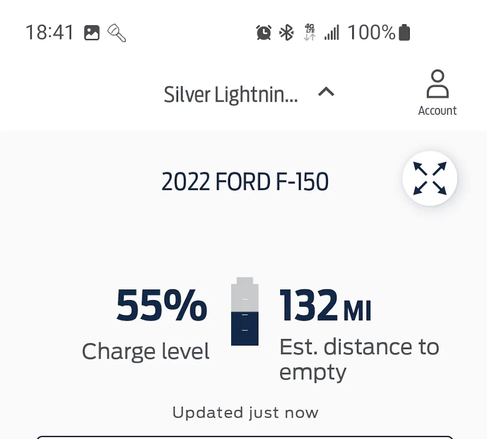

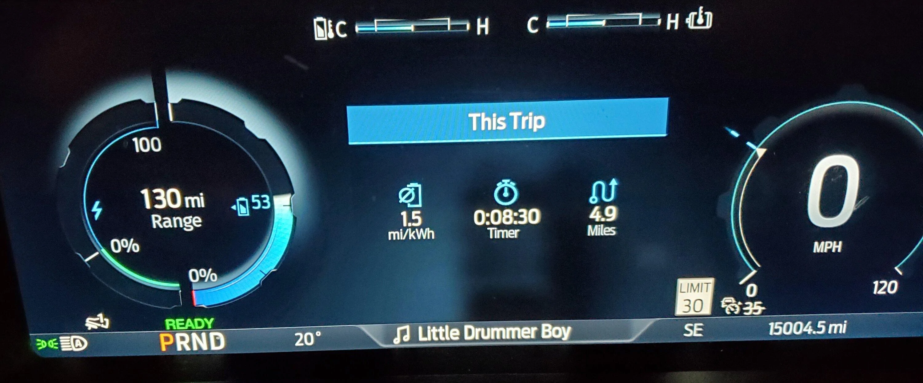

We will see, the precondition session also restored full available power. Short trip to coffee shop of 5 miles lowered available range from 136 to 130, highway speeds of 66 mph
