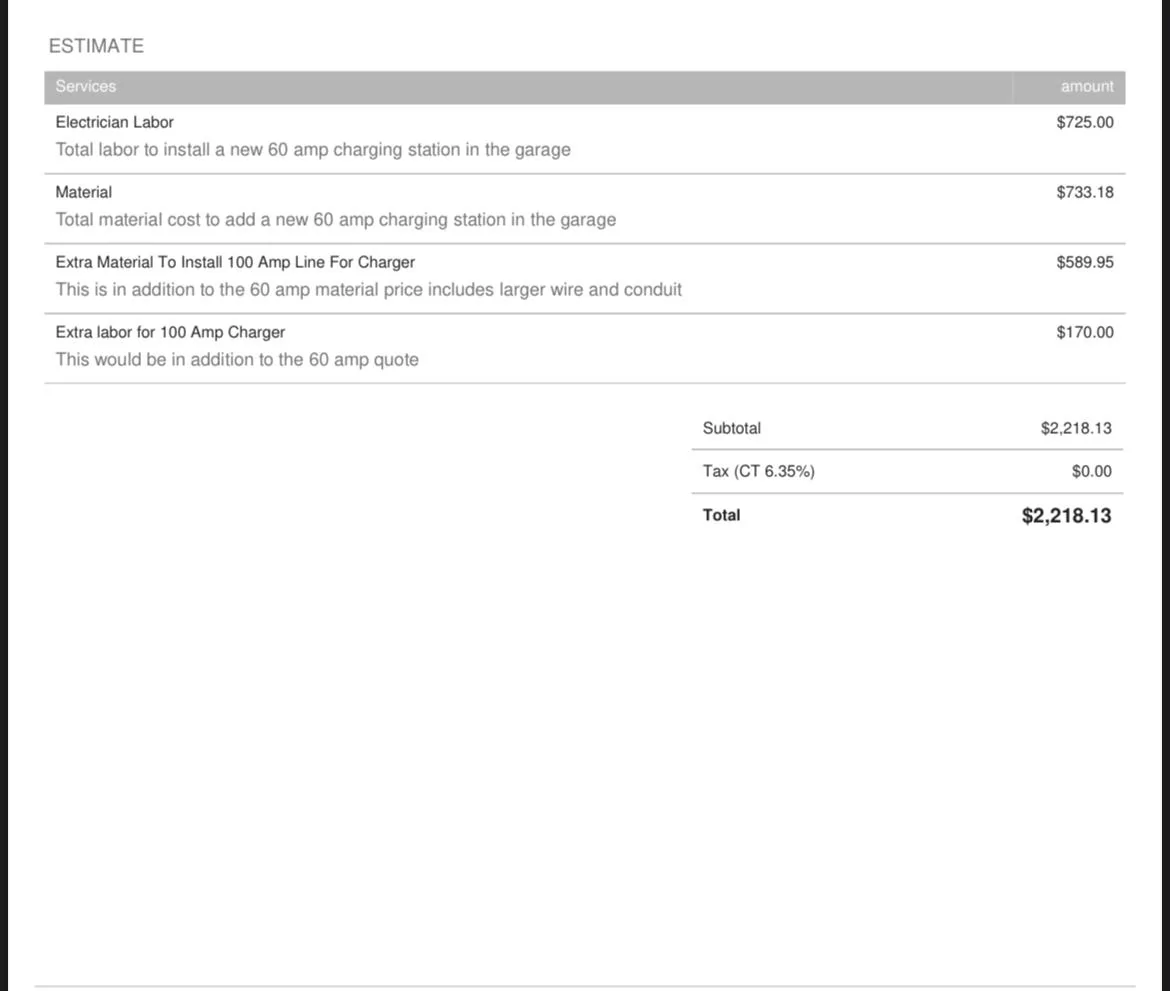

Haha I was thinking the same thing. That’s basically his ā€œI don’t want to do this job but if you pay me, I willā€
It probably is more difficult because of pulling that thicker wire, even just bending it in the box. Worth $170 not sure but harder for sure
