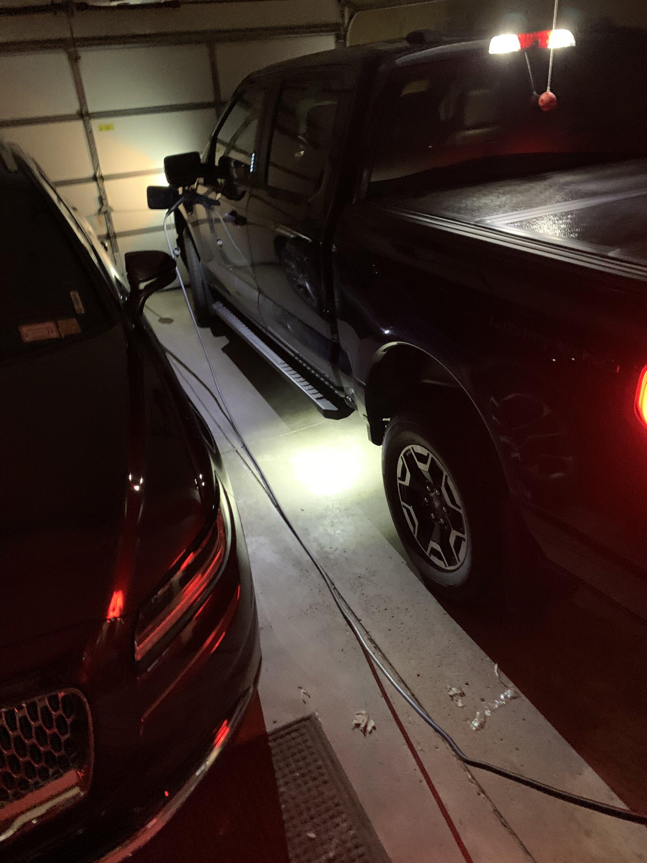

Could you post some pics of what the lights look like at night?? seems like an easy mod, and maybe some pics of the wiring and where the lights are mounted, etc Thanks!https://a.co/d/3U97VMX
I used these. They fit but are not weather proof so I used some silicone where the wire exits the plug. I cut the red connectors off and spliced, sealed and shrink tubed them. oh and gooped on di-electric grease in the plug
