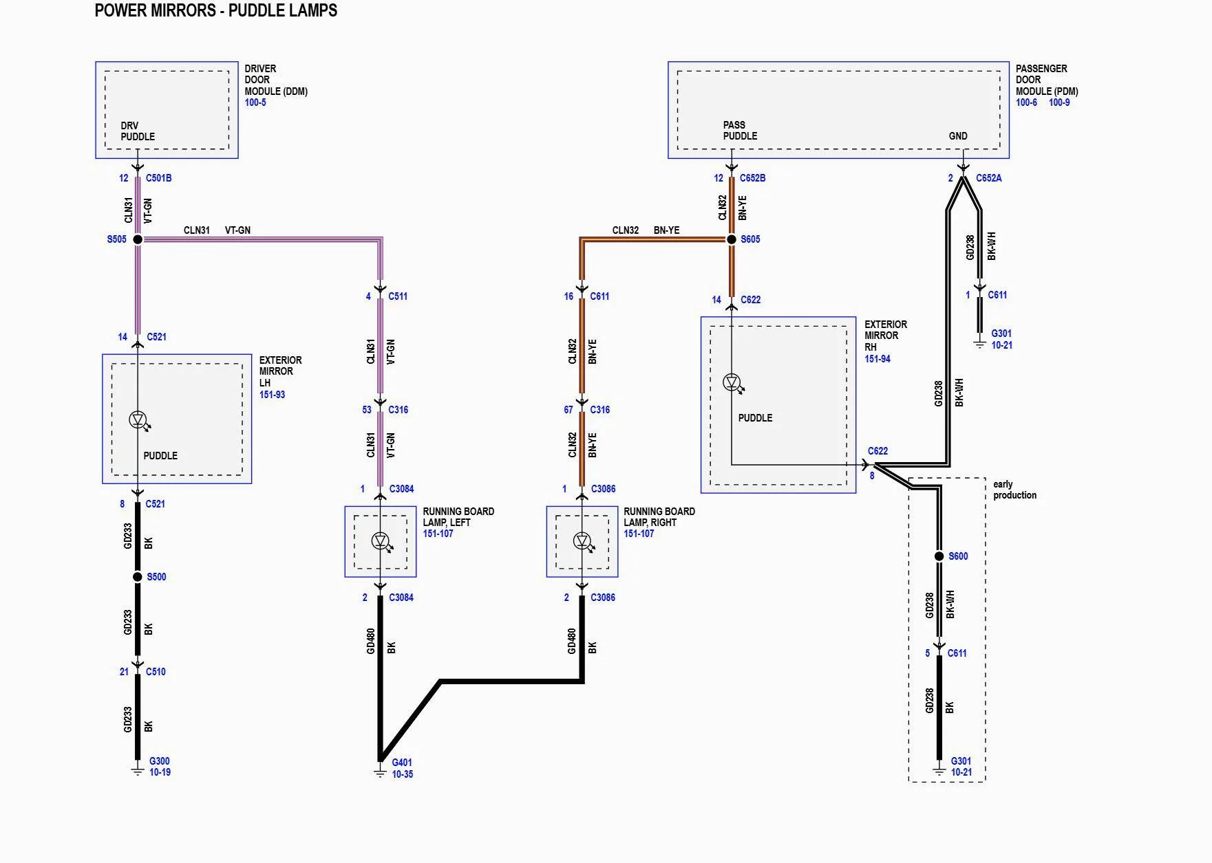

Here is the diagram

Thanks! Is the violet and green in the driver kick panel?
You would have to check. The issue will be these from factory are driven by the Door modules.
The puddle light circuit. SO not sure if Ford would prewire that or not. The lighted Steps seem to be a fairly rare option. C316 ia actually under the hood.. or I should say in the frunk area.
511 and 611 are the door connectors.
