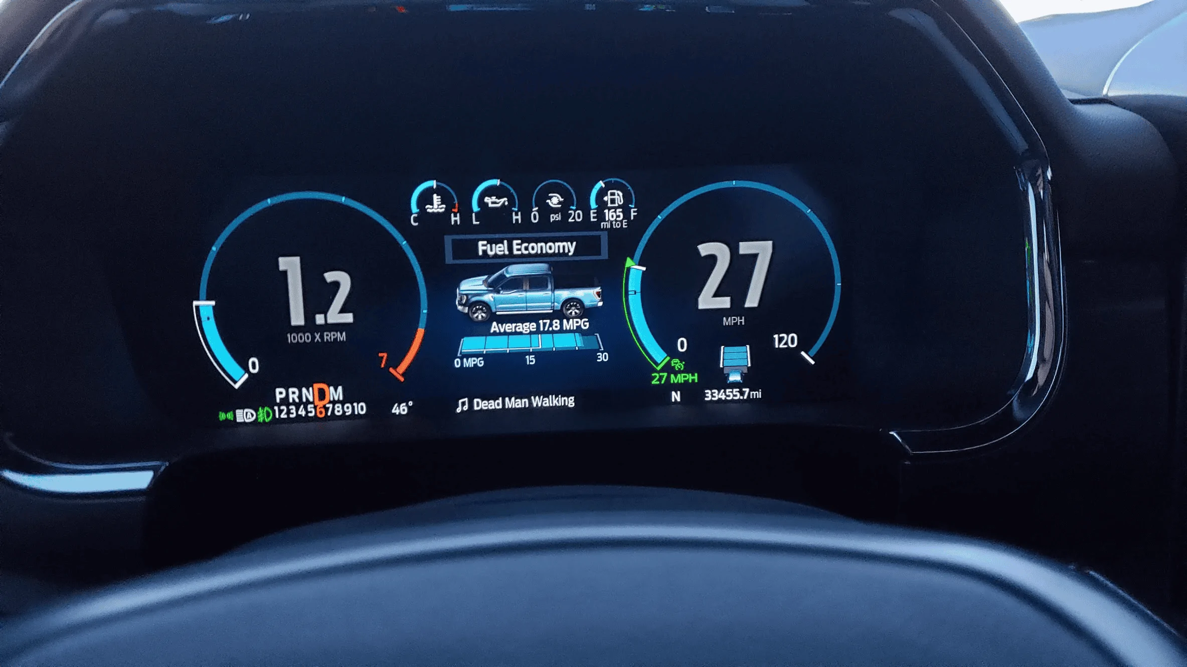

Big progress day! Finally had some time to play around with things and I have adaptive cruise now!
Leveled my CCM sensor as in the service manual. Then did the CCM calibration using Forscan which was very straight forward, just had to drive it down the road for a bit until it tells you its complete. Went and turned a few things on with Forscan to enable ACC and everything is working like it should so far! I haven't even installed my steering wheel switch for the distance change, and I might not at this point. It is currently at 3 of 4 bars on distance, and I'm 99% sure you can modify that with Forscan anyways if wanted. I'm going to see how it acts there then see what I want to do moving forward. I haven't even actually got to see it function yet a finding enough traffic in my small town on a Sunday night is easier said than done... but will see tomorrow when I get out and about.
Only draw back so far is no lane centering so far, so need to do some more playing around there. I'm 99% sure I have everything enabled for it to function but need to run through everything again and double check. However, like I suspected from the get go with this, I may need the advanced IPMA in order to make that work. Mainly because my driver assistance menus look much different than a truck that usually has everything. I even tried to enable intelligent cruise and things started freaking out again and not wanting to work, so all I have right now is normal and adaptive cruise. @Jesse-Infotainment any pointers would be awesome, but I think next is to try to swap in my advanced IPMA, get it all configured, and see what happens then. Luckily so far I think we've figured out you can add ACC very easily with these trucks with pretty much just the front CCM and wiring to get it all hooked up!

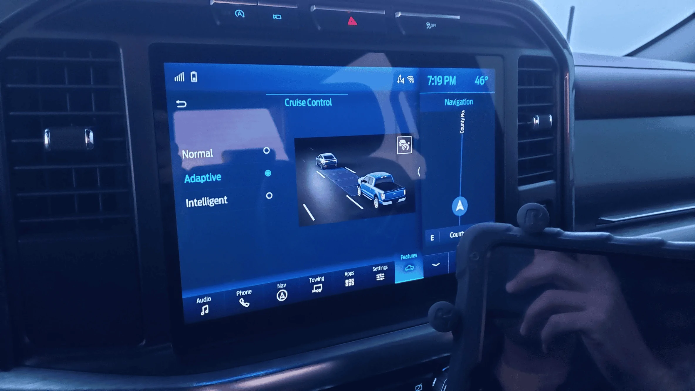

Currant distance setting when you enable cruise
Ford F-150 Lightning Adding Co-Pilot Assist 2.0 with Forscan? 1649039971152
My cruise control menu, much different from what I've seen in other trucks. If I enable Intelligent, I do get the tolerance setting, but it also looks much different from what I've seen elsewhere.

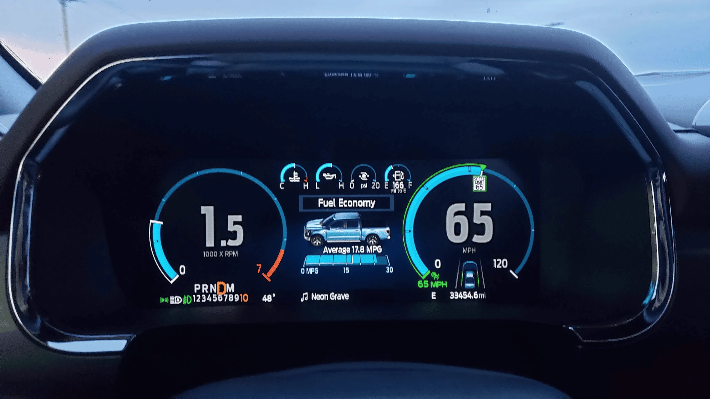

Quick update. Ran ACC quite a bit today and worked flassely the whole time. The 3/4 distance is just about right for me and don't think I need to change it, but probably will try to play around with it just to make sure it can be changed in Forscan if people don't feel like adding the steering wheel controls. The only bad thing is now I want everything else... intelligent cruise, lance centering, and maybe even Blue Cruise down the road ha ?

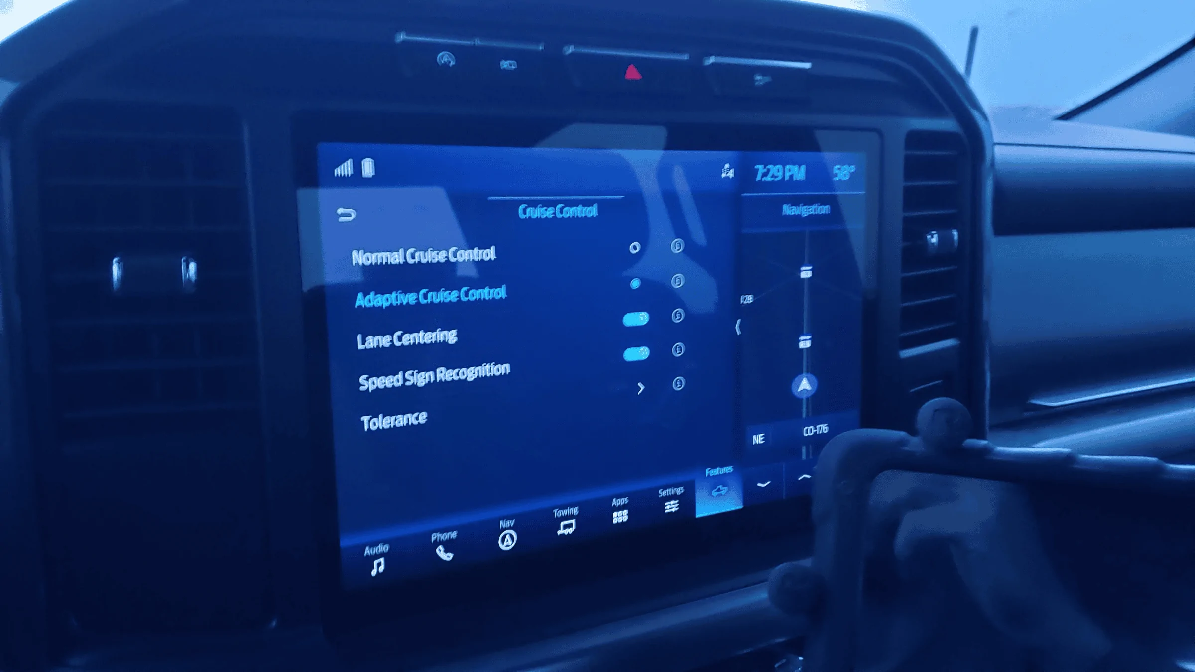

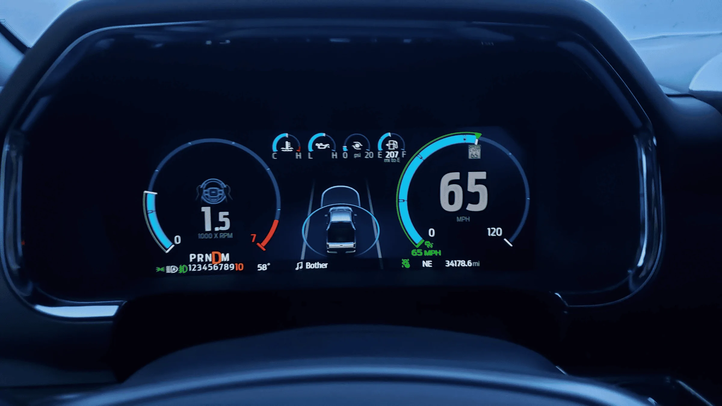

More progress this evening! Finally got to playing around with things more and now have lane centering working!
I was about to throw in the towel and ask @Jesse-Infotainment for some pointers, but I kept at it and comparing options that needed to be enabled and finally got the right combination. With that, holy crap a bunch of lines need changed across the IPMA, APIM, IPC, ABS, & BCM to make everything talk right. I still don't have speed sign recognition working 100% for some reason, it's on and enabled, just not reading any signs, but must be missing another line someplace so that will be the next hurdle. I currently have my donor advanced IPMA jerry rigged up for the time being, just to make sure I could make it all work the one it's designed to work with, before I try it on the basic module.
Next on the to do list, is to try and copy my config from the advanced to my basic IPMA and see if everything still works the same. So fingers crossed there, as Ford go cute and moved the rear camera input to the additional 2nd connector on the advanced IPMA, so I currently have no rear camera...
Ford F-150 Lightning Adding Co-Pilot Assist 2.0 with Forscan? 1649734944882
Ford F-150 Lightning Adding Co-Pilot Assist 2.0 with Forscan? 1649734962926
Great job! There are a ton of changes... Not sure if you made the change in the BCM..
The ipc you need to make a change for the speed sign recognition. I think in 05-01 the first bit
