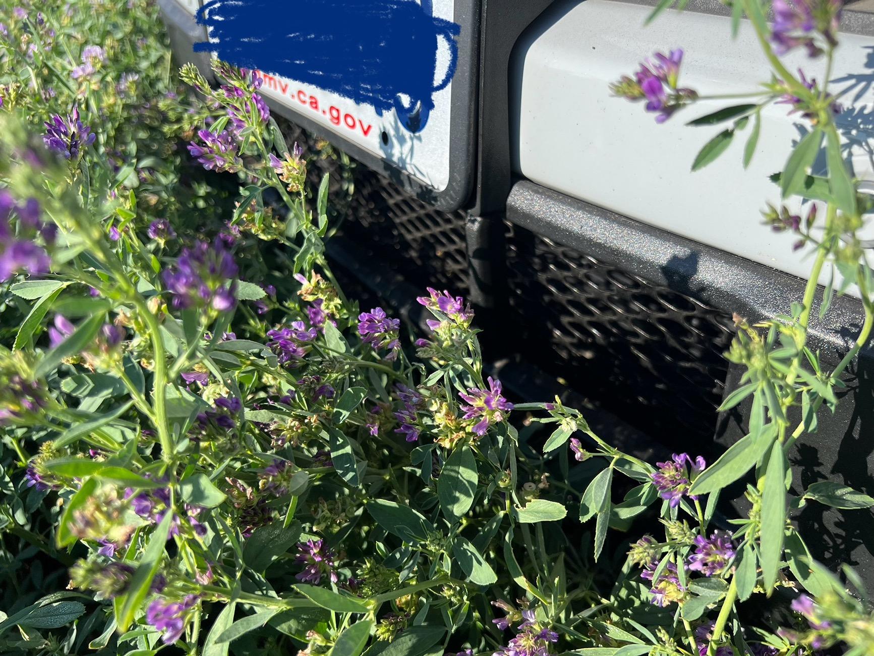

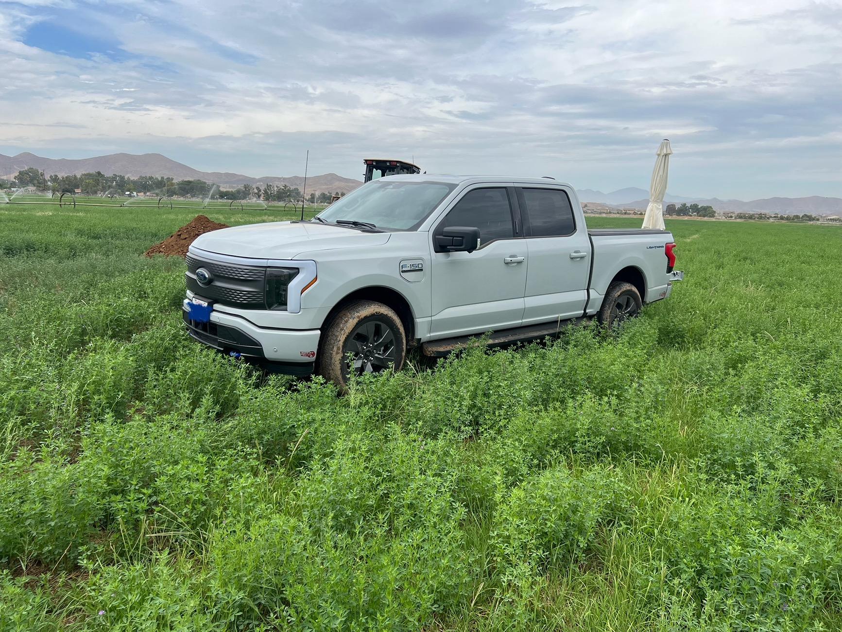

Maybe an extreme case but a recent job I was contracted on had me driving around an alfalfa field that was about 2 feet high in places. I added the custom car grills mesh grill as an effort to keep junk out of the radiator. Sadly it was not 100% effective despite me going as slow as possible. Afterwards I had to cut the zip ties off and vacuum out a handful of flowers, leaves, etc…. No matter I’m sure it did help and cut down 50-75% on debris getting in there. I just wish ford made it easier to access to clean out, especially around the edges.
Ford F-150 Lightning Adding grill mesh ahead of active shutters in bumper? IMG_6670
Ford F-150 Lightning Adding grill mesh ahead of active shutters in bumper? IMG_6712
Ford F-150 Lightning Adding grill mesh ahead of active shutters in bumper? IMG_6671

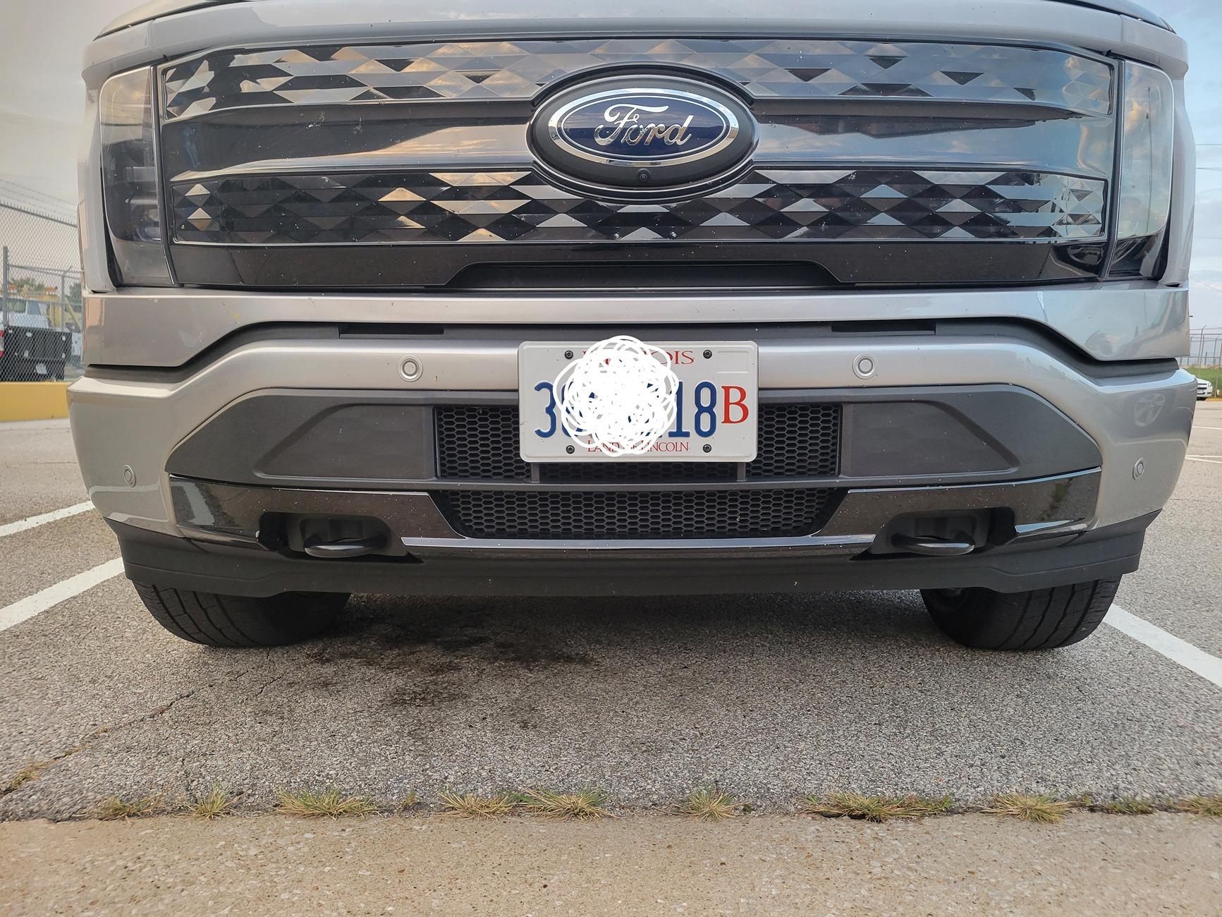

Radiator Grill guard and a Snap Plate . Works just fine.
Ford F-150 Lightning Adding grill mesh ahead of active shutters in bumper? 20240820_193442
