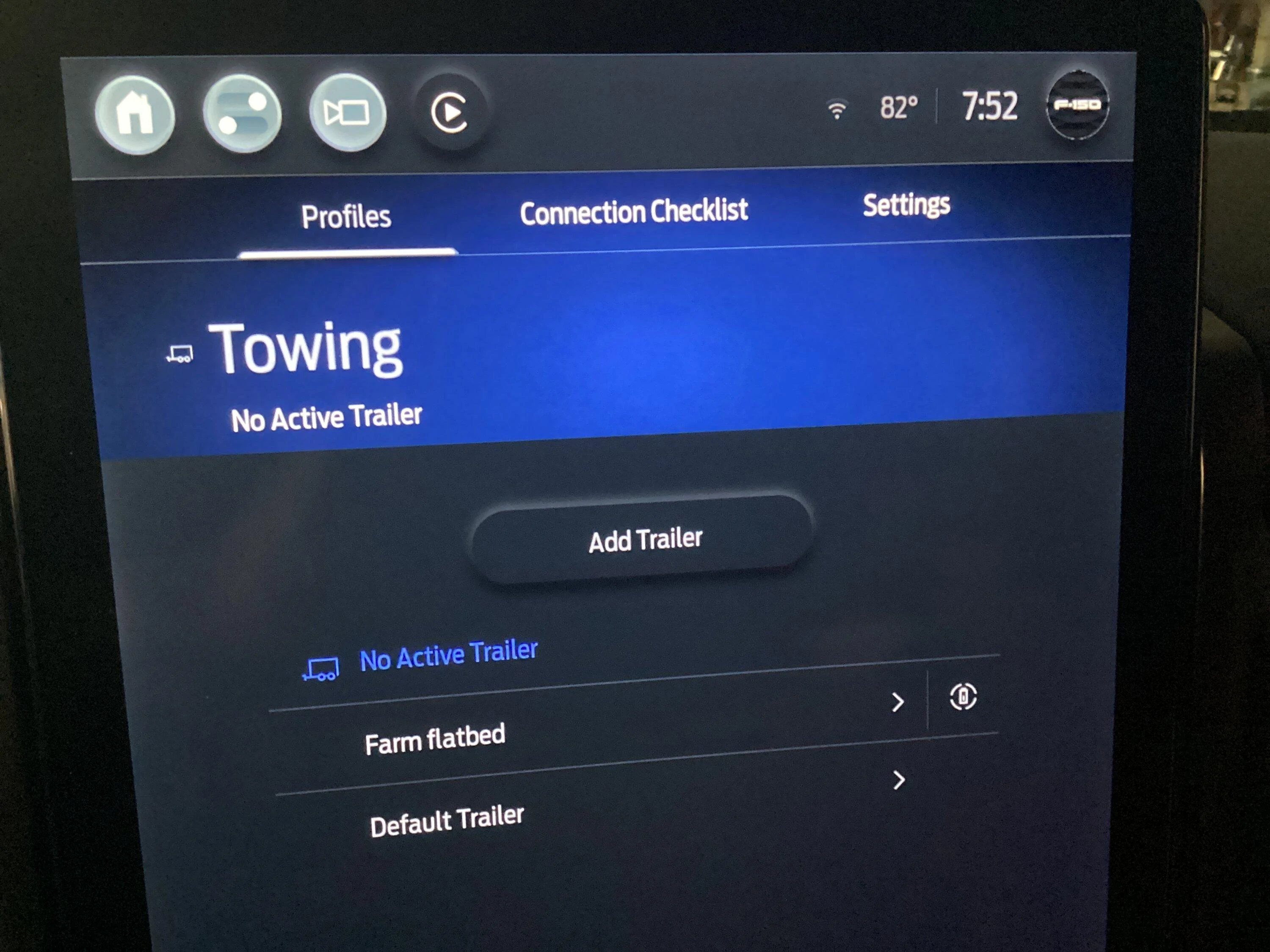

I did the update and now my GOM thinks I am towing a trailer. At 80%, the graph shows 80%. I have the ER battery. The GOM shows about 150 after declaring it is adjusting because of a trailer. I don’t even have a draw bar in the truck’s receiver.

Did you pull up the towing app and tell it you don’t have a trailer? That may “unconfuse” it.

No - what trim level do you have? I keep forgetting not everyone has the Sync 4A system.

Maquis, I just did what you said, and all is well. Thank You.
And Taxman Hog, no I have never had a lighted plug in my hitch receiver. your suggestion is appreciated, and if I did have one, that could be the answer. I can tell you though that the other day I was moving a trailer around, using the backup assist feature. I probably wouldn’t have bothered to plug in the lights but the backup assist worked.
