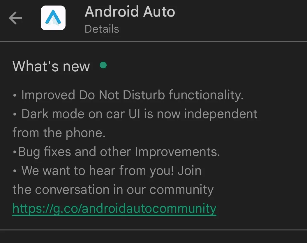

Side note: Android Auto update released tonight
