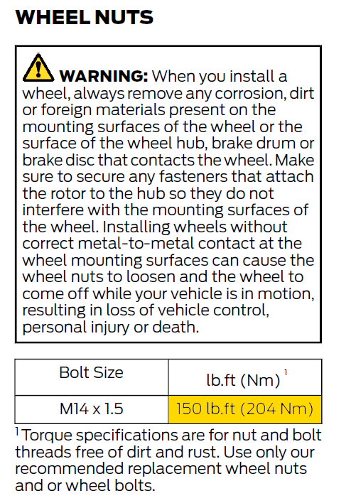

The truck is completely silent now. Maybe once or twice I heard some small noise just before the truck completely stopped while coming to a stop at a traffic light but other than that it was totally quiet. No more clicks or pings at every "torque reversal" as the TSB says....I'm going to go out with the torque wrench this morning and check the lug nuts.....(as you do) ;) ...trust but verify.
Ford F-150 Lightning Anybody else notice the slight "Click" when starting off either in forward or reverse? Lightning_lugnut_torque
