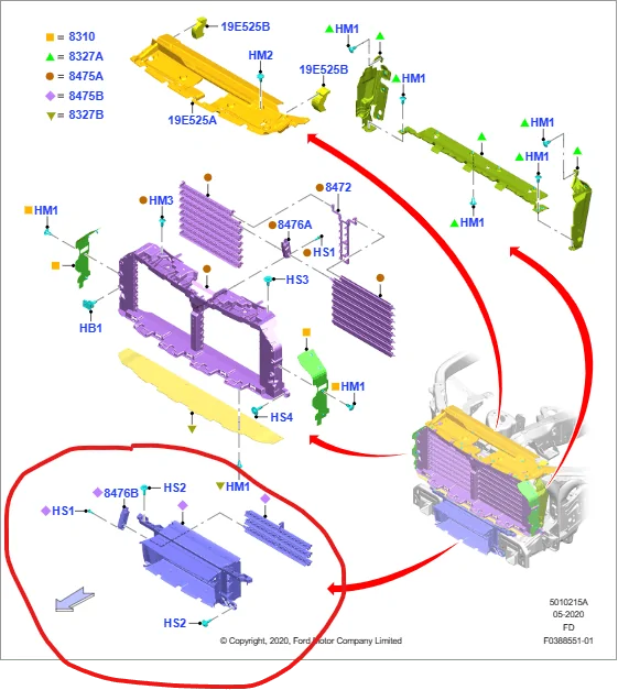

Looking at the shutter system, its definately possible that those shutters get stuck open and then start to vibrate at higher speeds or maybe one or two fans get stuck open. Not sure why it would happen... Seems like that is what has caused noise and vibration in the other threads though
I can check this out too but the sound so far has lined up so perfectly with when the damn deploys (and how it deploys)... and the fact I removed the deployable part of the damn and the sound stopped all together.
Doesn't mean it's not these per say as it is either the damn itself or where it is redirecting air when deployed that is causing the sound. If it's redirecting air here and it's not functioning correctly then it could indeed be here.

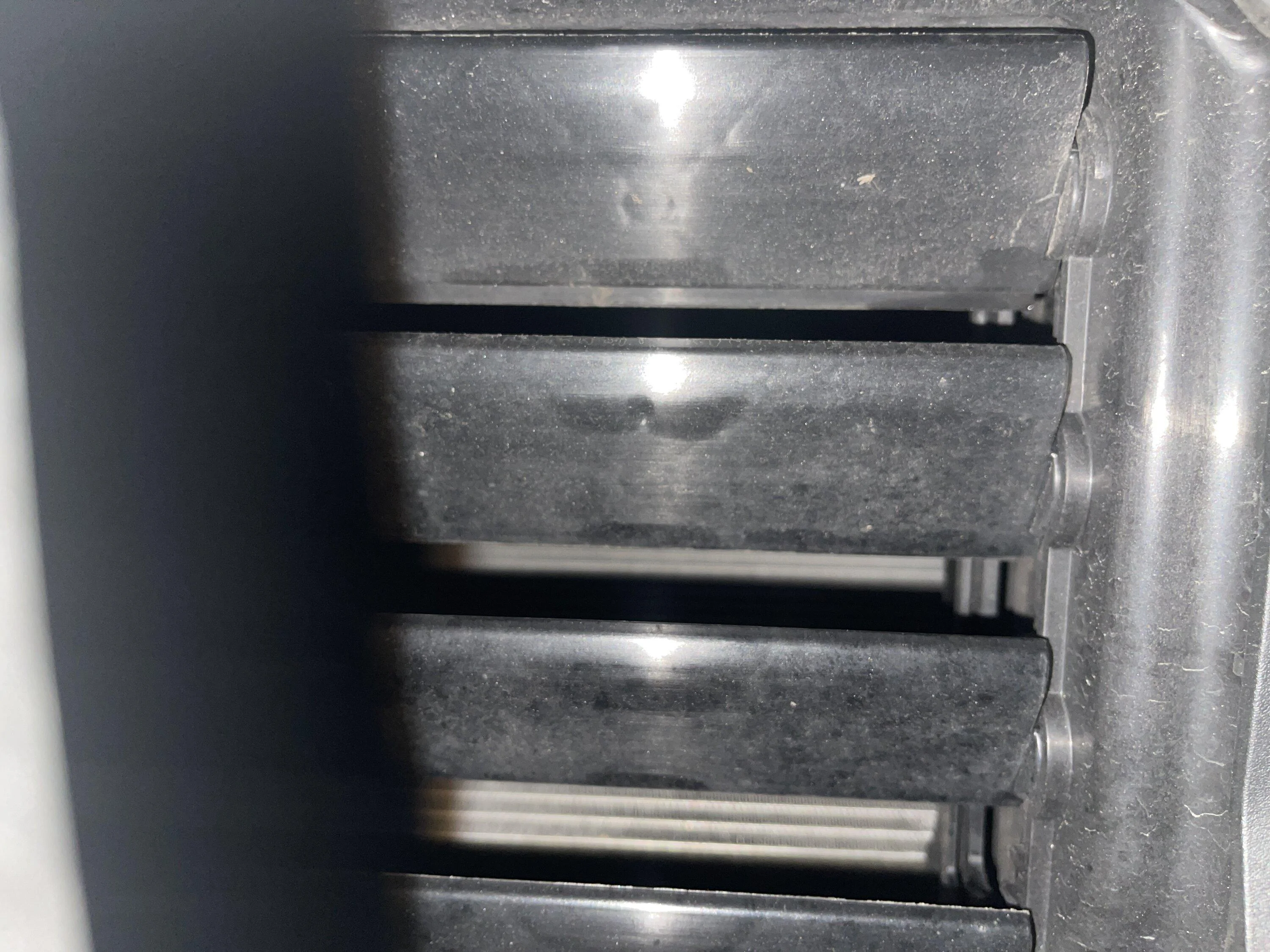

Oh and for the record - the grill shutters are always open as far as I can tell. I did the remote start thing where you can watch them open and close. In my case they close and then open and stay open. No idea of that is normal.. but they seem to be closing and opening fine.
From what I understood, the shutters close when the truck hits 50 mph or so for more than 5 seconds. This is because it is intended not to cool the batteries too much when the truck is moving at high speeds and/or to reduce airflow to the temperature control system. I think there was a link to a video somewhere describing this process last year somewhere.
If you look at this picture as well, there appears to be an air filter of sorts behind those shutters. If that's the case, the sound I get seems to sound like something I used to get with another vehicle where the air filter is loose-ish and the filter vibrates in the holder. Perhaps that is what is happening? I might suggest you point that camera at those shutters and try the speed test again.
Good info, thanks. I'm trying to find enough metal bumper to mount the cam to while it can see in, to do just this. No Luck yet lol. I posted the sound it makes in the cabin up above if interested.
