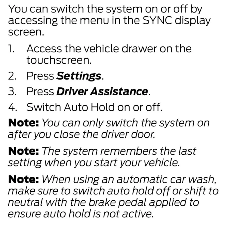

Do you have autohold turned on?
Rick I know this is old thread but where is AutoHold option? I know my system is outdated but so is this thread 😜
90
5,813
7,825
Rick I know this is old thread but where is Autolock option? I know my system is outdated but so is this thread 😜
As Maquis said.
Also, "Autolock" and "Autohold" are both features and TOTALLY DIFFERENT.
