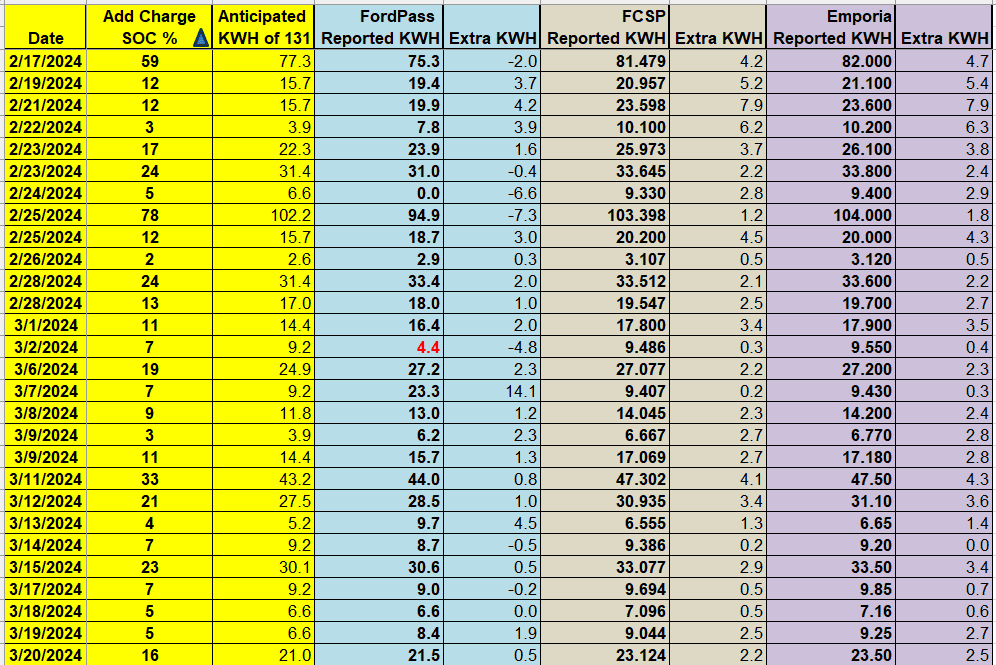

Recently I had a charging session that showed that I added 40 kWh raising the SOC from 85% to 90%, that 40 kWH was clearly bogus, your shot is closer to reality though still optimistic 112/44.4 @ 2.52 MPK.
I've been tracking the Fordpass reported session kWh, with the FCSP records and my Emporia Vue2 energy monitor which exclusively tracks the 240vx80a feeds, comparing these measurements against the anticipated energy based on the delta of displayed SOC.
Awesome tracking. Do you always charge at the full 80 amps? Just curious if you see a difference in efficiency if you charge faster or slower.
If you have this in a spreadsheet, you can work out the efficiency (probably Fordpass KWH/FCSP KWH would give a pretty accurate efficiency).
I'm guessing you don't use Departure Times? That might affect efficiency pretty dramatically on cold days in Mass. A spot check suggests not since you are running around 91% on the few I checked.

These data points are all at the 80 amp setting, the FCSP control app is so unpredictable with making amperage changes I hesitate to fool around, I could pull the cover and dial in but that's a PIA.

I wouldn't worry about pulling the cover. I'm testing this weekend at 48 amps and will compare what I get at 32 amps and what you get at 80 amps. I suspect they will be pretty close to your 91% give or take a percent.
