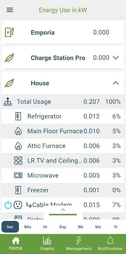

Yes. I have one on my main and one on my FCSP.
And when you set it up you can input your billing schedule and it will give you a total used for the month.

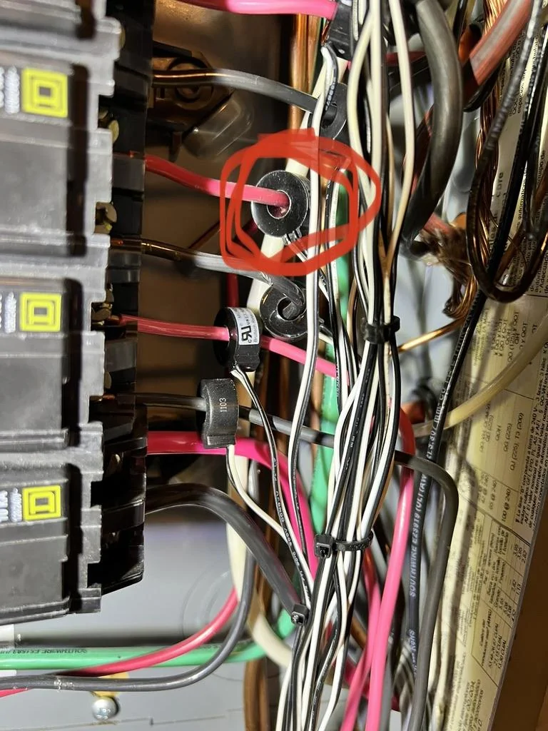

The data is accurate on the Emporia charger. It measures what is being used, not just what is being delivered to the vehicle. But we only use it on the wife's Mach-E. That is why I bought a main unit to monitor the FCSP. I found that the 50A sensor leads would only measure accurately up to about 63 amps. I currently derate my FCSP down to about 54 amps but wanted the ability to track it if I decided to use it at full power.

In my photo the mains loops are being used exclusively on the FCSP feeds which is OK for my needs where I'm not concerned about the smaller 15 & 20 amp circuits.

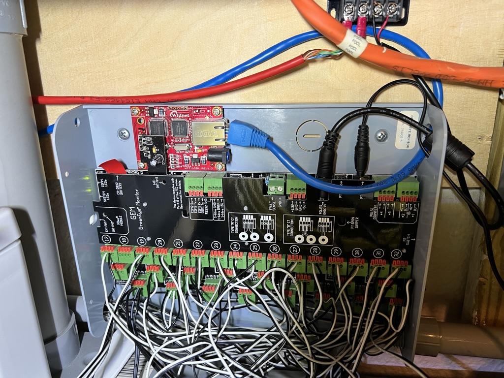

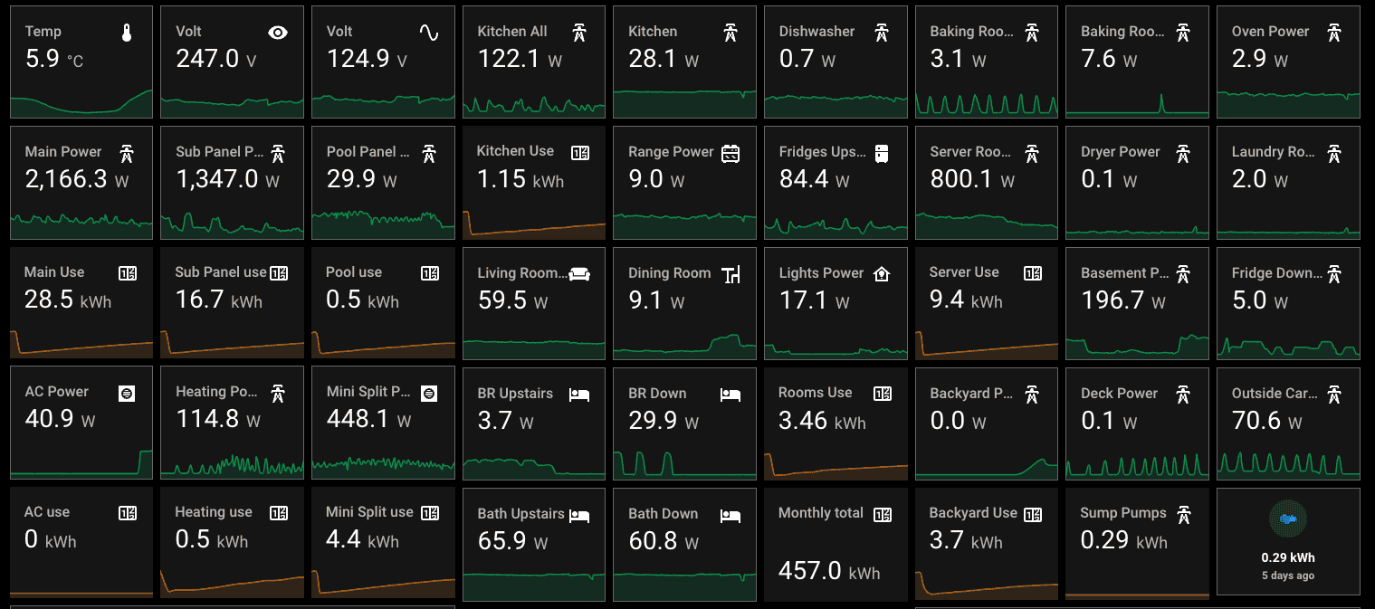

I use a Brultech Greeneye Monitor to monitor my circuits. It also allows me to track daily/monthly usage on individual circuits... Next will be to add the Wall Charger. I do plan to control charging current to even out usage and reduce charge current in case other high usage devices are running (e.g. dryer, ac, pool). This is mostly to even out power consumption throughout the day.

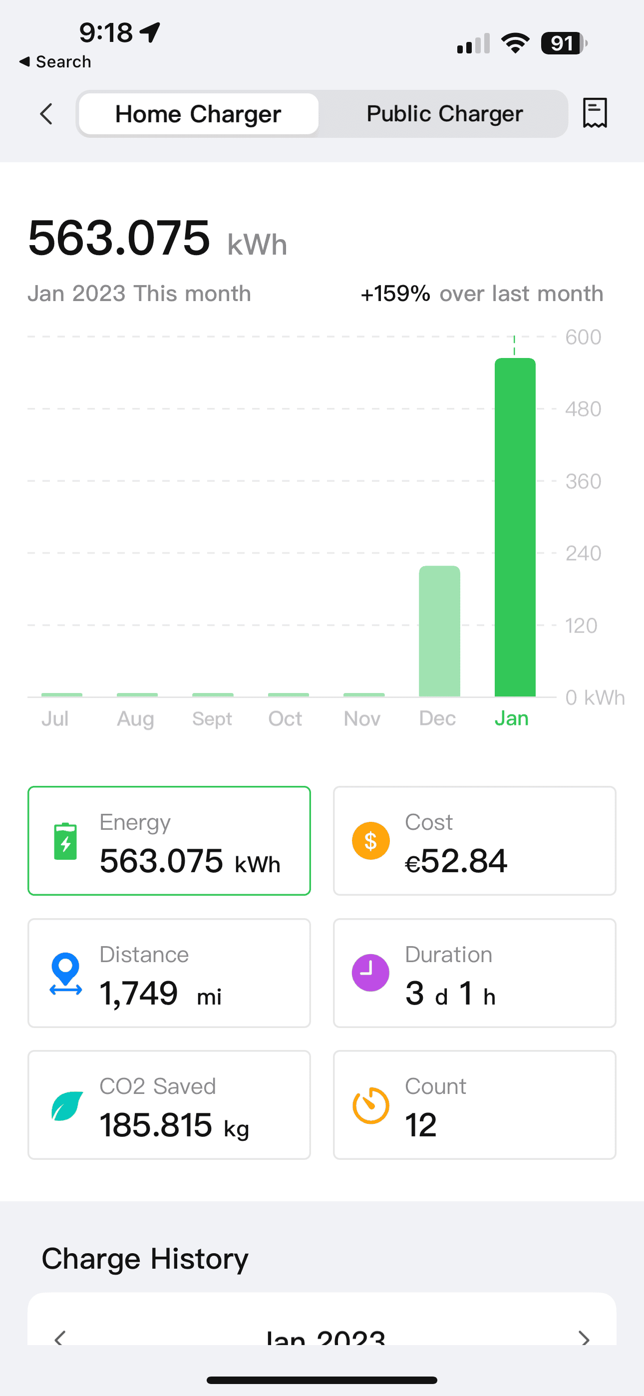

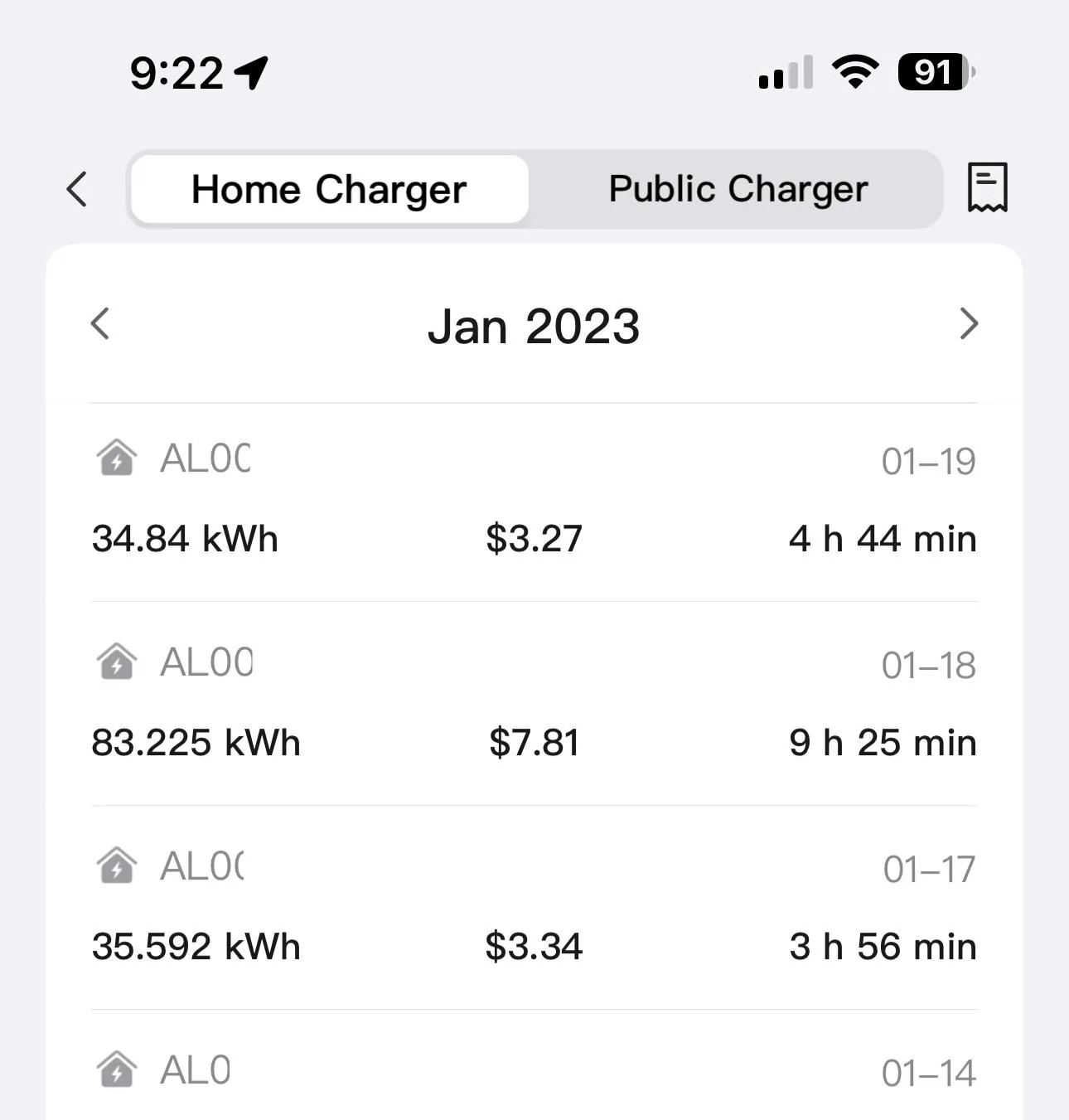

I purchased a non smart charger just want a way to calculate KW usage to calculate monthly use/cost. Not sure If anyone is savvy with Excel. Not even sure which way would be best to calculate this.... IDK ?
I have an Autel 40 AMP maxi charger and Duke Energy charges me .09/kwh. The app shows graphs per month and you can export raw data to excel:
